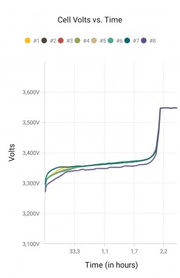

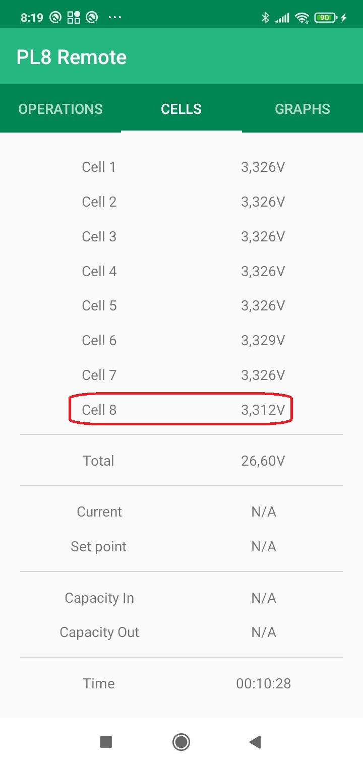

Postby snaker » 25 Feb 2021, 02:45

Postby expresso » 25 Feb 2021, 03:01
i noticed on my new pack - i have one cell when charging - to balance it - takes longer than the rest - its better when used daily etc,
so i would figure thats the weaker cell - but during the discharge - its actually better than the rest - its not the first to hit 2.5v - its the last really -
seems strange to me - i though that would have been the first instead of last - either way i have tons of Ah - it will never hit below 3v in a days time - maybe 3.1V - from the the discharge - it was good down to 22v total pack volt -

Postby shirley_hkg » 26 Feb 2021, 14:42
WD-40 has various product lines.
It's the weak cells to reach the top first .
Your cells are still in the nominal discharge platform, so should be of the same volt.
That cell 8 need to lay eye on it.
Suggest to perform a thorough discharge to find out .
Posts: 4653
Postby snaker » 27 Feb 2021, 02:26
That cell #8 is always lower when charging/discharging/monitoring.
I will clean the D-Sub connectors, hope that would help.
Posts: 1258

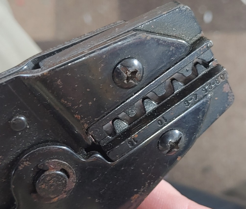

Postby ICEUK » 24 Mar 2021, 09:21
Best way to crimp /soler crimps?
Put some solder in connect then crimp andthen heat connector so solder comes out of. The luttle hole on connector
Solder wire then crimp then heat terminal?
Any other ways? Whats your preferred method
ICEUK
Posts: 580
Joined: 27 Apr 2013, 11:51
Postby Burgerman » 24 Mar 2021, 09:57
Crimping with a little solder means less hands and easier, But you can just heat and feed solderat the end. Use some flux.
Posts: 71037
Postby ICEUK » 24 Mar 2021, 11:38

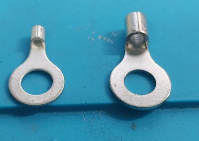

Postby ICEUK » 01 Apr 2021, 10:57
So these are the two ring twrminals I want to use, both are M6 holes one is 10awg for a 10awg wire and the other is 18awg for a 22awg wire.
I intend to crimp and then solder wire, do my crimps look ok? If not can you suggest a good pair of crimps for me.
ICEUK
Posts: 580
Postby Burgerman » 01 Apr 2021, 12:49
If you plan to solder the small ones any crimp will do. You dont even need to crimp those. I dont bother - just solder and heat shrink.
Posts: 71037
Postby shirley_hkg » 02 Apr 2021, 02:01
Fold the wires to make it thicker to fill up the barrel. Then crimp and solder. Add extra wires will also do .
Posts: 4653
