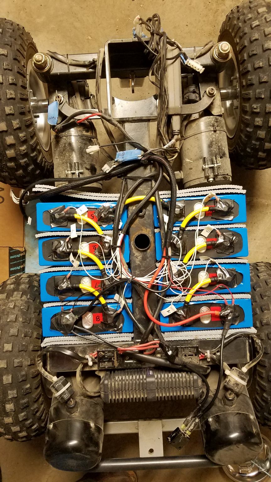

swalker wrote:fishinjunky wrote:]are these cable sizes sufficient for a 8s x 230ah pack?
For my 176 Ah pack (8 cells in series), I used the following. I would do the same for a 230 Ah pack.fishinjunky wrote:6awg or 8awg for connecting the cells instead of using bus bars?
I computed 10 sq mm was the conservative size, which equates to 7 AWG. Since neither 10 sq mm nor 7 AWG was readily available in the US, I went with 6 AWG. It worked great. In my opinion, bus bars are too rigid and may cause the connections to the cells to loosen up over time. I made sure the cable I used for inter battery connections were flexible and I used relatively long runs (see the yellow cables in the attached picture).fishinjunky wrote:10awg for charging cable?.
I used 10 AWGfishinjunky wrote:10awg for cable going from battery pack to power module?
I used 10 AWGfishinjunky wrote:Also do I need to make sure to get cast extra thick wall terminals (not copper)?
I favor high quality, tinned copper terminals. For the larger size, I used Selterm marine grade terminals. For smaller sizes, I used Ancor marine grade terminals. All were tinned copper and heavy enough to use with appropriate crimping tools for crimped connections.fishinjunky wrote:And would it be beneficial to include a cell monitor in the build. I would like to be able to get an idea of battery level while out riding just for peace of mind. What would be my best option for doing that?
I added a cell meter to my setup and found it pretty useful, especially as I was new to using the LiFePO4 battery pack. I use it less now, but still use it enough that it goes with me on every ride. Here is the one I used: https://www.amazon.com/gp/product/B073W ... UTF8&psc=1
LROBBINS wrote:I am surprised that no one has commented on your choosing AWG10 for the battery to PM connection. That's too small. Most of us in Europe are using 10mm^2 for that, but the AWG7 equivalent is not to be found. You can go to AWG6, which is fatter than needed, if you can't find 10mm^2 or AWG7.
