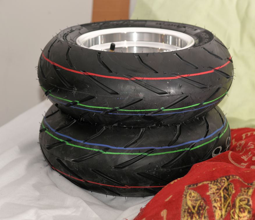

Dont suppose there's any tubless rims that fit 14" 3.00-8 tubless tires on 3 mounting holes of the 120A 4-poles?
I need to keep max width as stock (62cm / 24.49") due to my flats front door opening clearance being only 27" plus having only 34" corridor right angle radius turning area.

Postby Burgerman » 07 Feb 2020, 01:59
Never saw a tubeless 3 x 8 tyre. Rim? Possibly but it will be SLIGHTLY wider and harder to fit. And whatever you fit will not be plug and play. Make the door wider! :fencing :hammer :hammer :hammer
Posts: 70442

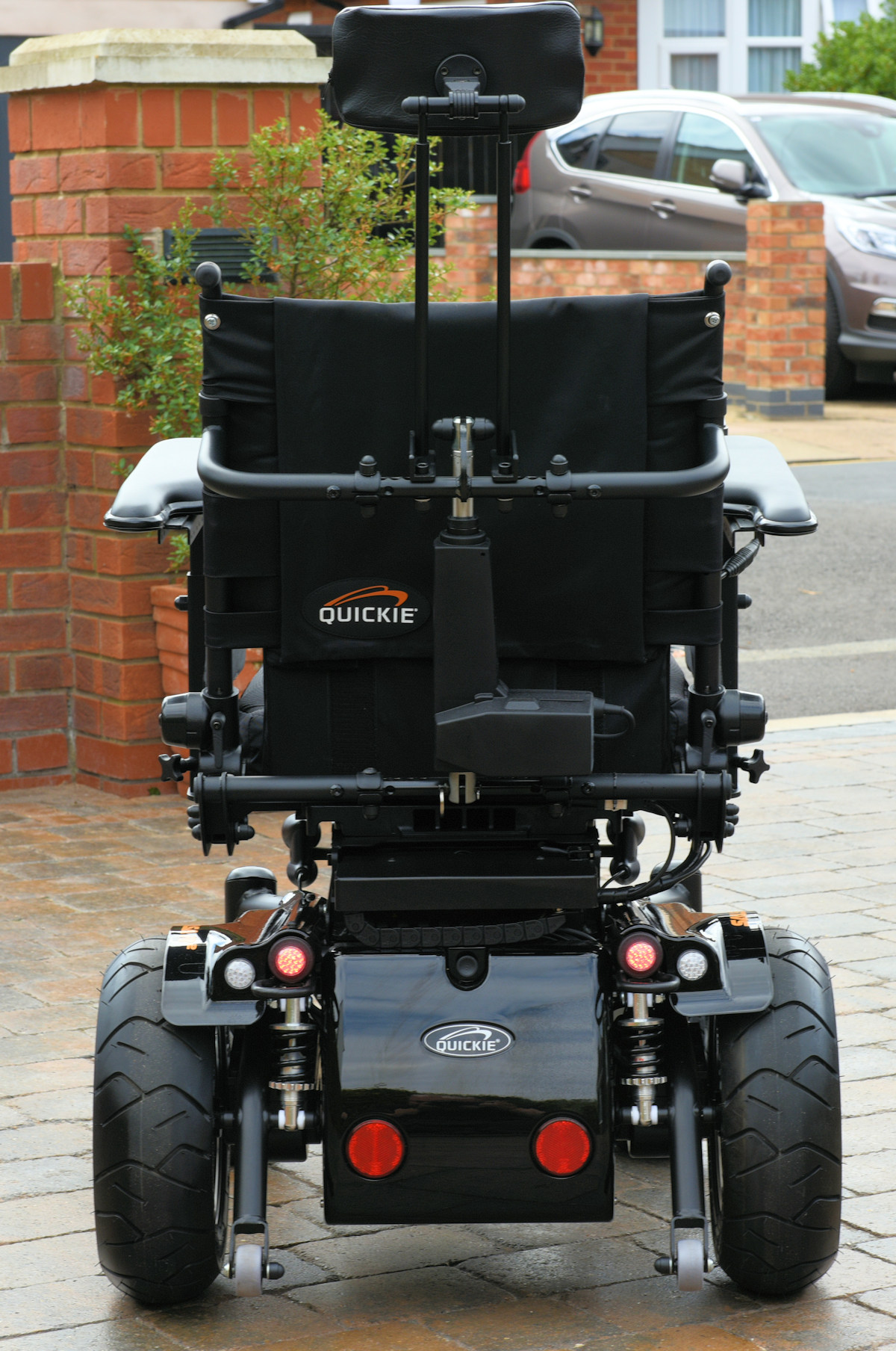

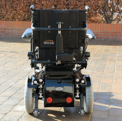

Postby Burgerman » 07 Feb 2020, 02:11
The difference.
From a 6 stone weakling to a mafia "heavy" in one go!
From pram to pimped...
Wheel Rim
120/70 - 8 TYRES, 3.5 WIDE RIM.
Posts: 70442
Postby Burgerman » 07 Feb 2020, 02:25
Even with the rims and tyres, its still over an inch narrower than the X5/V6 powerchairs. You were hoping to copy mine were you not? Did you look at those cranked door hinges? They gain you 2 inches when the door is open. And this chair is 27 and 1/4 wide...

Postby Burgerman » 09 Nov 2020, 01:49
Rims are on eBay at too high price, on many chinese auction sites, and shirley sent me mine very cheaply for 2 pairs.
They are 3.5j wide, and 8 inch diameter. Tyres are the more expensive bit. At around 70 to 100 a set! Yes I made an adapter. Its a lump of alloy with a bunch of holes and threads.
I will remember where the pics are soon... :clap I made the adapters on my pillar drill in my room. They were precut for size and ordered that way from a laser cutting service. I just drilled the holes.
