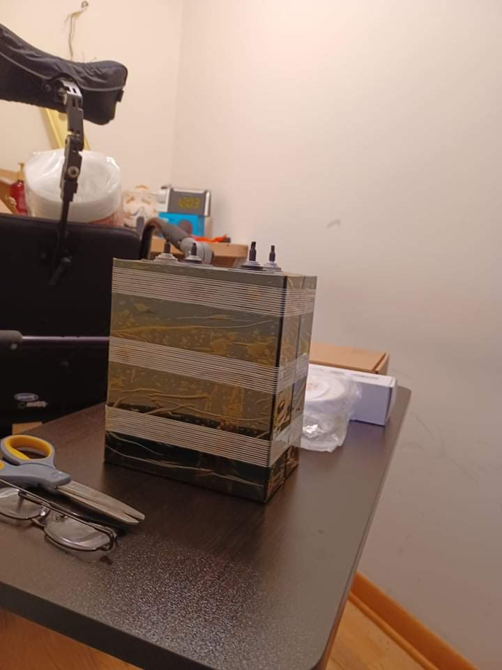

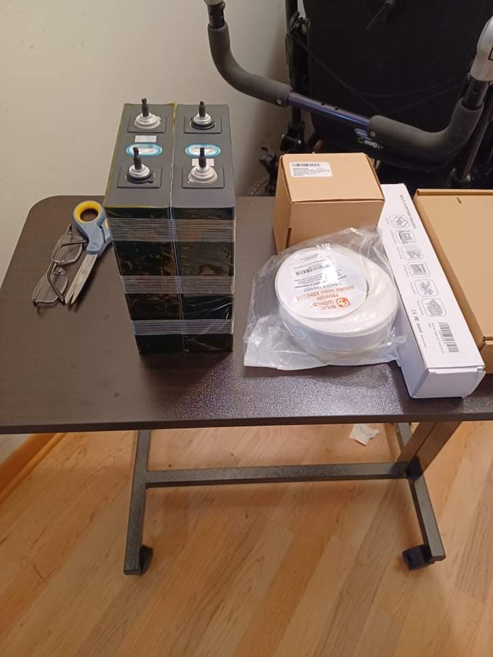

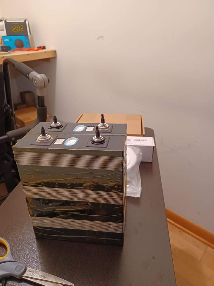

Starting to take shape. Wrapped each cell in 1 thin layer of kaptone tape then used ultra thin permanent double sided tape to a sheet oh high temp silicone between for insulation then 3 bands of reinforced strapping tape 1 layer. I'm going to test these two next for capacity then repeat same for rest of the pack

Postby Arima » 20 Jan 2022, 03:54
Coming along! Had not thought about using a high temp separator but it can"t hurt.
