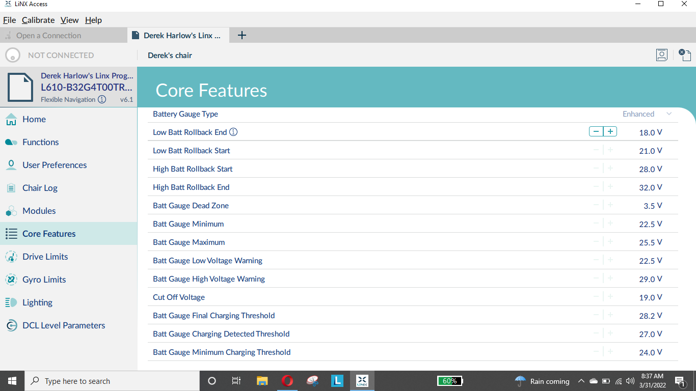

Postby fishinjunky » 31 Mar 2022, 13:56
im changing some of the battery gauge setting for Linx to accommodate lithium. I took a screen shot of the originial settings an i listed below what i plan to change an the voltage im changing them to. What do you guys think do i have these setting correct do i need to change anymore? I put a question mark on the ones i wasnt sure what to change them to
High batt rollback start 29v
Batt gauge minimum 24v
Batt gauge maximum 28.8v
Batt gauge low voltage warning 24v
Batt gauge high voltage warning 29v
Cut off voltage ?
Batt gauge final charging threshold 28.8
Batt gauge charging detect threshold ?
Batt gauge minimum charging threshold ?
Posts: 1089
Postby Burgerman » 31 Mar 2022, 14:33
What does this actually do?
A lead battery is charged at (not "to") 28.2 Gel or 29.4 AGM Max. After charge it falls from this in a curve hat starts fast and gradually slows to 12.85V. So not sure how setting this helps anything?
Lithiu ion phosphate should reach 28.8V peak while charging. Then almost imediately drop to around 3.4 something per cell. So again, what is it for?
Additionally, If I do a fast turn in place or wheelie, the lead battery drops to 24.xxV in an instant or less depending on impedance. And then recover fast to around 25v and then climb over time for the next couple of hours. I can actually get it to hit 18 volts whie fully charged.
Is that under load, ignoring this, or while I do the above? And for how long?
This is for the display. So your guage will always read around 90 to 95% full when fully charged around 10 mins after disconnecting the battery charger?
I can make it voltage actually read 18V by repeatedly wheelying or even a rapid turn in place when FULL.
Watch vid. Note that the NOW voltage is the large number. The 3 lower smaller number are peak values. High, average, low.
This is because of internal battery resistance.
Note that this has just come off an overnight charge. I dropped it to 18.X Volts - lowest figure really easly. Download to desktop before playing.
https://www.wheelchairdriver.com/gopro/voltdrop.mp4
And so all the figures you choose above are meaningless. They are there because somewhere there exists a programmer that doesent understand ohms law or batteries wrote some "exact" code! The more nonsense they add the better or more clever they feel.
This will go off if you spike the voltage upwards by slamming in reverse to slow down due to regenerative braking. So whats it for?
Cut off voltage ?
What do you want this for? Look at the vid above. Does it cut of instantly, or average over time, does it only take a reading when stick is central? All these things determine whare is at al this should be set and again we dont know. And its just down to a programmer that hasnt a clue.
These things are a way to allow the system to better guess what stage the battery is in. All pretty meaningless really. Esp as lithium behaves diferently to lead... So these things wont help you uch or at all. Quite the contrary. They dont much help on lead either! This nonsense is why battery gauges are useless.

Postby fishinjunky » 31 Mar 2022, 14:44
Burgerman wrote:]High batt rollback start 29v
Cut off voltage ?
thanks bm,
thats what i thought, im just going to leave them as is i just want to avoid any error codes. But if i get any error codes ill make adjustments if needed. I wont be going by the battery gauge anyway i stopped going by it after listening to you guys that they are useless an missleading. Im going to go by millage averages and AH going back in.

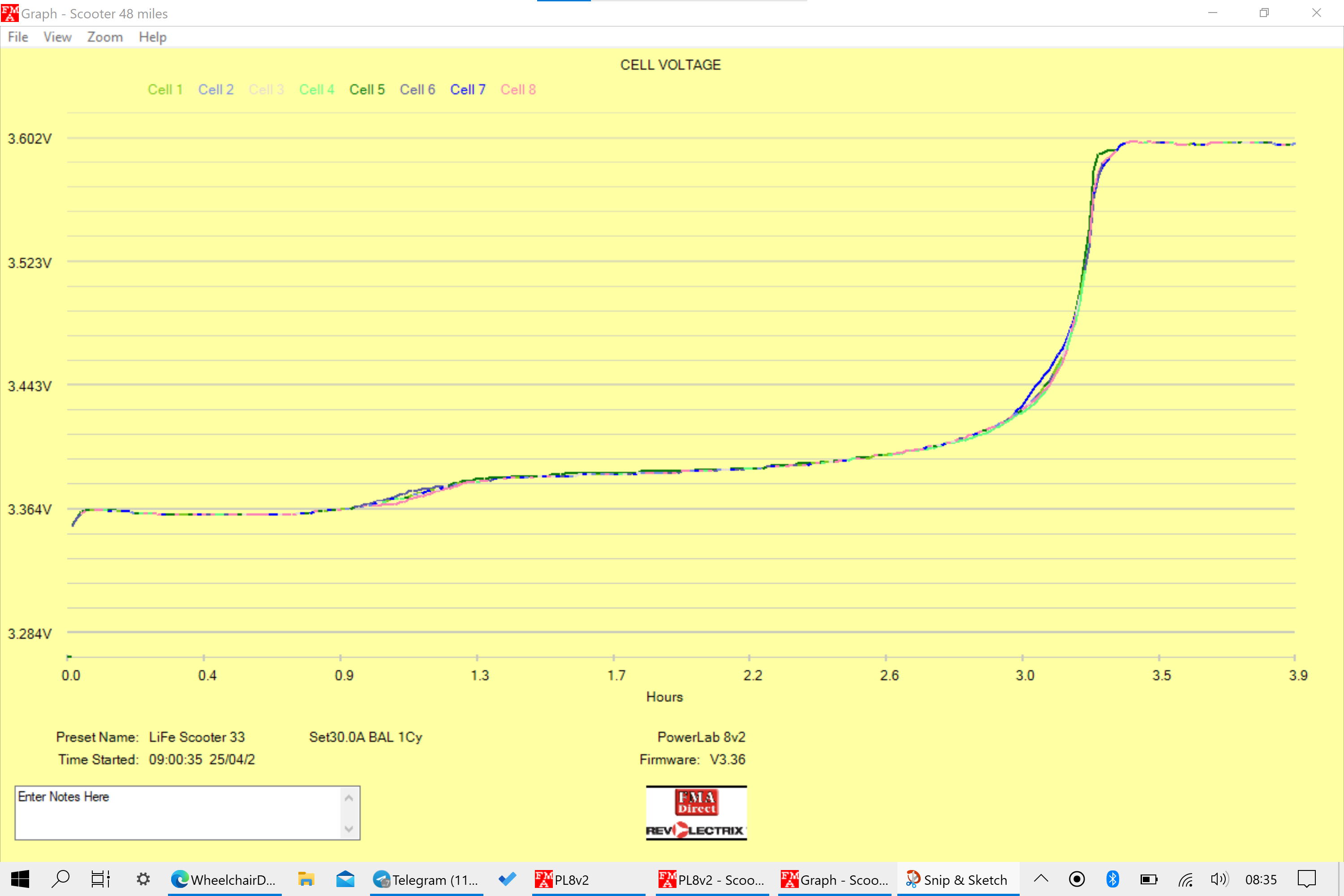

Postby Scooterman » 26 Apr 2022, 08:41
This is only the THIRD charge after I thought my 180Ah pack had gone terminal.
Scooter left outside all winter and voltage dropped to almost ZERO (around 4 volts for a 24 volt pack!).
It took some jiggery pokery to get pack to recover, thanks to WD.com forum members.
But it looks good now. The cells have probably sustained some damage, and I was resigned to having to buy new cells to build a new pack which I didn't fancy doing.

Postby Burgerman » 26 Apr 2022, 09:21
You were lucky.

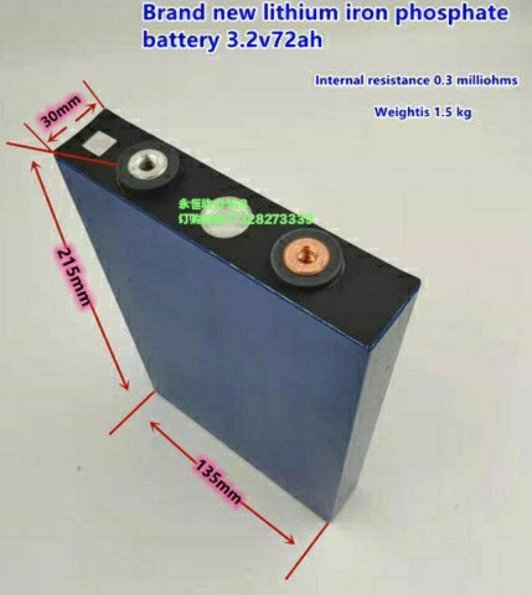

Has anyone done a 22nf battery swap to lifepo4? What's the most AH that will fit?
I have a 12 year old invacare mwd tdx sp that I just can't let go of mostly because of nostalgic reasons it was my first chair an I've taken good care of it but I only use it in winter an indoors or as a spare. I'm not a fan of mwd. I would like to fit it with lifepo4 mainly for longer service life an improved performance but the range will also be great if I need it. Also to be honest I'm missing the build process of my last lifepo4 build. What do you guys think?

Postby shirley_hkg » 01 May 2022, 12:07
16 of these will add up to 144 Ah.

Postby fishinjunky » 01 May 2022, 13:20
with 16 cells would i make two 8s packs then connect the two 8s packs in parallel ?
