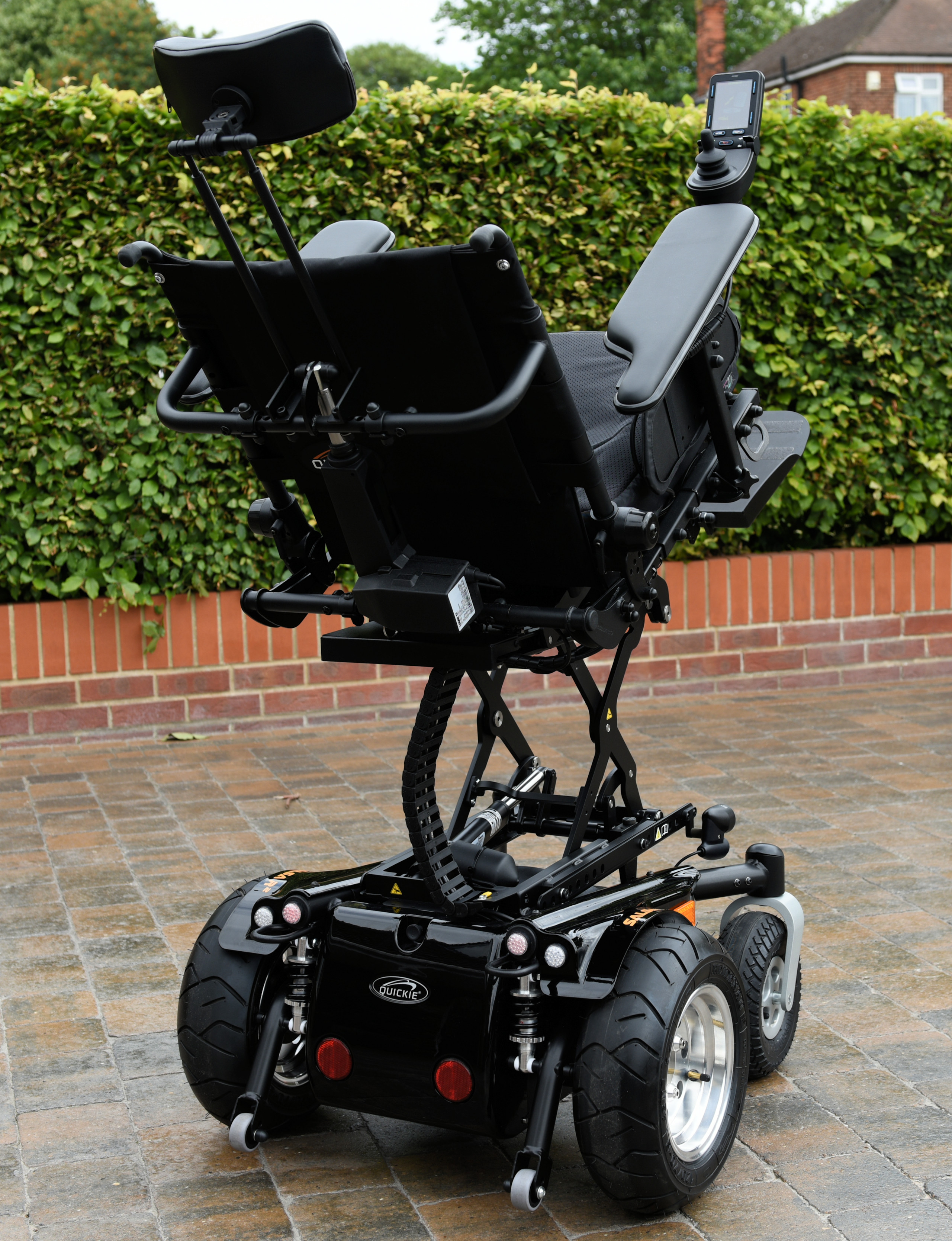

Postby Burgerman » 01 Jan 2023, 12:48
You can see how flat and wide they are here.
You cant see how nice and soft they are!

Postby Toro » 01 Jan 2023, 13:26
Yes they are exactly what I'm looking for.
I'm hoping they have them here in Australia from Sunrise Medical.
I'm going to see tomorrow about a Magic Mobility V6, about 4 years old and about 1000 pounds which is unusually low.
I'll strip it down, see what needs to be done, needing to upgrade aspects of it like new colour controller and got to see if it's got tilt and lift. All in all not bad to have as outdoor chair.
