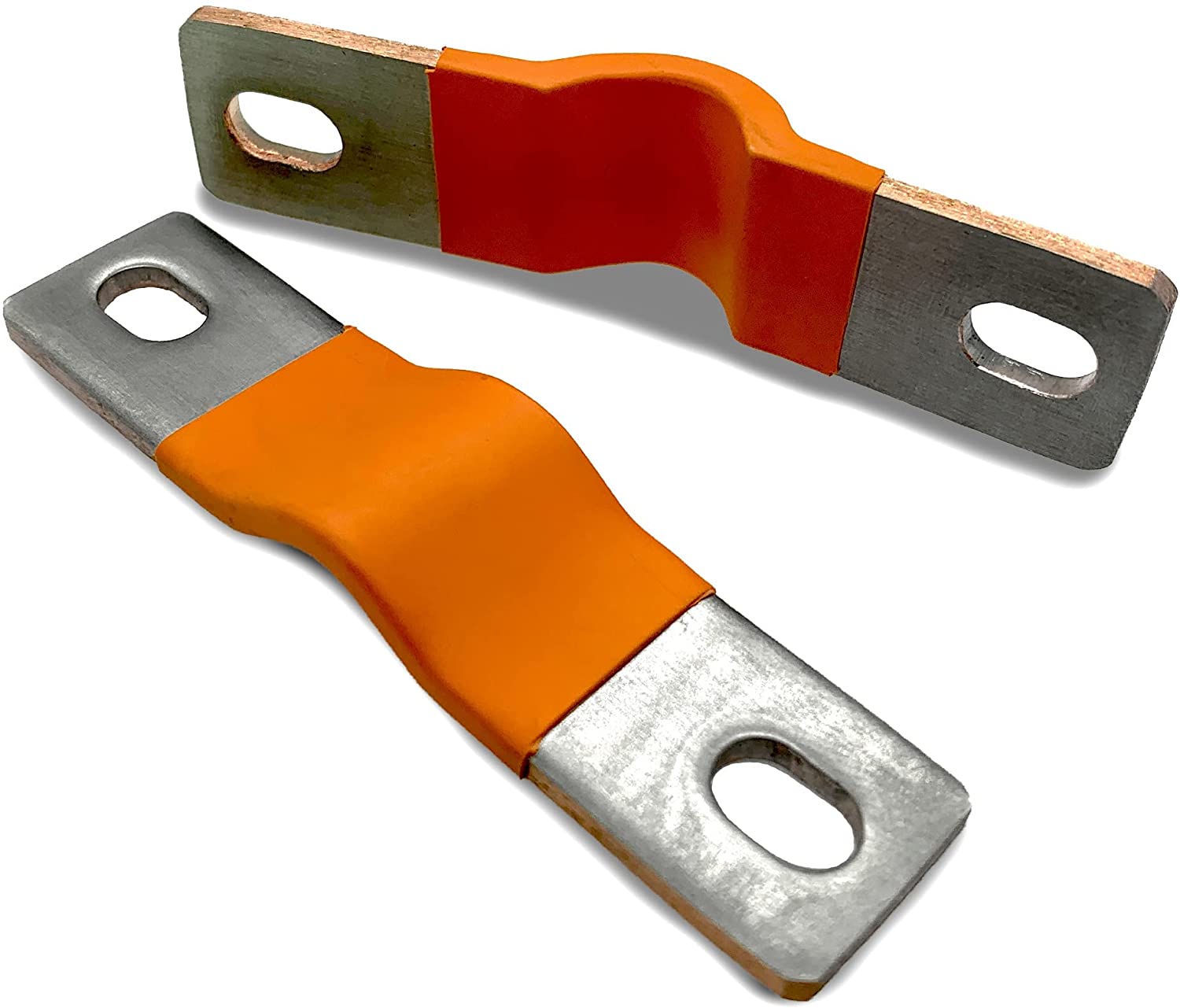

Postby fishinjunky » 26 May 2022, 13:59
Scooterman wrote:https://www.aliexpress.com/item/1005004111160334.html?spm=a2g0o.detail.0.0.96545f43NETtUY&gps-id=pcDetailBottomMoreThisSeller&scm=1007.13339.274681.0&scm_id=1007.13339.274681.0&scm-url=1007.13339.274681.0&pvid=159fd1ce-7409-482d-bac7-78a2b9a7b57c&_t=gps-id:pcDetailBottomMoreThisSeller,scm-url:1007.13339.274681.0,pvid:159fd1ce-7409-482d-bac7-78a2b9a7b57c,tpp_buckets:668%232846%238109%231935&pdp_ext_f=%7B%22sku_id%22%3A%2212000028066689807%22%2C%22sceneId%22%3A%223339%22%7D&pdp_npi=2%40dis%21GBP%21%2128.82%21%21%21%21%21%400b0a23a716535689428973560ebbab%2112000028066689807%21rec
Anyone tried this style of links? :problem:
I would recommend bus cables always as first option but as a very last resort I would use these Flexible busbars
The ones you linked are not insulated an the holes on those don't fit right
These are the ones I used
US $3.90 | Insulated Flexible Bus Bar Flat Copper Busbar 3mm 300A for 3.2V 3.7V 100Ah 200Ah 280Ah 320Ah Battery Pcak Parts with Cu Ni
https://a.aliexpress.com/_mPRqY4A
Posts: 1089
Postby Burgerman » 26 May 2022, 14:50
Are they easily flexible and not solid one bit?
Like these: https://www.aliexpress.com/item/3256803787045526.html

Postby Scooterman » 26 May 2022, 16:39
I do agree, but it is a faff crimping/soldering lugs onto the ends of all the cable links. Especially with 16 cells, you need SOOOOOOOOOOOOOOOOO many links czy
I know you don't agree but next time I build a pack I'm going to give this style of link a go. The lack of insulation problem only really matters if you drop a spanner on top off the cells. Something I would never do!!! :oops: :ambulance
Screenshot 2022-05-26 at 13.44.34.png (138.87 KiB) Viewed 3778 times
But it could be rectified with some lightweight shrink sleeve mildly shrunk. Like when you put accidentally your wool socks in the machine along with your nylons/acrylics on too hot a wash. :problem:

Postby fishinjunky » 27 May 2022, 12:54
Scooterman wrote:
i just worry about the longevity of the flexible busbars including the type i used. Maybe they will be fine but maybe not. This winter i plan to reevaluate my space on top my pack an try to fit bus cables replacing the flexible busbars. Do the busbars you posted come in different lengths? if you can get them in different lengths an if you heat shrink them they should be fine. There just no data on these flexible busbars or on the ones i used in our application for packs in our chairs "lots of vibration" is yours 48v?

Postby Vitolds » 27 May 2022, 15:25
flexible copper bus has been used for many years in cars, connecting the mass of the body - the engine.
You can quickly buy this braided copper bar at any auto shop. You also need a cable lug (Copper sleeve 50mm2 tinned for crimping, for wire 50 squares), if you use a copper bus 15mm wide and 2mm thick.
Cut to desired length and crimp. Drill holes slowly. Braided copper bar 15 mm wide and 2 mm thick is 16 square or 4 AWG wire

Postby fishinjunky » 27 May 2022, 21:40
Vitolds wrote:flexible copper bus has been used for many years in cars, connecting the mass of the body - the engine.
That would be nice you get flexibility and shorter length
Posts: 1089
Postby Vitolds » 27 May 2022, 23:31
no problem, make any length by cutting the wicker bar

Postby Burgerman » 27 May 2022, 23:39
I wouldnt use bare copper. Oxidises fast. And that matters when we are looking at mV for balancing etc. And I would not crimp but solder. Better to buy the nickel plated ones already on that website.
Posts: 70452
Postby shirley_hkg » 28 May 2022, 07:09
Aren't a piece of wire and 2 ring terminals more simple and reliable ?
Postby Burgerman » 28 May 2022, 07:12
Yes and esp if soldered and plated against corrosion or/and oxides.

Postby fishinjunky » 28 May 2022, 13:18
Burgerman wrote:Yes and esp if soldered and plated against corrosion or/and oxides.
That's what I was thinking,
I even went a bit overkill and used mg chemicals conductive carbon paste to help prevent corrosion between connections. This would be more of a concern if using dissimilar metals or raw copper.
