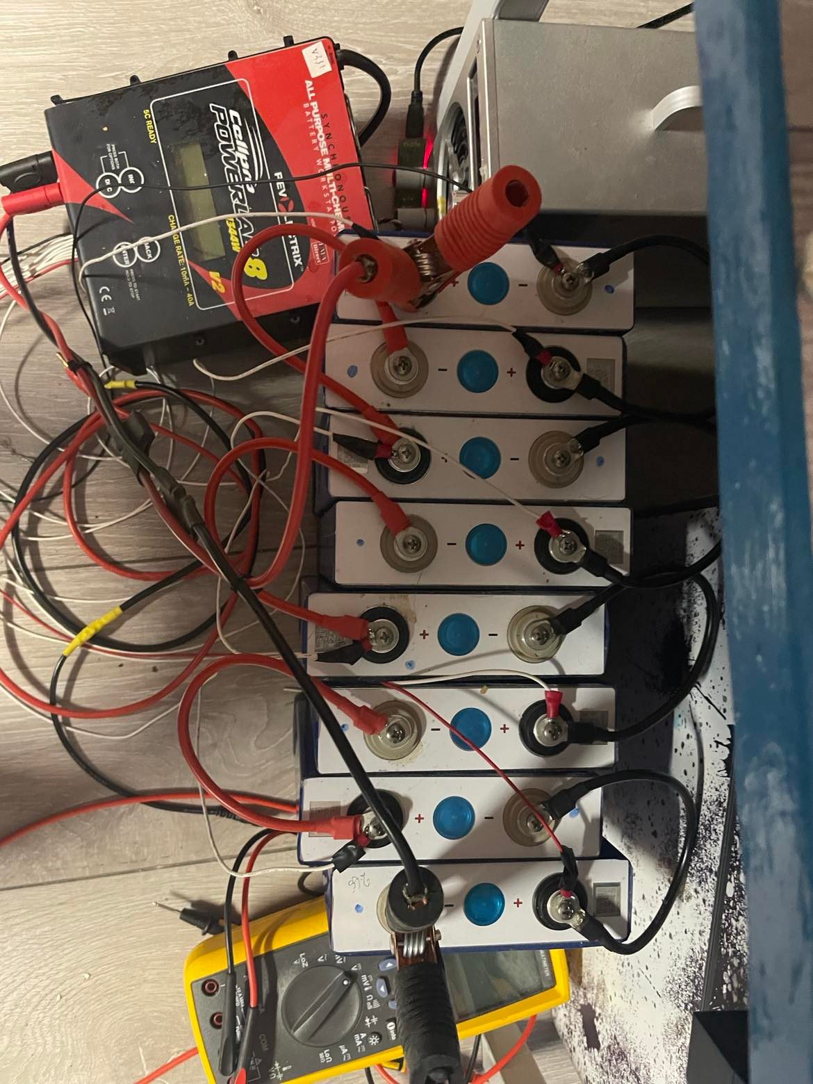

Can anyone shed some light on why I'm having issues charging 8S EVE-LF105 cells?
Melissa helped me to create a wiring harness to allow me to charge 8 cells using a PL8 balance extension cable with terminal rings crimped and soldered on. Testing the pack with my Fluke 289, it reads 26.xx volts with 8 cells in series. But if we measure each pin on the balance plug we get the following...
Code: Select all
Cell 1... 3.xx volts Positive
Cell 2... 6.xx volts
Cell 3... 10.xx volts
Cell 4... 13.xx volts
Cell 5... 16.xx volts
Cell 6... 20.xx volts
Cell 7... 23.xx volts
Cell 8... 19.xx volts Negative
The PL8 throws a Bad pack error, as it only detects 4 cells. All screws are put in with the same 3Nm Torque setting with my Bosch powered screwdriver and all cables pass the continuity test.
Even removing 4 cells, the PL8 detects 3 cells. banghead Help!
Two of my PL8's do the same thing, but works fine with my chair's pack.
Postby LROBBINS » 21 Sep 2022, 18:12
It's hard to see all of the connections in that photo, but the wiring does not seem to be correct. For one thing, you have the black balance lead connected to the + end of the pack and there doesn't seem to be any balance lead at all at the - end. Here's the diagram from the PL8 manual:
BLACK bal lead to pack -, RED to pack +, and the white leads in the order shown. Cell voltages should be measured with voltmeter negative (or common) lead to the pack -, and all values should be positive and close to what's shown in the diagram.

Postby woodygb » 21 Sep 2022, 19:17
As Lenny says ...the balance wires are bit of a mess and out of order.
Start again .
Postby steves1977uk » 21 Sep 2022, 20:06
Lenny, the top cell (Cell 1) has the black negative balance wire connected to the negative terminal plus the first node 1 white wire on the positive terminal. Cells 2-7 have nodes 2-7 white wires are on the positive terminals, and the red node wire is on the positive terminal on Cell 8 (bottom cell). I believe this is the right order? The main power cables are on Cell 1 and Cell 8 which I get 26.xx volts from.
But yes Woody, Me & Melissa will start again with the wiring. :thumbup:
Postby Burgerman » 21 Sep 2022, 21:24
You dont appear to have a balance wire on the negative wire.
Posts: 70459
Postby LROBBINS » 21 Sep 2022, 21:33
What is the negative pole of cell 8 connected to? You may have mixed up some of the power jumpers as well - cell 8+ should go to the battery not to cell 7 -, cell 8 - should go to cell 7 +, cell 7 - to cell 6 + and so on.
Posts: 5794
Postby Burgerman » 21 Sep 2022, 22:42
It is possible to damage the charger if you get these wrong. So care needed.
Posts: 70459

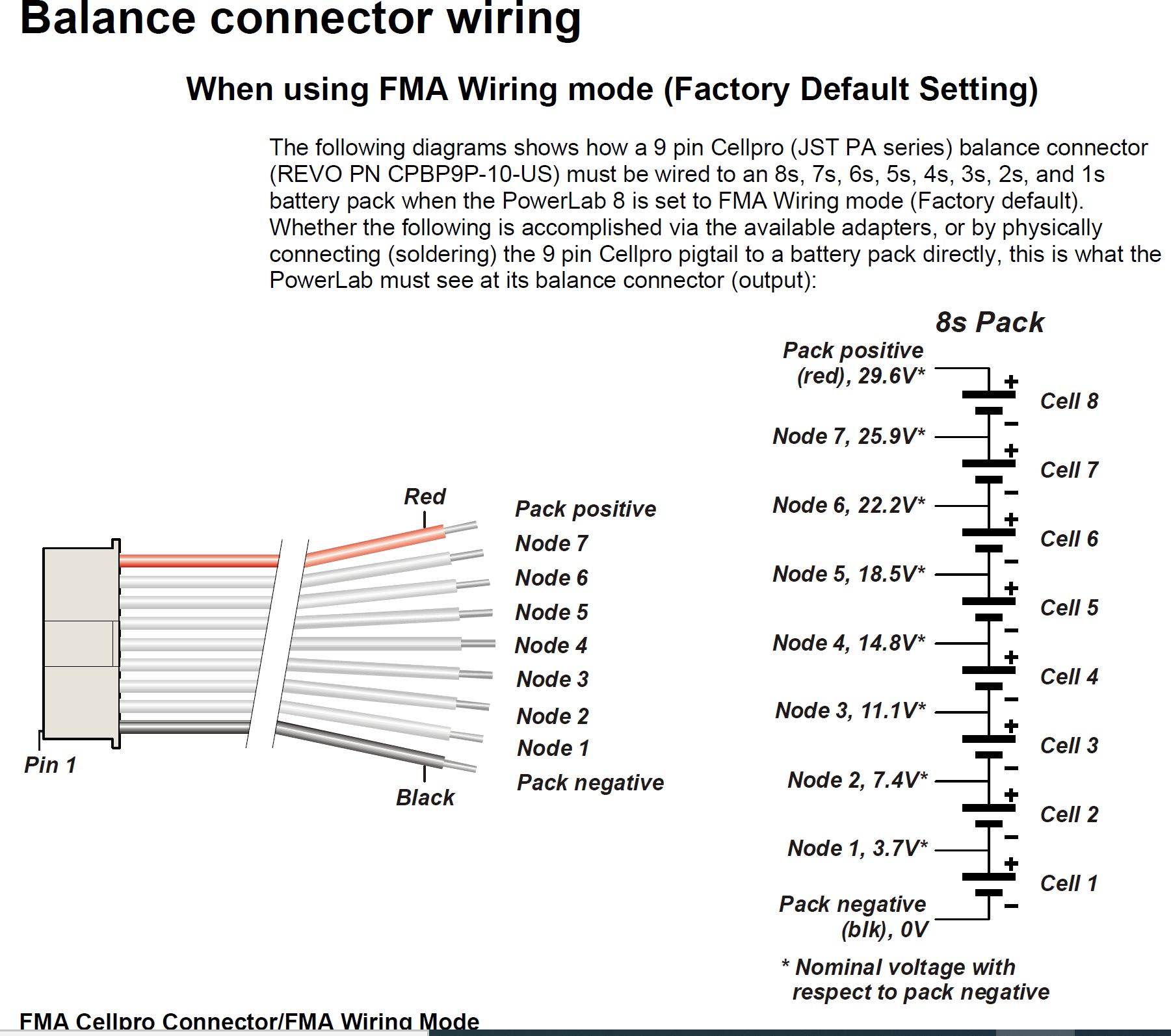

Postby steves1977uk » 21 Sep 2022, 23:06
The wiring was the same as this setup, which in theory should work...
I double checked Melissa had put the balance wires in the correct place.
Postby steves1977uk » 21 Sep 2022, 23:16
I'm a fool, I spotted my error! The black and red balance wires need to be on the same terminals as the main charge cables. I feel stupid now!!! :oops:
Postby woodygb » 21 Sep 2022, 23:23
steves1977uk wrote:The wiring was the same as this setup, which in theory should work...
Steve ...A good start would be having the red and black balance wires going to the correct terminals at each end of the pack....I.E. The main Positive and Negative power terminals.
Edit ...Ah you spotted that ...BUT swapping them over is NOT the whole story....I suspect that ALL the balance wires need to be reordered.

Postby shirley_hkg » 22 Sep 2022, 00:53
Burgerman wrote:You don't appear to have a balance wire on the negative wire.
John is right .
Besides , we all number the cells from the NEGATIVE and up.
The negative end is cell 1
The positive end is cell 8.
BMS uses 8 balance wires only . PL8 has 9
Always start with the first balance lead on the (Negative Terminal) , and then … ALL SUBSEQUENT LEADS TO EACH OF THE 8 CELLS' POSITIVE TERMINALS …accordingly .
Confirm the volts of the JST connector , 0 ,3, 6, 10, 13, 16, 19, 23, 26 , BEFORE hook up PL8.
Woodygb spotted you another mistake too.
woodygb wrote:Note that you have in the pic ,on the top pair of cells , 3 balance wires ( 2 white and one black ) , there should I believe be only 2... Red and one White..
Posts: 4565

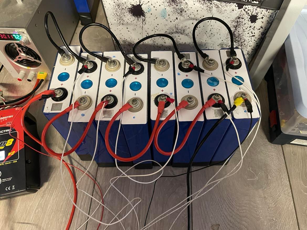

Postby steves1977uk » 22 Sep 2022, 19:11
Me and Melissa redid the wiring, now it looks like this...
The pack is slowly charging at around 1A, the IR of the cells is between 5.1mOhms and 9.0mOhms except cells 4 and 7 which are in the 50's. Melissa said it might be her soldering as it was the first time at it which isn't bad!
What's the best way to discharge a fully charged cell while the others catch up? Would a car bulb work?

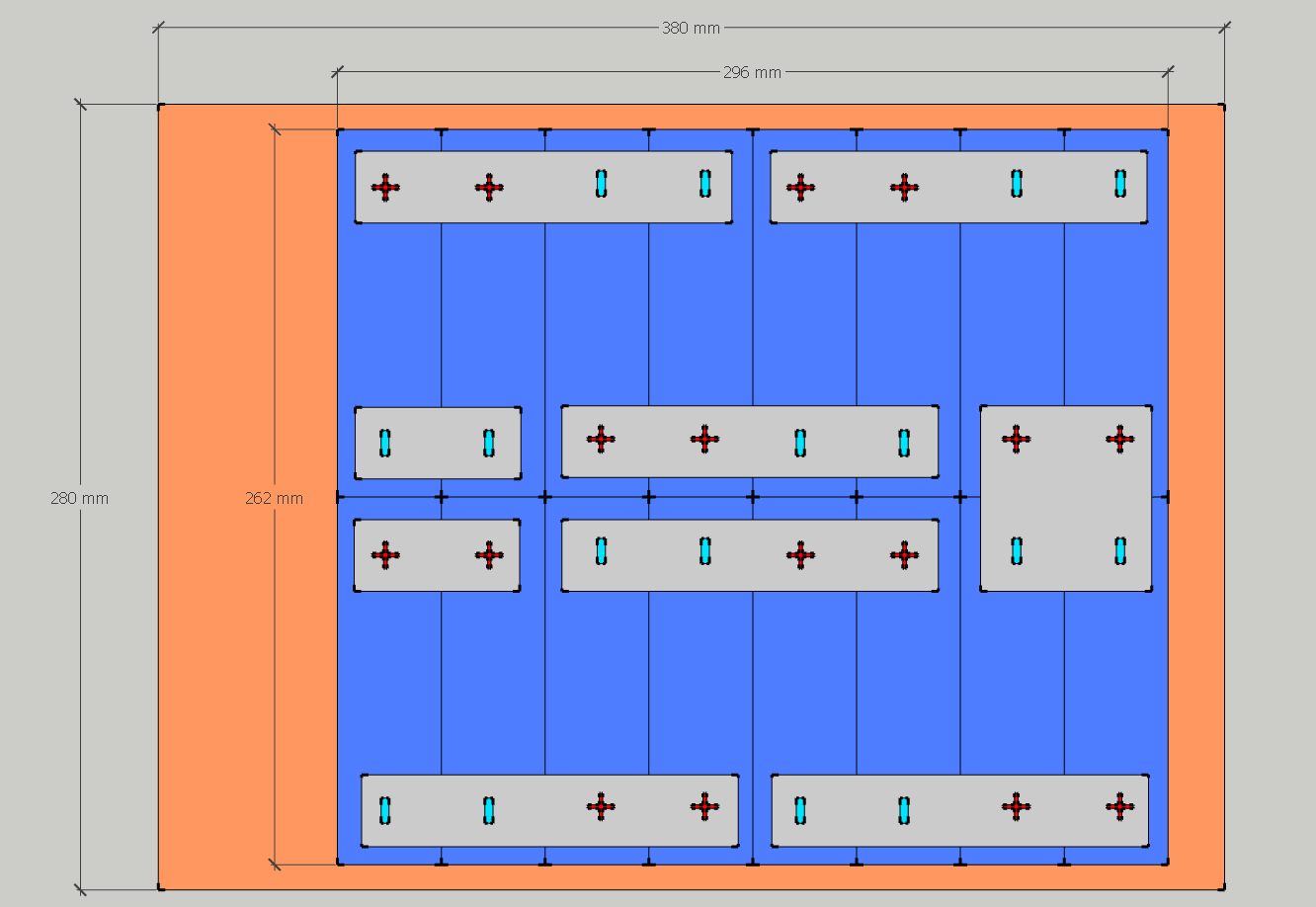

I have the opportunity to buy 16 Liitokala 3.2V 105Ah cells like the following:
http://www.aliexpress.com/item/1005001581160612.html
Would those work with my Invacare TDX SP chair?
I have a space in my chair for batteries of the size you will see in the diagram. The connections I should make for those cells I think are also the ones I have put in the diagram, right? That would leave a configuration of 2P8S and a 210 Ah battery. To charge them I would use the Revolectrix Cellpro PowerLab 8 charger that I use for the headways.
https://i.gyazo.com/97f96f927ea3234ce88d688c87a64004.png
Am I correct or am I miss something? The batteries are used, for a home solar station, says the one who sells them to me, that has only been used in 150 cycles, so I would still have many cycles and the price is a little lower and, above all, that I do not have to wait 3 months for them to come from China, because in Europe I do not know of any place to buy them and that they do not take 3 months to arrive to me.

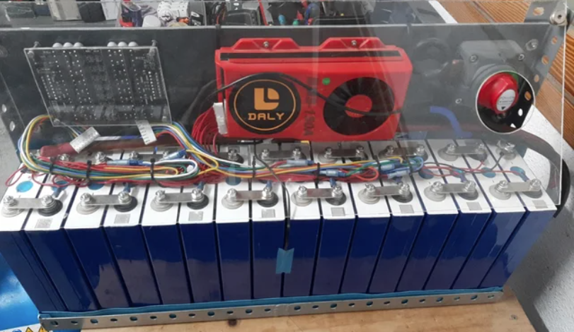

You need to measure cell impedance, and cell self discharge rates individually. Not just capacity to see that all are similar and low. That alone will take a month sat to test.
And not promising.. photos. DALY BMS shown has an unbelievably low balance current capabilty of around 30mA... So while it looks pretty. It is actualy pretty useless. Even if he had a clue how to configure it. So I would certainly test.
