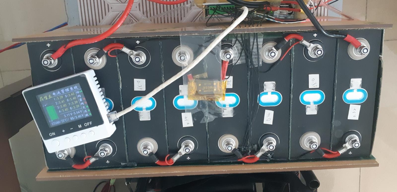

Postby shirley_hkg » 25 Jan 2023, 05:38
220Ah for a friend's OTTO BOCK B3 with long and narrow compartment .
Gum fish / gasket paper between cells , and all are contained in an U-shape plastic duct .
Initial charge . MOS_less BMS for charging only. Direct output to wheelchair.

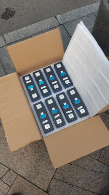

Postby shirley_hkg » 03 Jul 2023, 13:56
It's not related to "michaelg" post in any way. It just happens.
cheers
My fried ignored my favourite CATL and bought 8 EVE-230 cells. (£400)
I helped to fit them into the stock battery boxes of a Invacare ARROW GB.
Will be using ZXD2400 with a BMS.
(Charger in the pic was dumping a little from it, before put into his ARROW.)

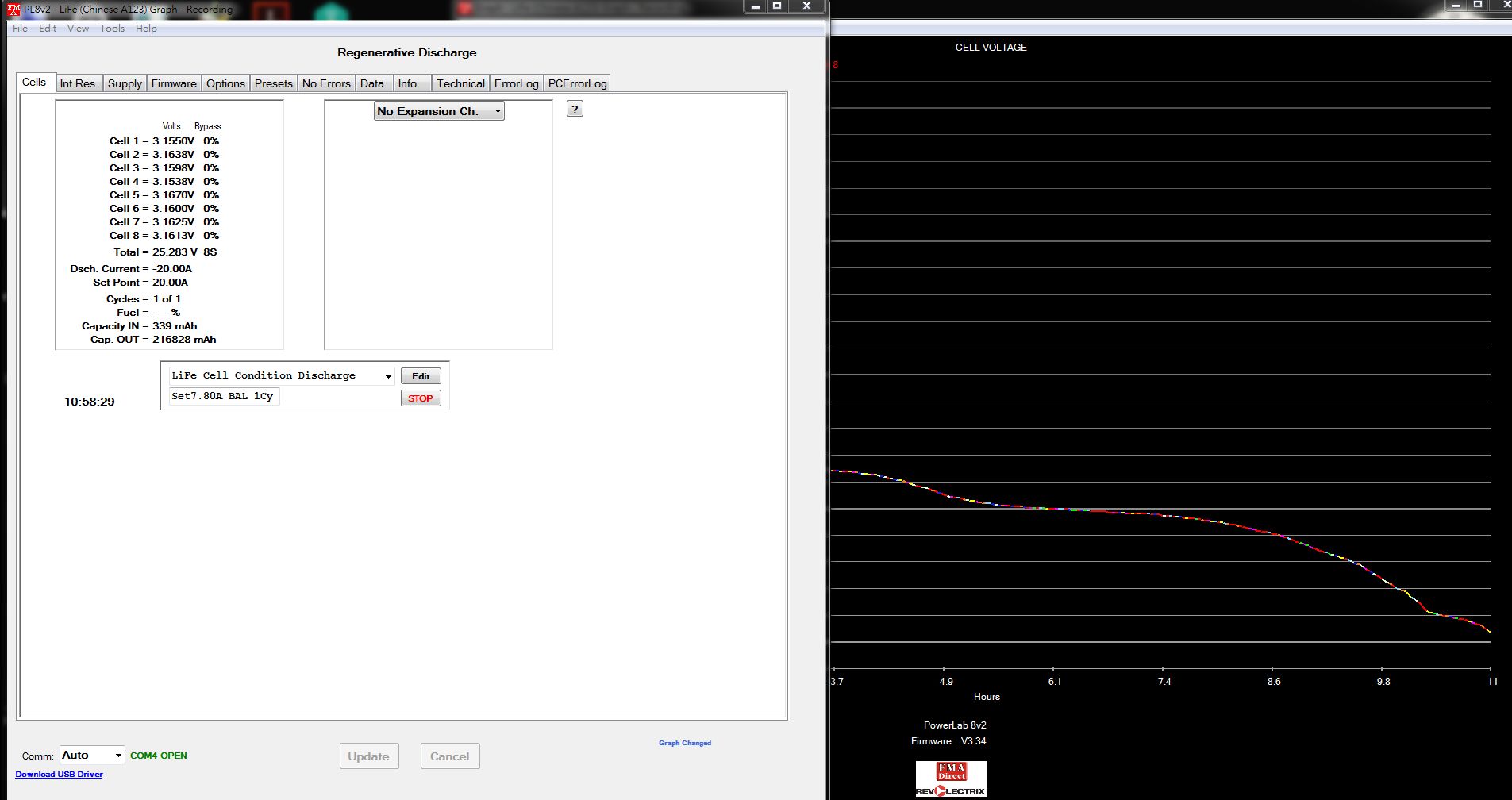

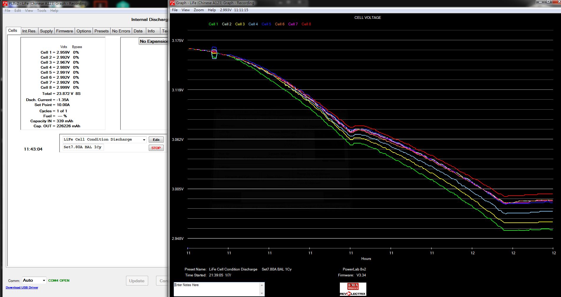

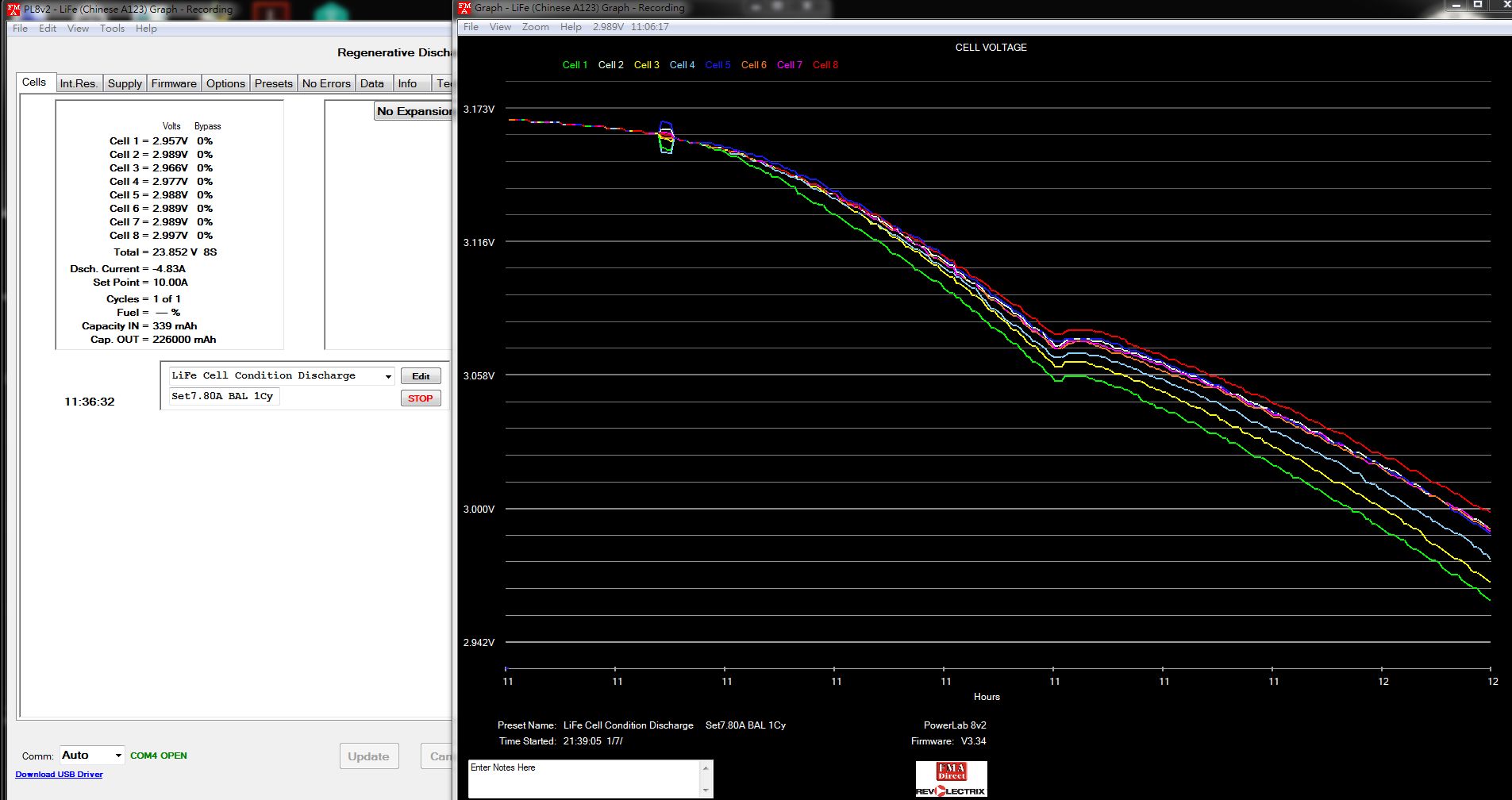

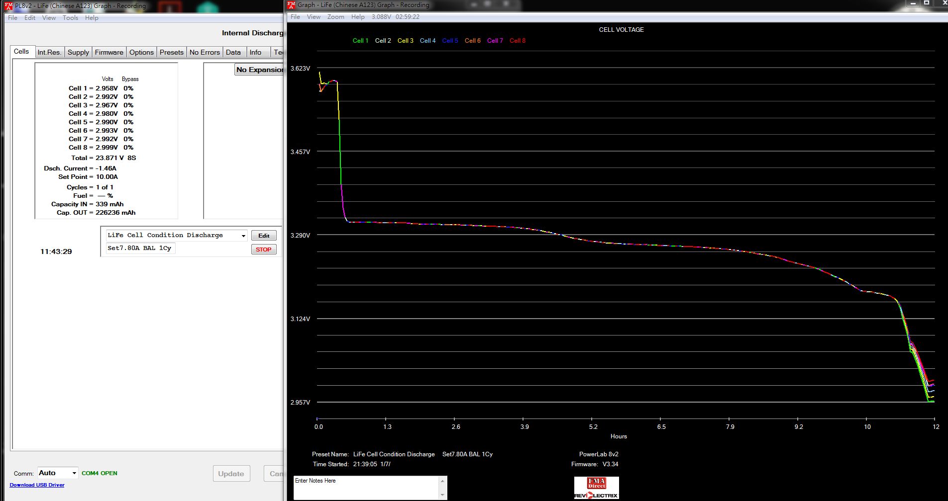

Postby shirley_hkg » 03 Jul 2023, 14:09
PL8 helped to determine its capacity.
Cells' voltage began to deviate after 215Ah dumped.
Posts: 4483
Postby shirley_hkg » 03 Jul 2023, 14:15
226Ah.
:cussing Beat my CATL (222) drunk2
Posts: 4483
Postby shirley_hkg » 03 Jul 2023, 14:19
Terminal voltage drunk2 24v
LiFe (WONG_C_W) Graph.CP8
(221.67 KiB) Downloaded 98 times

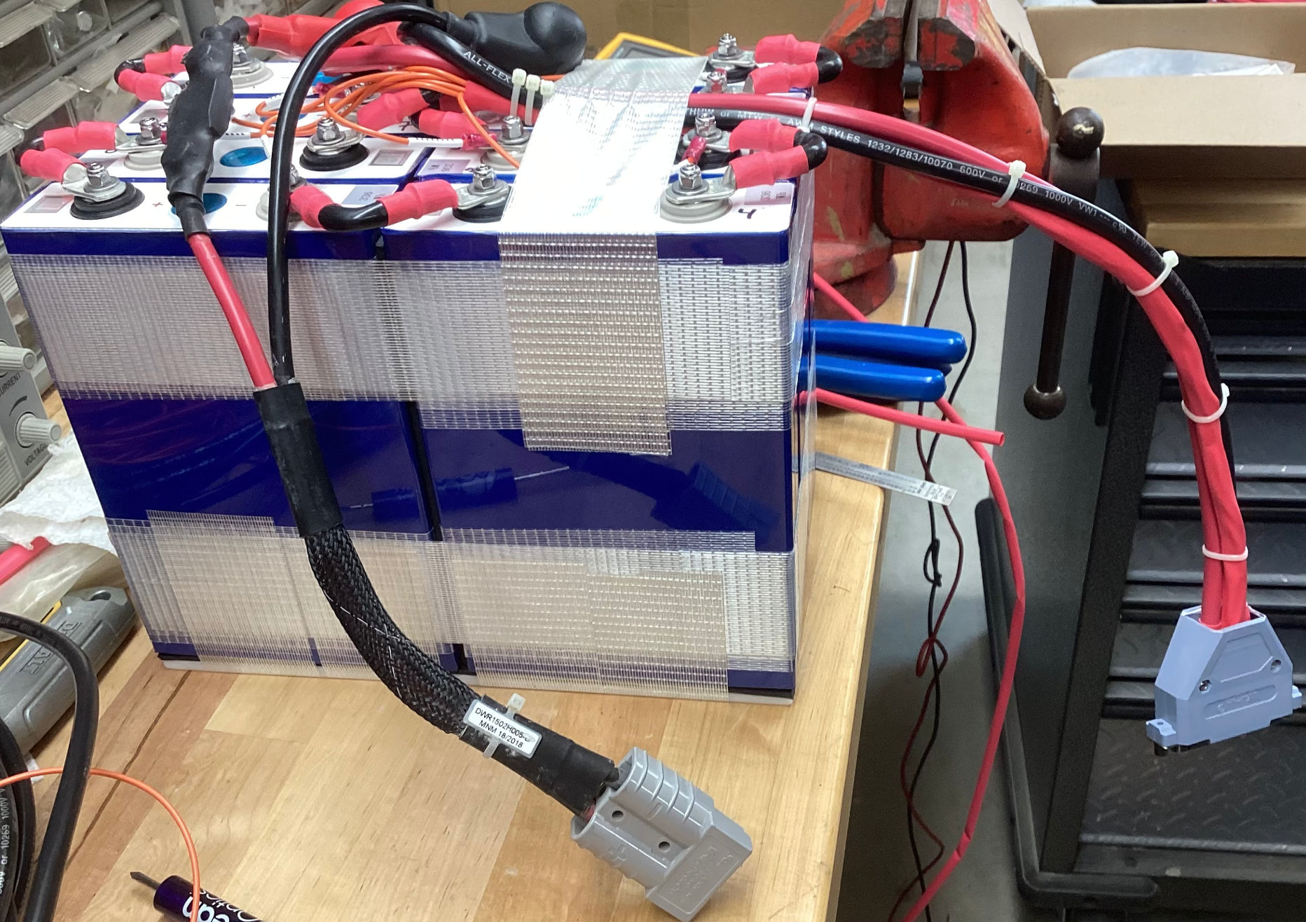

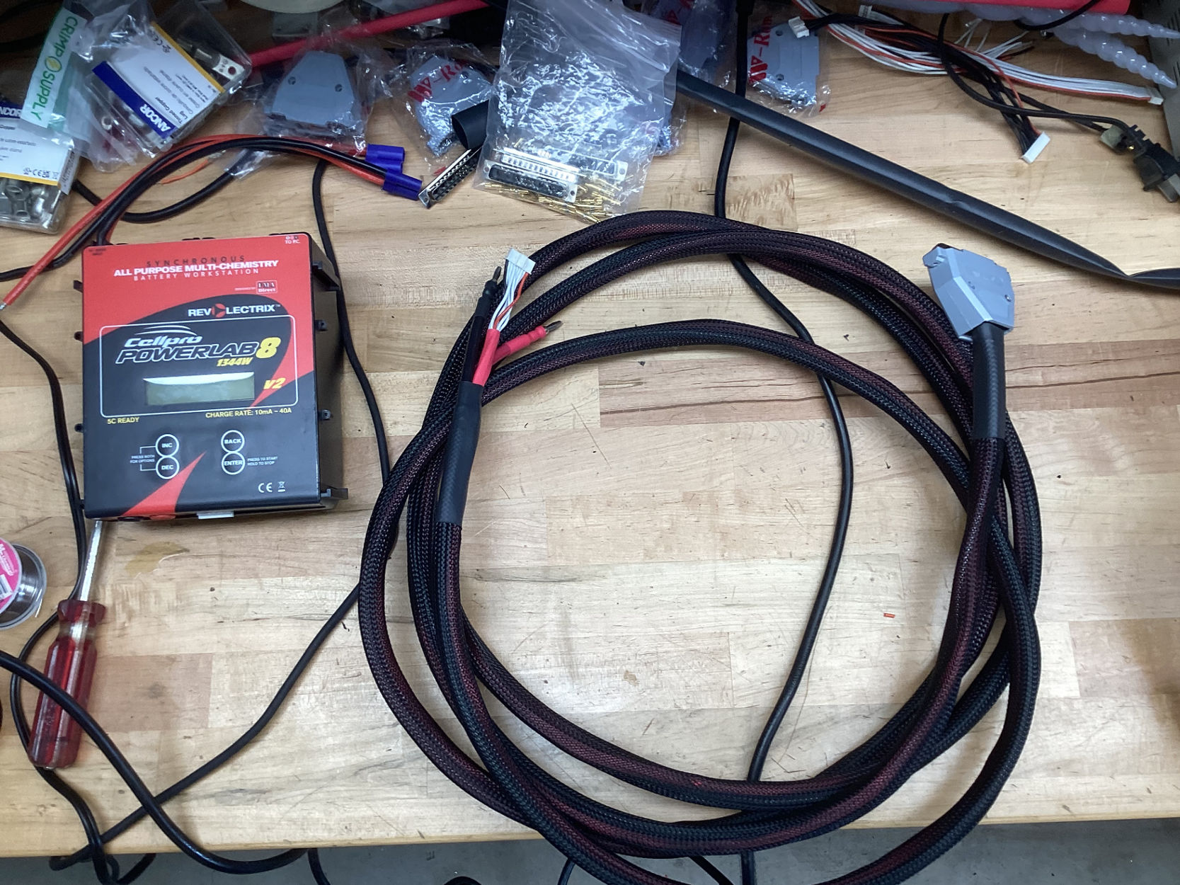

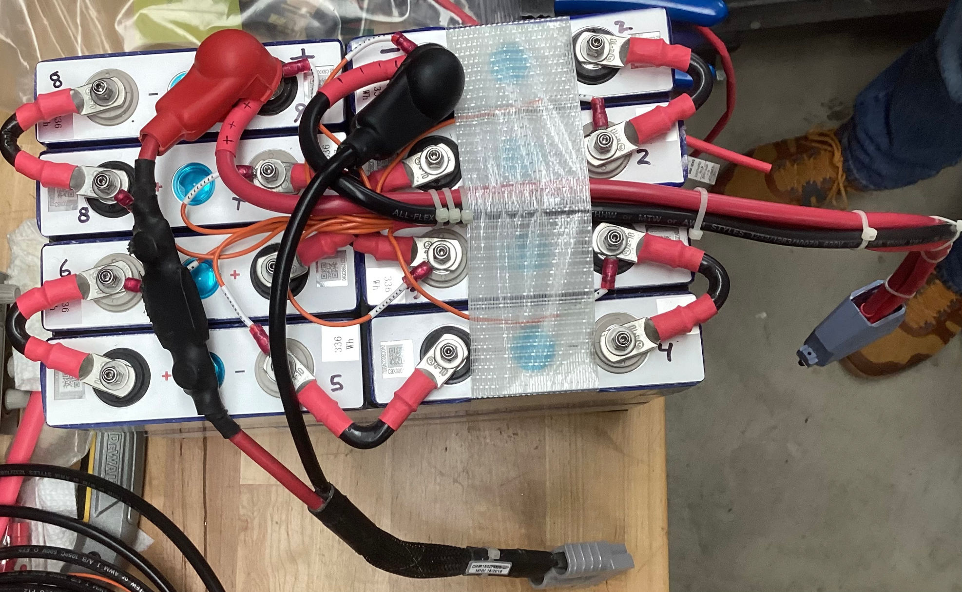

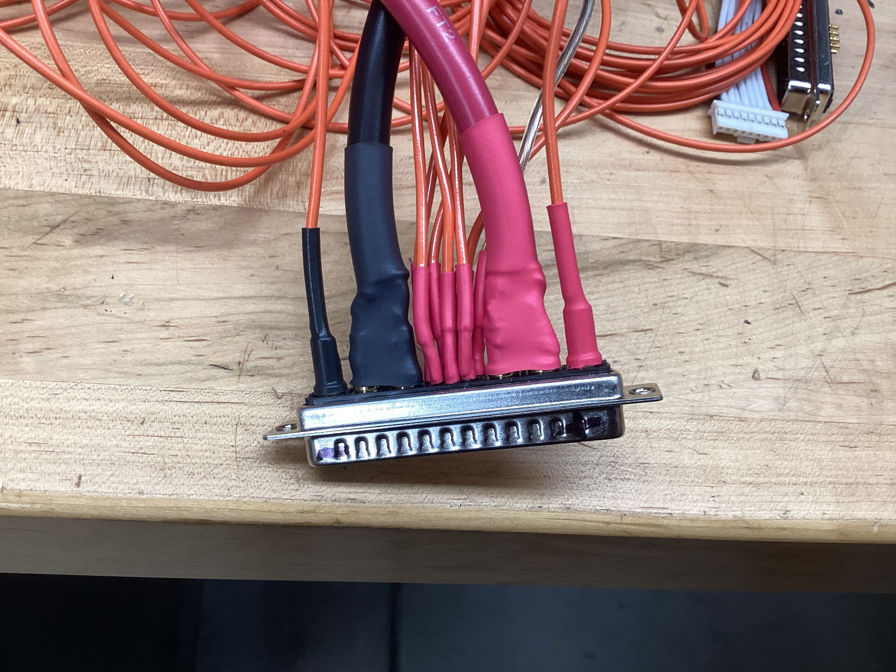

Postby UnicornBurner » 07 Jul 2023, 22:46
Progress!
We made our first pack and are working on the cord end that will plug into the PL8. Thank you to you all for the helpful information and to Shirley for his assistance with the PL8s ZXDs and EVERYTHING else. :dance
Plug
Top
Side
UnicornBurner
Posts: 19
Joined: 19 Feb 2021, 18:43
Location: Oakland, CA
Postby UnicornBurner » 08 Jul 2023, 01:19
Cable is done. Charging time! Fingers crossed. :worship
UnicornBurner
Posts: 19
Postby Burgerman » 08 Jul 2023, 01:26
All connections on balance and power soldered?
All cells initially fully charged?
Using one of my presets?
All should charge and balance on first charge and ballance should be achieved withing a short while on all cells.
2nd charge after removing say 20 or 30Ah should charge and balance perfectly and CV stage should take 20 to 30 mins before ending. At 3.600V per cell.
Posts: 69932
Postby Burgerman » 08 Jul 2023, 01:40
One thing.
The connectors for the PL8 for the charge wires are going to a) melt. And possibly melt the PL8 outputs too. And b) fall out and touch. Which will short out the battery and cause smoke and worse...
You *must* use these intrinsically safe ones, and these have longer contact area than most other connectors and they can stand the 40A charge without problem. As used and recommended by the PL8 manufacturers. https://www.ebay.co.uk/itm/284977340763
