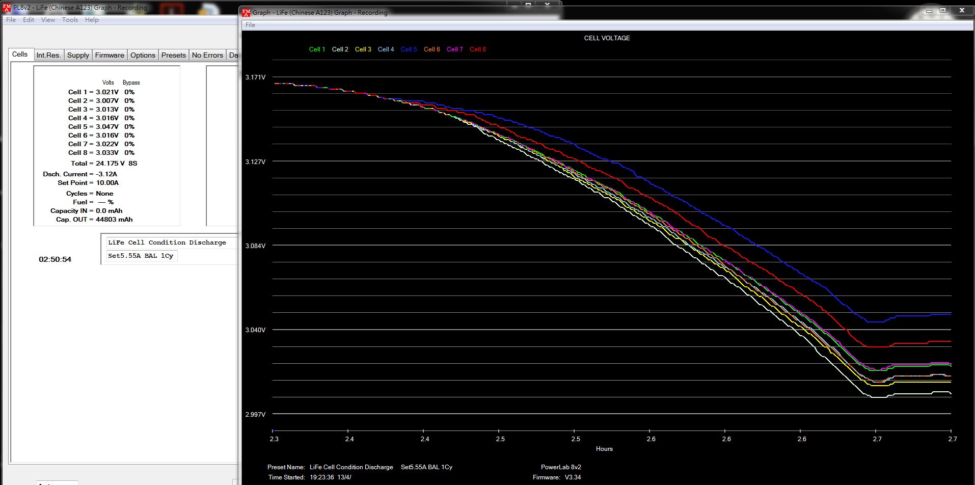

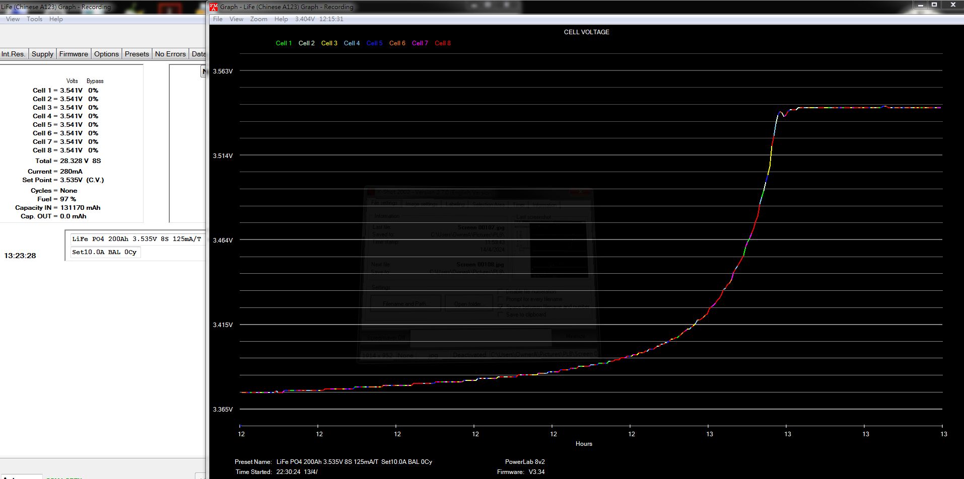

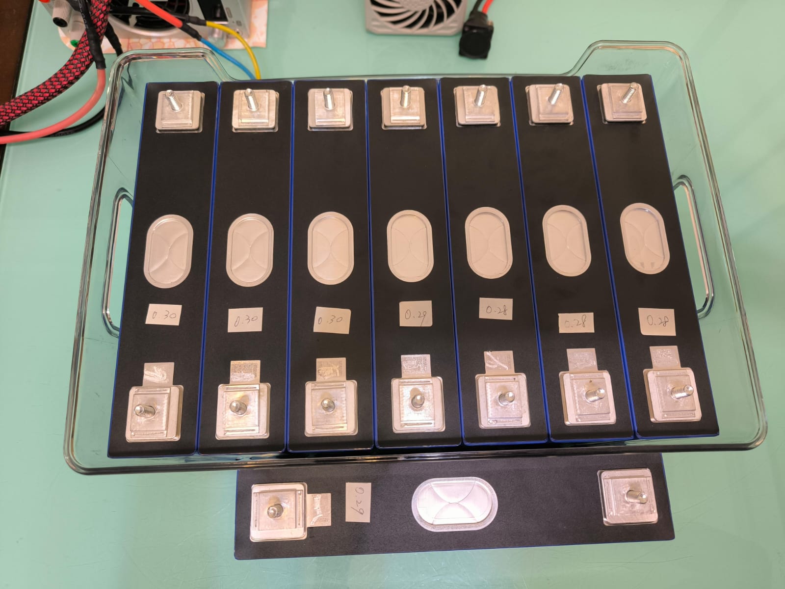

Bought some 130 Ah cells for a lady's Nutron RX51, replacing 22NF lead bricks.
Internal Resistance 0.28---0.30mΩ.
130Ah was recorded, and voltage difference was at the last 2,3 ah.
Put back 131Ah, and finished with nearly no dv at all. (I zoom in the last part of recharge)
LiFePO4 is cheap and high quality now. I paid £0.1279 for every Ah.
Postby Burgerman » 14 Apr 2024, 11:22
Those look pretty good.
Any link to the cells?
A 22NF gives a tiny amount of usable Ah. Around 25Ah until you actually grind to a halt.
So these wil bump that up to around 5X as much range as stock. Or 4x as much, but with a complete set of fully charged lead bricks left unused in reserve! :clap

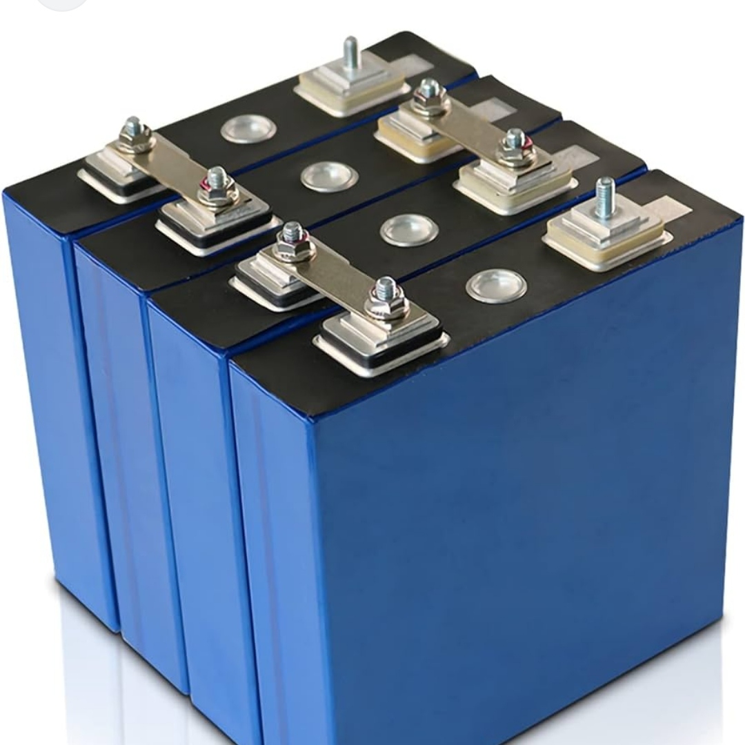

Postby steves1977uk » 25 Apr 2024, 19:52
Hi all,
I'm looking for some 230Ah Grade A cells for saker98's chair. He's letting me keep the EVE-LF105 ones which I can use in the Groove chair I'm rebuilding if I can get them to balance correctly. What's the best website to purchase genuine Grade A cells please.
Thanks,
Postby steves1977uk » 25 Apr 2024, 20:02
UnicornBurner wrote:Thank you BM for your observation about our ability to use 230ah batteries. We did not think they would fit, but low and behold the EVE 230ah do fit in our Jazzy/Quantum Q6 chair. And yes FJ, I did quickly ask my hubby to upgrade to 230ah.
Luckily the EVE 105ah did not go to waste, we were able to install them in a chair our friends use that takes U1 batteries. So if anyone out there uses the little chairs that take U1 batteries, the EVE 105ah will fit. You will need to make two packs of 4 EVE’s and an extended cable to connect them. It’s a tight fit, but a great lifep04 solution for small chairs.
Thanks you again to you all for your support and excellent observations. cheers
What are those M4 terminal connectors you have used please? I have the same cells here.

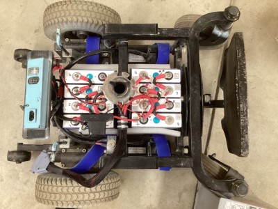

Postby UnicornBurner » 27 Apr 2024, 22:40
Hi Steve,
We used m4 X 16 set screws. The nuts are m4 locking nuts. The connecting wires are home made by us. The wire we used is #8 flexible battery cable and we soldered the terminals on and covered the solder joint with sharing wrap tube.
Is this what you were referring to? These were for our chair that uses U1 batteries and we converted to Eve 105ah.
