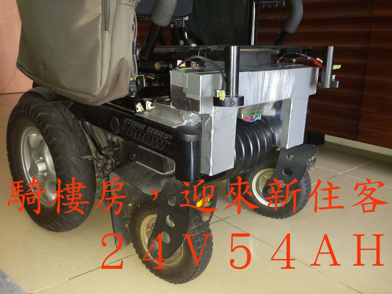

Postby shirley_hkg » 16 Aug 2015, 07:13
:D
Small cell form factors like 18650 / 26650 give flexibility to accomodate various battery compartment.
This pack is around the front shourd and above the casters. :lol:
Posts: 4656
