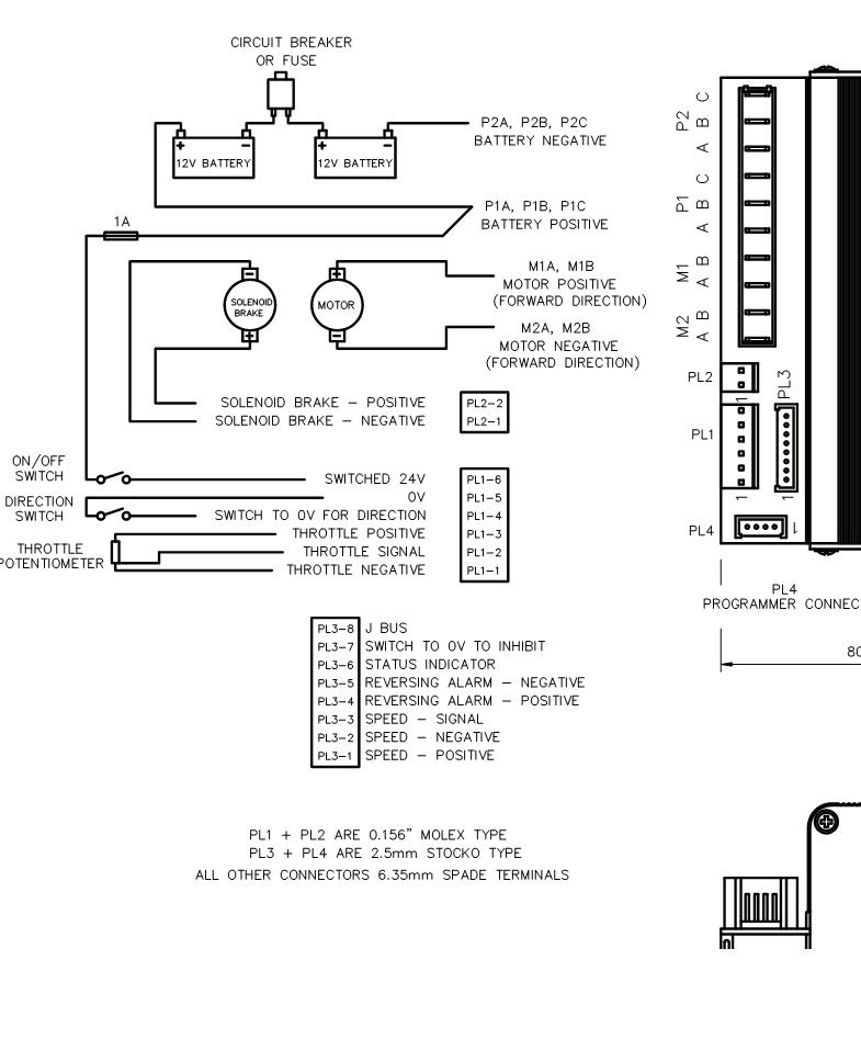

Postby Ralleygolfg60 » 14 Jun 2015, 22:40
Hello people I'm Richard from the Netherlands and looking for the oem version of the program to program a penny&Giles DT125 and maybe pin-out for the ftdi at the controllers sp1 connection for a DIY project all help would be appreciated
shoprider monza.JPG (37.05 KiB) Viewed 10885 times
Ralleygolfg60
Posts: 5
Joined: 14 Jun 2015, 22:21
Postby woodygb » 14 Jun 2015, 23:15
Hi Richard,
Unfortunately the Mobility programmer doesn't cover any of the scooter controllers other than the S-Drive ...SOLO , Egis etc are designated as Industrial controllers and require the Ind software.
http://support.pgdt.com/Customer-Servic ... -List.aspx
Industrial PC Programmer
Dealer D50390 & OEM D50391
Postby woodygb » 14 Jun 2015, 23:23
The PL4 connection.... if it's like the SOLO controller ... probably goes like this.
Pin 1 Positive
Pin 2 Negative
Pin 3 TX
Pin 4 RX
