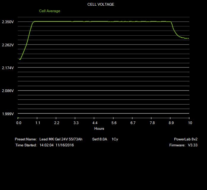

Here's what the charge volts look like w/ the PL8 look like. Held rock steady @28.22v during CV. I charged at 18A because I have too much stuff plugged into one circuit here at home. While not as long as a mobility charger, it still took some time before CV finished. I believe the current had fallen to .5A roughly by the time it was finished.

Thats what a CV stage is supposed to look like.
Wheres the Amp curve?

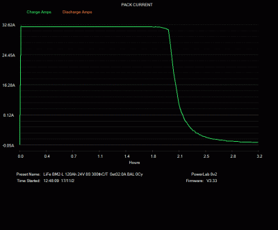

Heres one from a lithium...
You need to see that it isnt rising. It is obvious that those batteries are not new. Or the CV would have dropped below .5A and ended. As it is they ran the full 8 hour CV time limit.

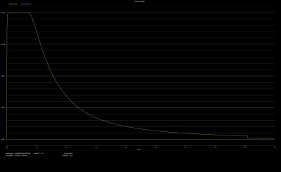

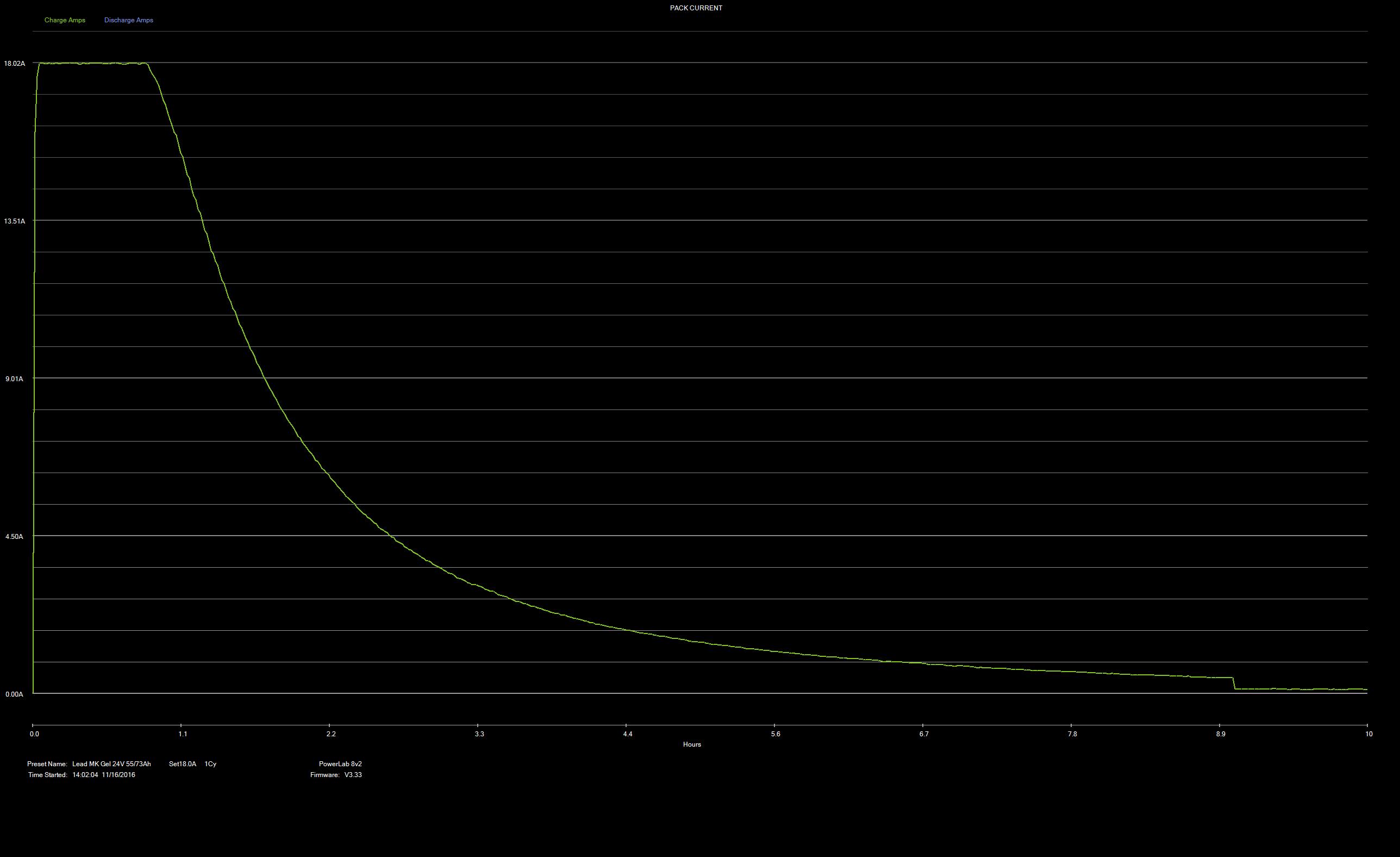

These batteries are off brand gel, not MK about 6 months old. Heres the amps graph of the charge.
Posts: 2121
Re: AGM & GEL BATTERY INFO for POWERCHAIRS
Postby Burgerman » 17 Nov 2016, 18:07
Was still dropping. Those are slow to charge. Probably high impedance. Its one of those batteries where the lights dim if you climb a ramp. It cant be charged fast. About 8mohm or more and tons of peukert. It may end charge better at a slower charge rate say 12A.
