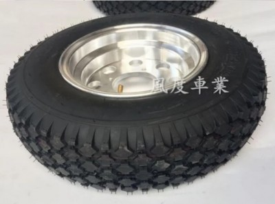

Postby shirley_hkg » 29 Jul 2018, 05:52
@ ex-Gooserider : seller replied it comes with 2.75'' rim . Good pick too .

Postby shirley_hkg » 01 Aug 2018, 09:39
@ $34.00 US

Postby hobie1dog » 01 Aug 2018, 17:26
Looks like right at 15 inches( John was correct again), thanks for the pictures too.

Re: 3.5" tubeless tires
Postby hobie1dog » 01 Aug 2018, 17:41
I thought that the 4.00-8 would have been taller than that :shifty:
Now that I enlarged the image to see that it wasn't a 3.50 tire.

Postby hobie1dog » 01 Aug 2018, 22:16
Just when I start comprehending things, then confusion sets in. In the pictures Shirley has, the bigger/fatter tires have 4.80/4.00-8 stamped on them. The picture with the tape measure show about 9 cm (3.5 inch) tall sidewall, or a 38-39cm od (15.35 inches). So wouldn't that make a 3.5+8+3.5=15 inch od tire? I'm just verifying computation as 38cm= 14.96" and 39cm = 15.35" as its hard to tell exactly what the reading is with the tape measure.
So Shirley, does this bigger 4.80/4.00-8 tire come on a 3.5 inch rim?
I noticed it has a load range C rating, wonder if the side walls are stiffer than a wedding night member? :shock:
