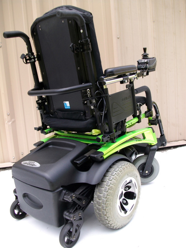

Postby expresso » 25 Nov 2015, 18:29
Chair is P222 se - motors are 8.5 mph - or at least close to that speed - thats what it rated for - but who knows -
pilot plus - 100 amp controller - batteries are MK GEL 24 - but i have the PC1500 in that chair at the moment - when they wear out - i will end up with MK GEL 24 there also -
i had the direct cable on both my chairs for a few years now - didnt have any issues - my chargers when i do fast charge - are 15 amp salmex and a 20 amp model - only 15 amp is Salmex which is set for the GEL settings - i use the other charger for the PC 1500 chair which is 28.8V
the fuse we are talking about is the fuse for the direct cable ? not the chair itself fuse which is from the factory ?
