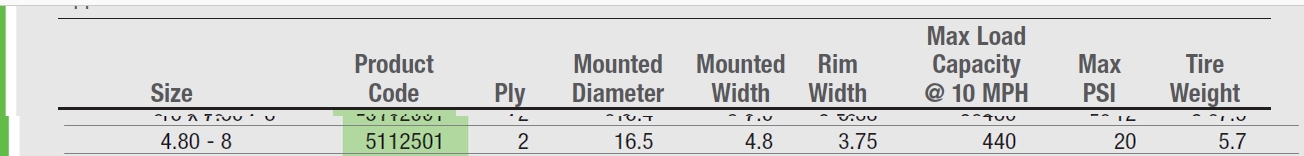

Buregerman is quite right that marked tire sizes are only nominal. For example, the Carlisle 4.80-8 Turf Saver tires on Rachi's chair show the following in the catalog:
Running at 5 psi, however, there's about 1" of squish.

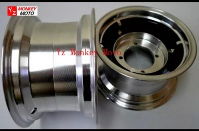

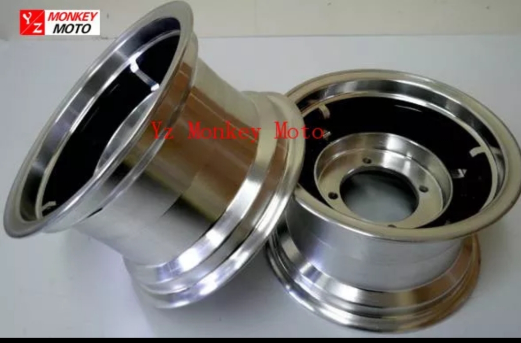

Postby shirley_hkg » 12 Aug 2018, 12:26
Tyre & rim look pretty nice , at 1/5 the cost .

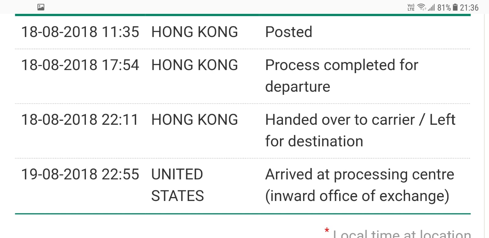

Postby shirley_hkg » 18 Aug 2018, 06:59
Damn .
Exceeded the 30kg limit by 600g . Have to throw away all the fillings.
Hope no DOA .
Posts: 4482
Re: 3.5" tubeless tires

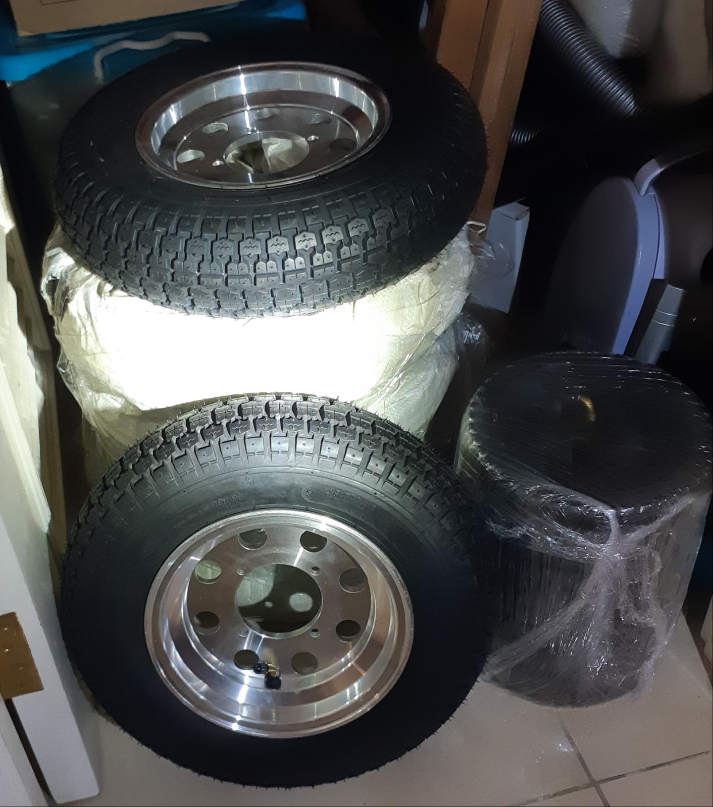

Postby shirley_hkg » 20 Aug 2018, 14:43
30kg load of rims & tyres arrive USA in the following day ..
Ready for delivery soon .
Posts: 4482

Postby ex-Gooserider » 11 Sep 2018, 06:20
Not sure who you were asking this? If me, I have been working more on the supply than the wheels, but I did look them over pretty carefully.
No signs of damage, and most of the finish was pretty good... From any sort of distance they look great....
If I wanted to be really picky, I could get annoyed that the edges on some of the holes weren't as well deburred as they could be, and the surface finish on the insides of the holes is a bit gnarly... I haven't tried measuring precisely (and don't plan to) but either the outside holes aren't all the exact same size, or the hole pattern isn't totally round and centered, as the distance between the curve where the center flange joints the rim and the edge of the holes varies a little... The most noticeable difference is the relative position of the valve stem compared to the holes... On two of the wheels, the stem is pretty much centered between the outer holes, on the other two, it is noticeably off to one side....
Ironically, I actually would have liked it better if the stem were in line with one of the holes... There is a big offset in the flange depth between the two sides of the wheel, and I suspect it would be easier to adapt if you could put the deep side to the inside (would move the tire in more) but that's the side the valve is on... There was some discussion about drilling a new valve hole to mount the stem on the narrow side, but I don't think there would be enough room... If the valve was in line with one of the holes, it looks like it would have been possible to spin it around 180* so it stuck through the hole to the narrow side.... (the surface finish is good enough that I'd have no worries about mounting with either side out...)
