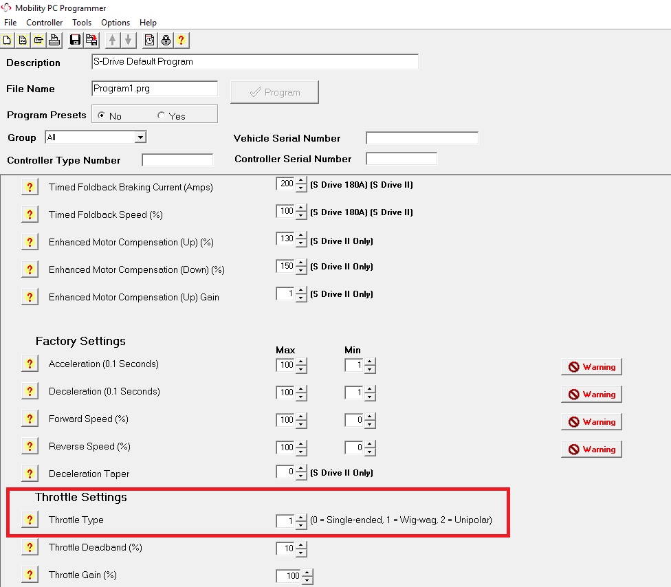

Postby woodygb » 12 Feb 2016, 15:30

Postby Cornishman » 12 Feb 2016, 15:41
Hi ,
Thanks for you screenshot. I am unable to get screens like that on my programme. The software is 1314-4401 as downloaded from this forum. Do I have the correct software?
Yours appear to be different software than mine.

Postby woodygb » 12 Feb 2016, 15:50
The software that your referring to is CURTIS ...the screenshot is Penny and Giles.
I'm very surprised that the Curtis software would read a Penny & Giles S-drive.
So ...lets start with either a pic of the controller or some reference numbers from it.

OK mystery solved ...together with some interesting findings about programming software "compatibilty".
You need the Software that I was using.
