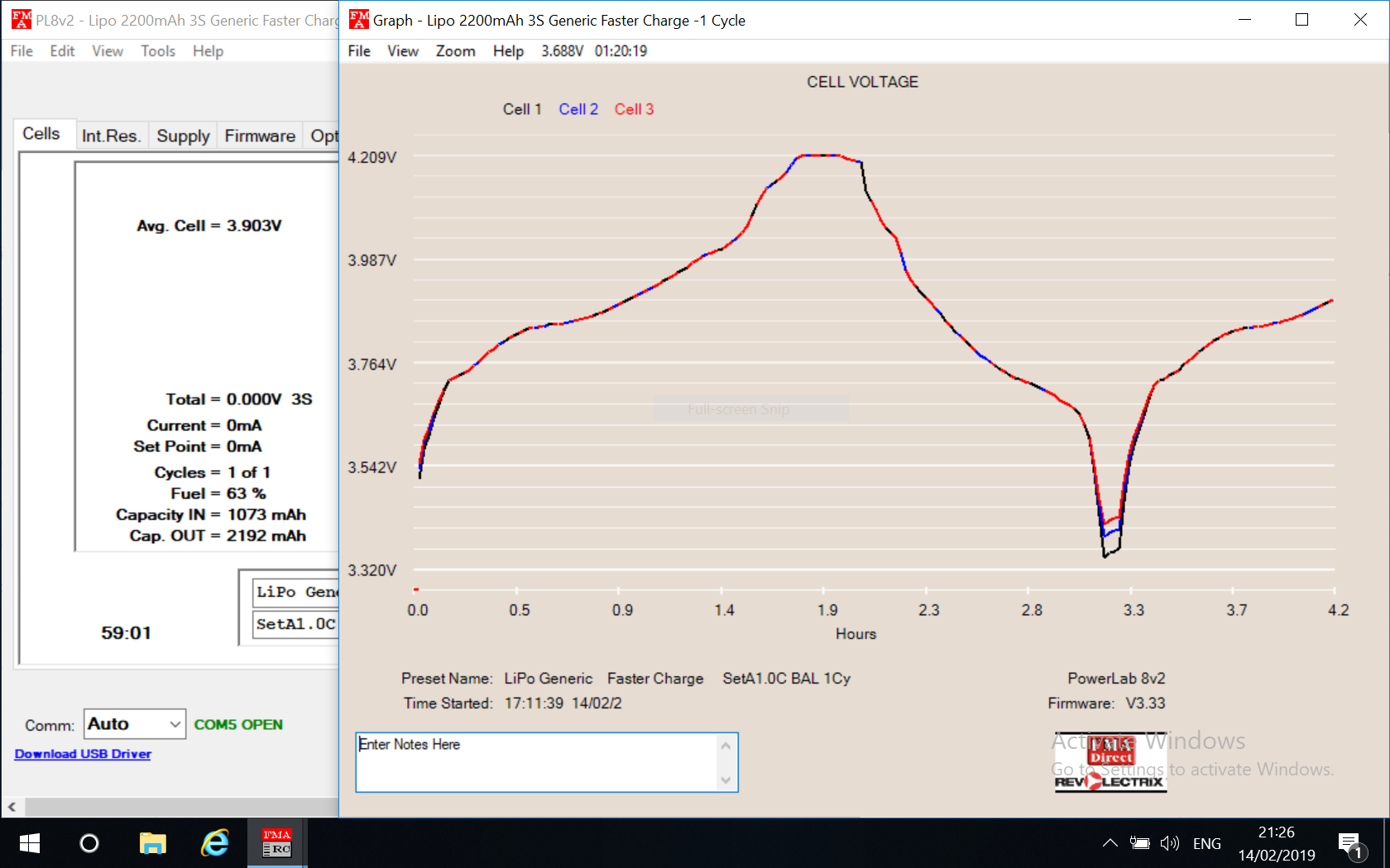

Postby Scooterman » 15 Feb 2019, 08:46
LIPO
Hi, I got a cheap lipo 2200mah 3S to play with. It is much better than the 600mah lifepo4 cells I bought.
This is the graph from using the PL8 generic lipo faster charge preset.
Lipo 2200mAh 3S Generic Faster Charge -1 Cycle.zip
(92.34 KiB) Downloaded 178 times
Two things I noticed...
1) CHARGING: The cells almost stayed entirely balanced during charge with out the need to bypass any current. In fact I only saw a low percentage bypass flick on and off very occasionally. Is that because as Shirley mentioned, lipo absorbs the charge current so greedily that the cell voltage doesn't rise at the same rate as it rises for higher resistance lifepo4 chemistry?
2) DISCHARGING: I expected the discharge voltage curve to remain flatter? Although some graphs I see on the web appear to be flatter than others. Is that due to the discharge rate being 2amps I.E. almost C/1? If I reduced the discharge rate I guess I'd get a flatter DV curve?

Postby Scooterman » 15 Feb 2019, 09:27
shirley_hkg wrote: You can adjust the current any time , via buttons on PL8, without stopping the process .
I didn't know that thank you
Postby Burgerman » 15 Feb 2019, 09:45
Lipo and lithium ion is not like Life, it doesent have a flat discharge curve. So is easy to charge, and fuel works, etc. One thing. Dont take below 3.5V or it will soon die. Lipos dont like low voltages. They are low resistance too. So charge to 4.200V and they stay there. No long CV needed. And they will exploe or burn if ypou charge higher than that so be careful, dont charge them unattended.
Posts: 71095
Postby Scooterman » 15 Feb 2019, 09:56
Burgerman wrote:Lipo and lithium ion is not like Life, it doesent have a flat discharge curve. So is easy to charge, and fuel works, etc. One thing. Dont take below 3.5V or it will soon die. Lipos dont like low voltages. They are low resistance too. So charge to 4.200V and they stay there. No long CV needed. And they will exploe or burn if ypou charge higher than that so be careful, dont charge them unattended.
By re-looking at the graph I see what you mean. There's no point letting the cell voltage fall off the cliff lower than about 3.65V looking at the graph, you don't gain anything and as you say it only shortens life of battery. I won't let that happen again :thumbup:
