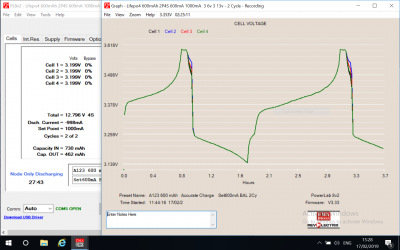

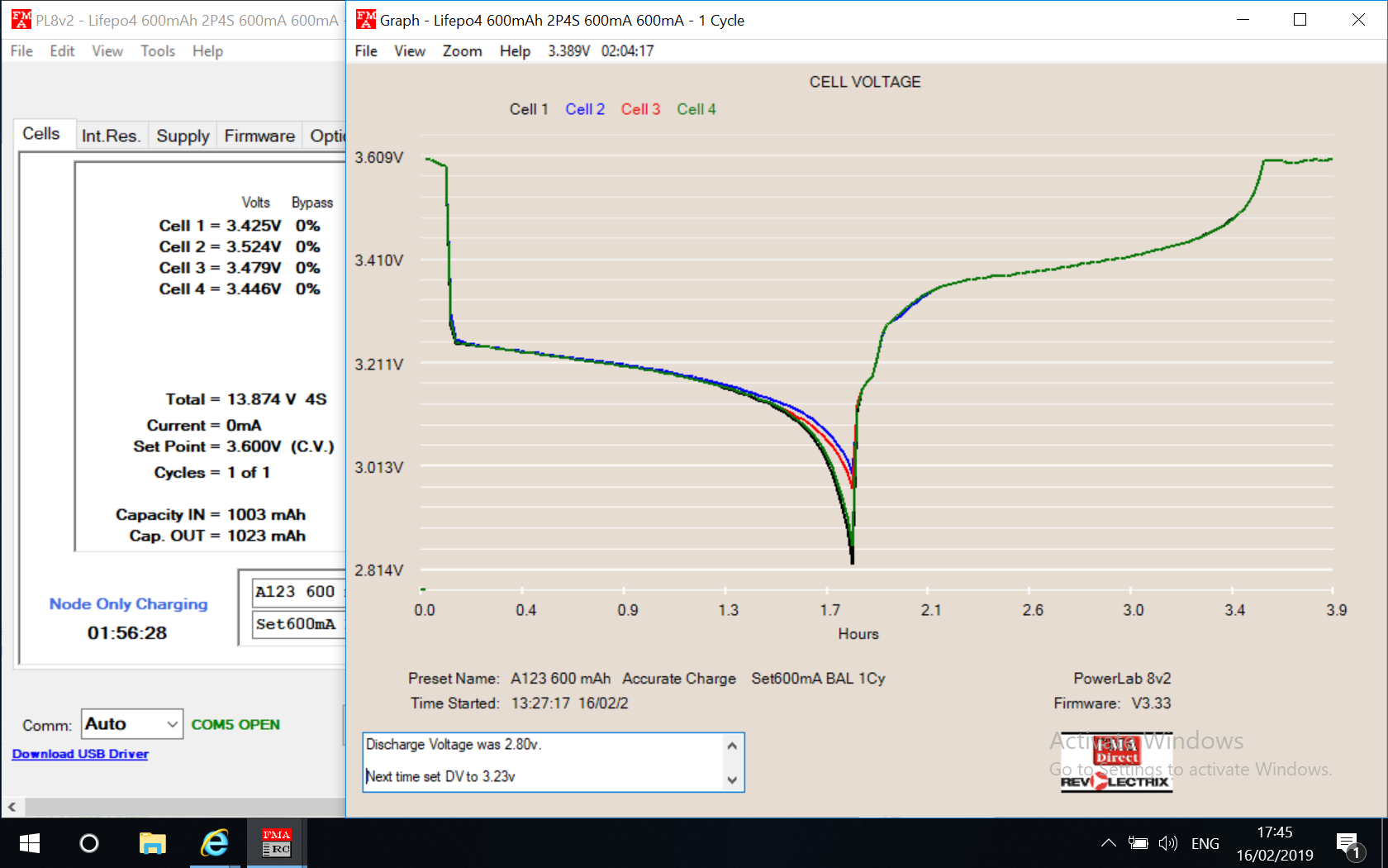

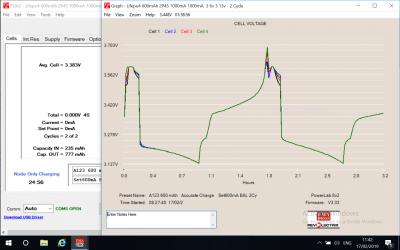

Postby Scooterman » 17 Feb 2019, 23:39
The first graph, which is the latest cycle is good :thumbup:
600mA Charge, 600mA Discharge, 3.13V DV
Although the CV stage only last about 5 mins, is this okay?
NB: 600mA lifepo4 connected in 2P4S
2.9V Discharge (Too low, deep discharge causes cells to go out of balance)
1000mA Charge. (Too high CC for the high resistance cells, causes voltage to spike)
Good Graph
Postby Burgerman » 18 Feb 2019, 00:30
On discharge those cells are not going out of balance as such, they are becoming empty at different times because their capacity varies. Also you are charging them way too fast, and discharging them way too fast, due to their internal resistance. Horrible cells...
Posts: 71095
Postby Scooterman » 18 Feb 2019, 09:26
Burgerman wrote:On discharge those cells are not going out of balance as such, they are becoming empty at different times because their capacity varies. .
Ah thanks! I guess the same is happening during the 5 min cool down period prior to discharge (first graph)
Burgerman wrote:Also you are charging them way too fast, and discharging them way too fast, due to their internal resistance. Horrible cells...
Understood :thumbup:
Also, generally for lithium is there a ratio between CC and CV you like to see?
E.G.
2/3rds of charge CC 1/3rd CV ?????

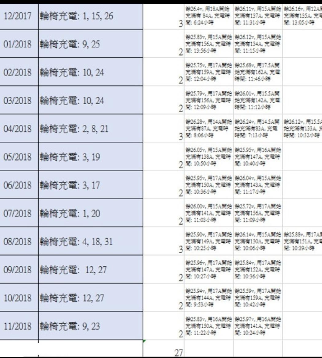

Postby shirley_hkg » 20 Feb 2019, 01:52
I built this guy a 140Ah pack with 40152 cells ,
together with a 60Ah add-on.
He recorded the recharge history . 27 charges throughout last year , with average 150Ah DOD .
He is thirty-ish . I told him his battery will live longer than him, but regret that he has no pleasure of lithium building … AGAIN
Posts: 4656
