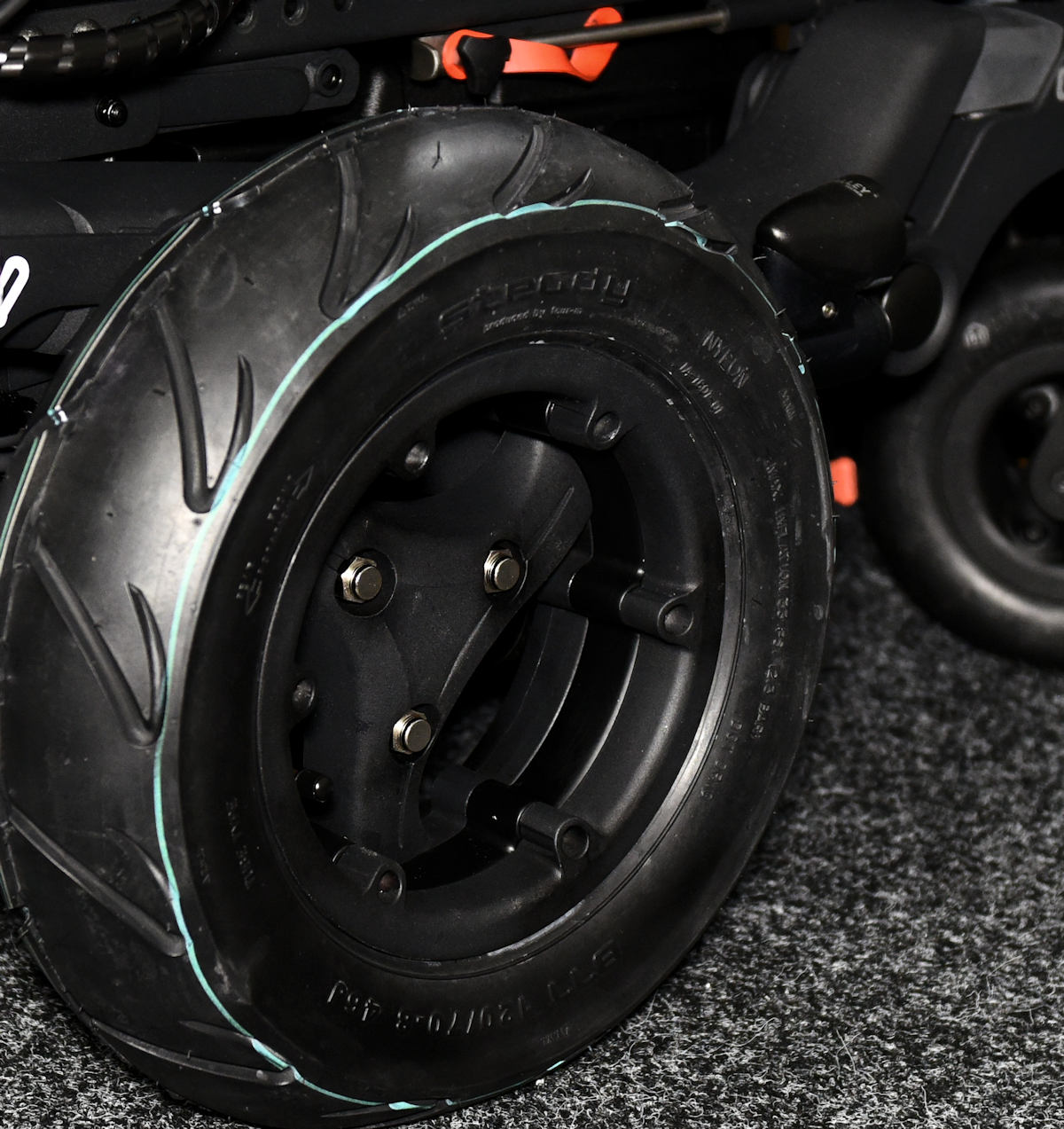

5. Widened the stock rims by 27mm to make them 75mm or 3 inches wide.
6. Fitted 120/70-8 "STEADY" tyres, and a puncture sealer filled 4.5 inch x 8 tube.
7. Fitted the complete wide wheel/tyre combo.

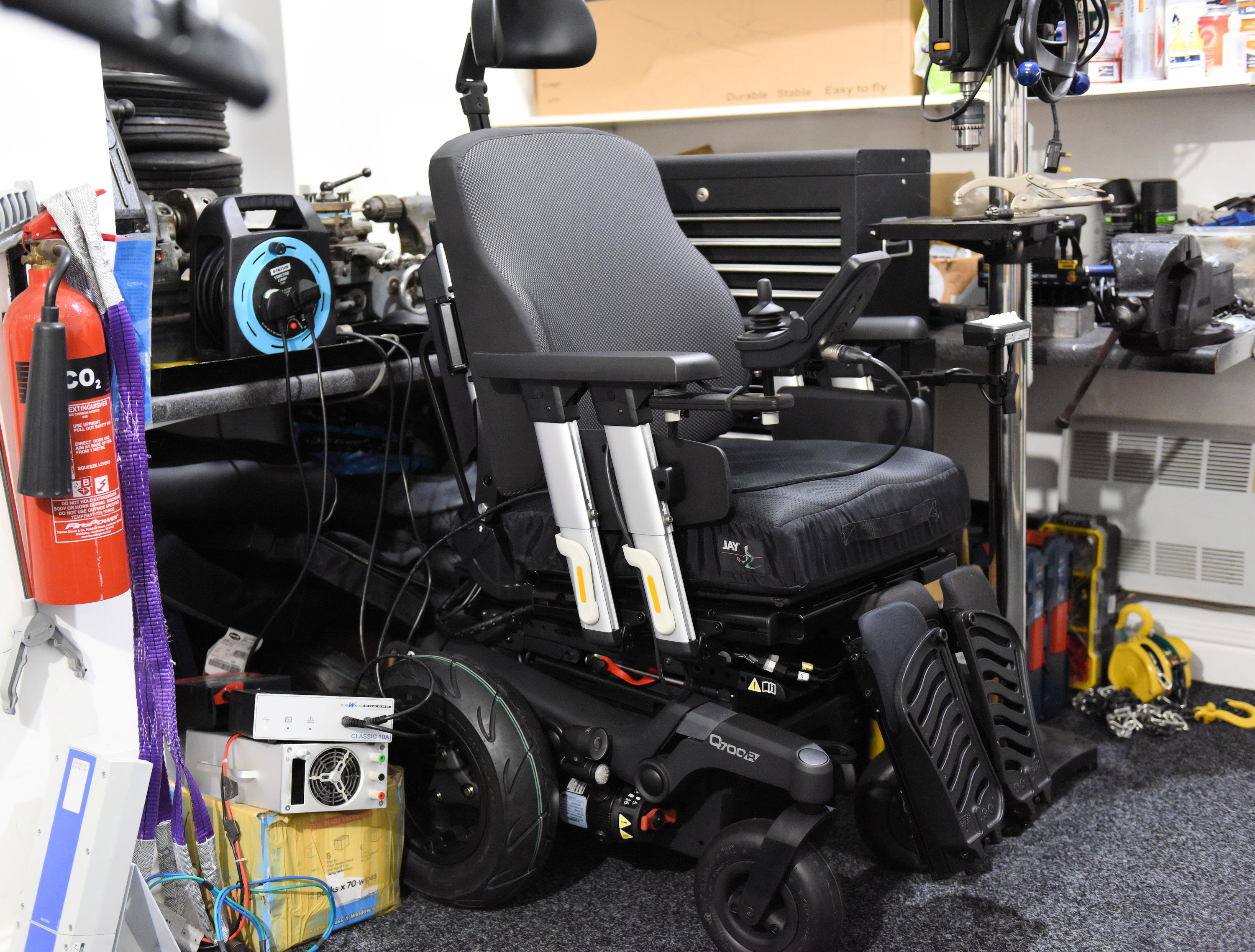

To keep up... The salsa is better in a number of ways. But the Q700R can be "fixed" relatively easily. And a picture is worth a thousand words. Please excuse the junk and all the wires hanging from the lathe at the rear...
3 inch wide turf caster tyres, smaller 8 inch diameter. So that the centre footplate can retract further back. Heels between casters without collisions. Allowing the seat to move to the rearmost mounting holes on the lift/tilt module base mount. This means a rear biased easy steering chair. And its shorter indoors.
On unequal alloy spacers under te seat to give a 6 degree rearward seat dump. This results in a real 4 degree dump. Because the chair it tilted forwards by 2 degrees. Because larger tyres rear, and smaller front, gives a -2 degree forward sloping lift/tilt module. Thats good. It moves CG fotwards when lifted. that gives a negative forwards -2 degree overall chair, with 4 degrees seat dump at lowest position. Just as I wanted it.
Black accents to replace the grey ones...
Rear wheel rims have a 26mm wide spacer band (a rim half from a JIVE chair) in the centre to make the rear wheels 3 inches wide. And allowing a 120/70-8 tough scooter tyre to be fitted. This makes the chair in total 4 inches wider than its 24.5 stock figure.
4 arm uprights! The arms on these chairs can be mounted on the backrest and lift up. Or single post swing back. Or single post removable. ALL these options are weak, wobbly and unsuitable for transfering or presure lifts. So now it 4 removable uprights! Now they dont wobble and bend. You have to swap left to right, so they len backwards, and it JUST all bolts together with only a tiny bit of modification. A round blob on the arm top underside must be ground off. Took 10 seconds. A major improvement in rigidity. Still easy to lift up and off as needed.
And a little reprogramming. And the joystick no longer wobbles side to side on those horrid mounts. Theres a bunch of rubber 40/12mm washers crushed under the arm and on top of the swingaway. So it is still to change position. It stays put!
Note the 10A charger. On the floor among other junk! Its also rubbish.
Wheel made wider for fatter tyres.

Tyres alone allows around 1/2 inch extra clearance. They are not that much smaller but everthing helps. But removing that tyre guard/mudguard/fender you aleady gained around an inch. So 1.5 inches total gain. Both changes together give you the ability to move that centre footplate rearwards by around an extra inch and a half, maybe more due to the castor wheel 45 degree angle.That reduces the legrest angle closer to the chair. And so allows the rearmost holes to be used on the seat lift mount. So it means that overall, the CG is moved to a more sensible position. Combined with some radical reprogramming it makes the damned thing steer properly! And results in a shorter chair that works better indoors.
Take a look at the picture. The seating with my 18x20 cushions allows you to sit well back and it shortens the chair and takes much of the load off the casters.
It does mean that when the lift and tilt and recline are used together its quite close to tipping backwards. So...
Its got another advantage. This lift sits you pretty high up. Adding the 120/70-8 or 110/80-8 rear tyres lifts the rear by a small amount, the 8 inch front tyres lowers the front by a small amount as well. That all means that the chair and its lift are sitting at around 1.5+ degrees forwards. So as the seat lifts high, it moves you and so the chairs CG forwards by around an inch. That inch makes a lot of difference just when its needed most. But this means the seat sits at a -1.5 to 2 degrees negative angle when tilt is sat in its most forward/lowest position. So I added spacers under the seat mount bolts, to give it a plus 4 degrees "dump" when at lowest tilt position. As can be seen in the pic. download/file.php?id=14804&mode=view
So a bunch of small changes makes everything works well together. All the changes complement each other. You end up with a more compact, more manoeverable smaller length better balanced chair where you sit further back, that steers properly.
