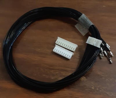

I went back and looked at the order and I need to open the pack of wires to separate them. I didn’t totally understand what he was shipping. The whole works might be there. I’ll check when I get home. Hope Shirley doesn’t get annoyed at me.

Well, I know I have a ZXD, two Pl8, a USB, three white connectors attached to a bunch of black wires, and a blue and yellow extension. Is that enough to charge two chairs?

Postby White Lightnin' » 11 Feb 2025, 05:13
I received three sets of charging wires, two sets 1 meter long, and one set 1.5 meter long. I'll have to see if I owe Shirley money or if we had a misunderstanding. The fact there are three sets made me wonder what was happening. Part of the fun as BM says.

Postby shirley_hkg » 11 Feb 2025, 12:34
You won't find the JST balance leads elsewhere, and you really need ONE spare.
You've paid what you get. cheers

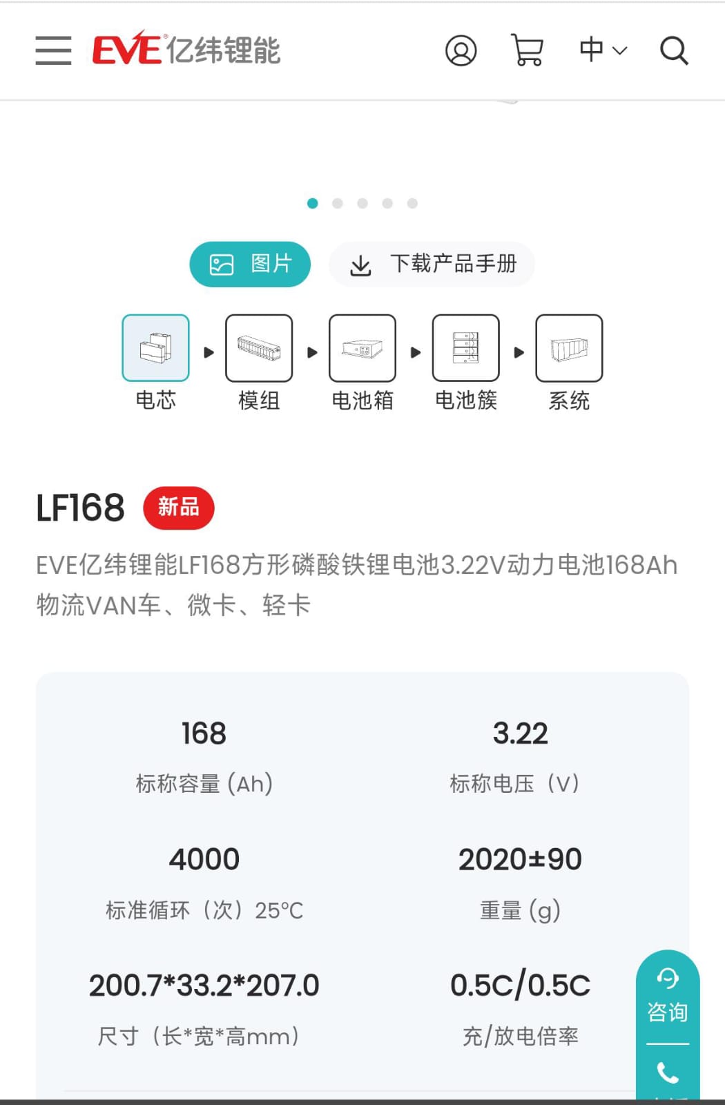

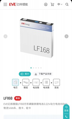

For those with shallow battery box, that don't want to settle for 100Ah cells neither , new LF168 cell is on shelf now .
Posts: 4653
Postby Burgerman » 17 Mar 2025, 08:46
But 200 wide? And only 0.5C?
Posts: 71037

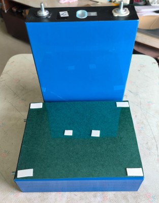

Postby shirley_hkg » 17 Mar 2025, 11:21
Lay on its side, and 200 mm will be the TOTAL height, that even Permobil F5 could fit.
It's 33.2 mm thick, so a row of 8 cells is only 266mm plus insulation.
280 x 225 x 203 (H)
What do you think.
Posts: 4653
Postby Burgerman » 17 Mar 2025, 11:27
I think I have a headache!
What about 0.5C or about 80A max. And at that level, maxed out, will have a much shortened service life.
And the fact that I can really take up to 240A peak from a battery? Not very often, but regularly over 150A plus. A turn in place on a brushless Invacare storm xplore chair for e.g took 190A at battery measured! Where 80 is maximum cell limit.
Thats peak of 2 to 3x more than they allow? :o
Posts: 71037
Postby shirley_hkg » 17 Mar 2025, 13:23
That are recommended C rates.
Intermittent rates are 2C charge / 3C discharge.
Website says it is for light trucks application.
May confirm with Docan.

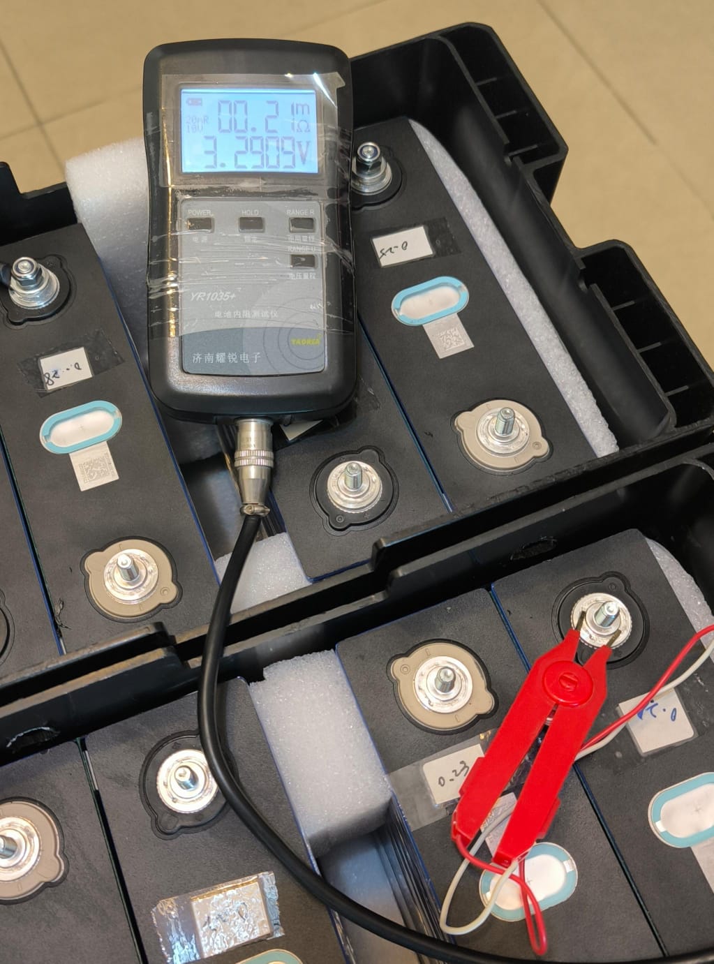

Amy send me very weak cells, what you think guys? All cells have high and weak 0.1-40-60-80 m0hm and one have 0.2-85 m0hm,
Weak
elryko1992
Posts: 413
Joined: 05 Aug 2016, 21:08
Location: Romania
Postby Burgerman » 25 Aug 2025, 19:19
Are you sure you measured them well?
All mine were 0.22 to 0.23mOhm.
Dirty contacts? 4 PIN CONNECTION?
Seems very different.
Do they look brand new, shiny clean, with completely flat sides?
If not then see what she says. Ask her for your specific manufacturer test sheet data. You need the details the numbers next to the laser etched sticker.

Postby elryko1992 » 25 Aug 2025, 19:26
Burgerman wrote:Are you sure you measured them well?
Yes i measure more times all the cells and 7 have 0.1+++ mΩ and 1 have 0.2-85mΩ. And i speak to Amy for the first time please send good cells to not have problem. Now i send message on whatsapp and email again, new cells or money back, i pay with paypal. Is not correct. I found Amy DOCAN from this thread, no one was have problem with them?

Postby elryko1992 » 25 Aug 2025, 19:29
No dirty, yes 4 pin yr1035+ and the cells packing very good NEW no problem. But all cells are weak why?
elryko1992
Posts: 413
Location: Romania
Postby Burgerman » 25 Aug 2025, 19:30
No problem, all from her were great.
What does this mean?
1 have 0.2-85mΩ.
0.2 is OK. Whats the 0.2-85 mean??
Do you mean ALL are higher than 0.25mOhm?
Or 1 is higher?
2.85mOhm is shown on the meter. Thats higher than the rest?
Posts: 71037
Postby elryko1992 » 25 Aug 2025, 19:33
Burgerman wrote:No problem, all from her were great.
1 have 0.2-85mΩ.
No is not good, your cells have 00.21-22 and all my cells have 0.140 or 0.183 and one have 0.285mΩ
elryko1992
Posts: 413
Location: Romania
Postby Burgerman » 25 Aug 2025, 19:42
0.140 or 0.183
Thats better than mine!
thats also super low, not quite as low as the rest. But nothing to worry about.
But your METER shows 2.85mOhm thats different to 0.285. So which is it?
To give some comparison here, that 0.285 still super low.
A bit of cable (wire) or a good connector is about that same level.
A brand new MK gel 74Ah battery is 4.5mOhm. Thats 16 times better than lead! So still super low.
Amy will think you are a bit mad. You are talking about a difference of a tiny fraction of an ohm...
Posts: 71037
Postby Burgerman » 25 Aug 2025, 19:50
Your cells are fine if they read ZERO point 15 to zero point 30 and are all at a similar voltage.
Thats 00.XXmOhms
If it reads 0X.XXmOhm thats TEN TIMES worse. You are confusing the two in your text. BUT Your meter shows 2.XXmOhm...
Posts: 71037
Postby elryko1992 » 25 Aug 2025, 19:51
0.140 or 0.183
So… you say i am wrong? Look to page 2 on this thread on your photos with measure and your have 00.22mΩ and mine have 0.285mΩ so mine is with + 1-2 not 00 like yours
