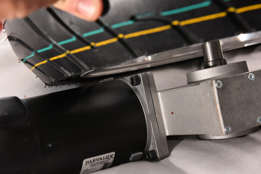

Postby Burgerman » 14 Nov 2015, 19:18
For those following this, the BM2 ends up at a fraction under 25 inches with those fat tyres, and with 7mm of running clearance between tyres and centre section.
That's 130 tyre, 7mm gap, 90mm motor, 175 wide centre section, and then another 90, 7, and 130mm.
629mm or 24.76mm overall tyre edge to tyre edge.
Even with these on it...
It could be 12mm narrower (half inch) , but I allowed 7mm clearance room to add the 145 wide and even lower profile tyres at a later date if needed.
If you do the maths, it means that I could build a narrow powerchair for a small person, child, that used stock powerchair 3 inch wide x 14 diameter tyres, and with full group 24 batteries, and still end up just 20 inches wide!!! And 37 long inc footplates/anti tips.

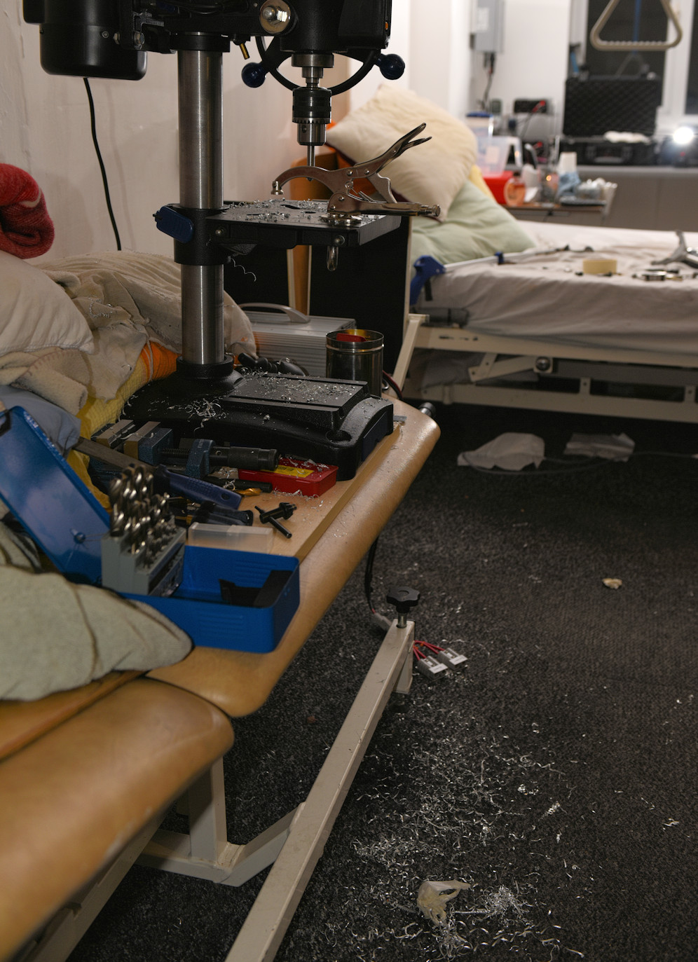

Postby Burgerman » 20 Nov 2015, 22:46
Just so you know, I am very thankful for my carers. I wouldn't be able to do any of this without a bit of volunteered help. Everything I touch falls on the floor. Everything I need is out of reach, too heavy, and not wheelchair friendly. And I cant clear up either. Too much spasm, and most of the time wasted running over things I have dropped or need to carry on. All I can say is its a good job I don't try to make a living doing this! I would send myself bankrupt. These simple wheel adapters took me about a week. I spend more time in the loo, or trapped running over stuff, or stuck because I cant do something than I ever do being productive.
So it will forever remain a very slow hobby. People harass me to build them powerchairs and they just don't get it... Its simply not possible.
Here's the state of my room after tonight. Even my bed is covered in swarf, and the floor, my tilt table, towels, and most of my tools/bolts/parts are all out of reach on the floor... Its so damned frustrating. But finally I have my wheel spacers done! And my drill works!
Room...

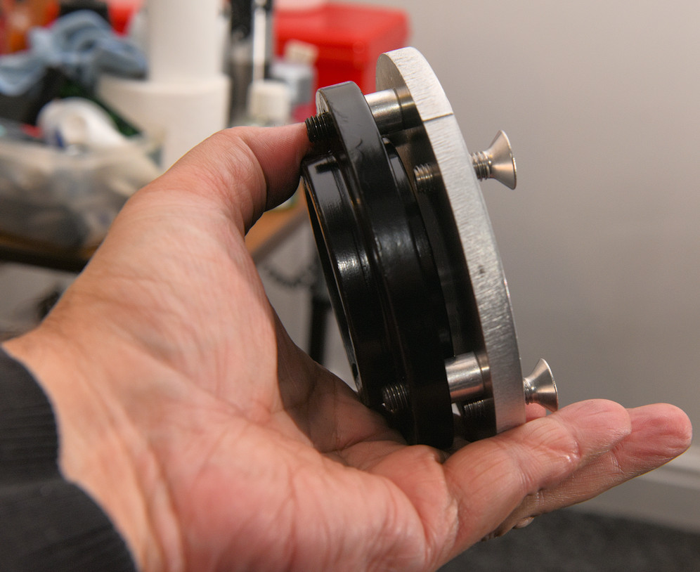

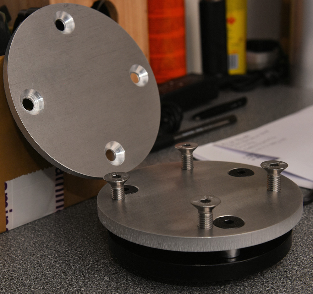

This is a 3 bolt wheel adapter (made originally for the cheap quad bike 145/70-6 wheel rims). Its an old pully, machined down, and has a taperlock centre.
To which I added:
3x skate wheel 8mm bore 10mm wide spacers. And an 8mm laser cut disk of 120mm diameter ordered online.
This alloy disk is drilled and countersunk for M8 bolts, to attach to the taperlock, with 3x M8 high tensile countersunk bolts to leave a flat finish.
Its also drilled to suit the alloy Monkey bike rims. So has 4x M8 tapped holes in the correct places for the wheel.
Its shown here sideways, attached to the taperlock pulley. And shown sat on the bench with another 8mm 120mm disk, that is the cover that will be seen on the wheel centre. So it will be polished to a mirror finish.

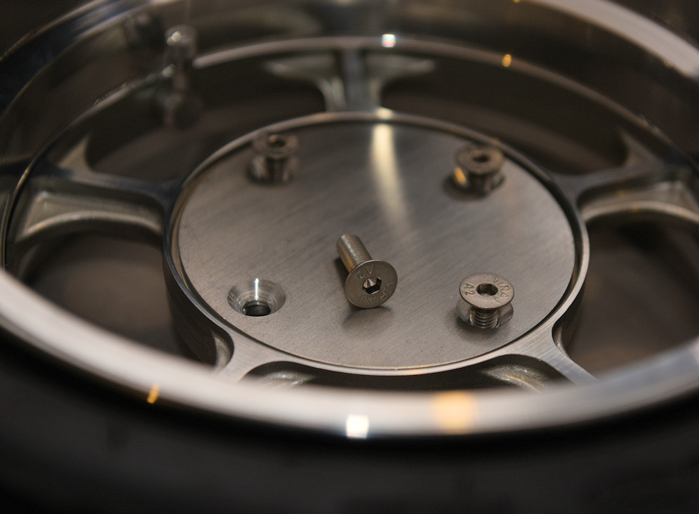

Re: Rebuild BM2 green...
Postby Burgerman » 20 Nov 2015, 22:54
On the wheel, but not yet polished up!
This took a LOT of extremely accurate marking out, and drilling, tapping, and countersinking. But is a perfect fit.
The same approach will allow anyone to fit any 6, 8, or 10 inch rim to almost any chair. And you can do it in a bedroom as long as you can get a volunteer and delegate no matter how disabled you are.
No reason to have hard, battery wasting solid tyres, or tubes. Fit tubeless!

Postby Burgerman » 21 Nov 2015, 14:45
Width of motor + wheel/tyre/7mm gap is 220mm
So 220, plus 220, plus 182 centre section with battery =
662mm wide total width. Or 24.44 inches...
Not bad for 130mm (5.25 inch wide tyres) with full sized Group 24, or 34, batteries... (Or lithium in mine obviously). And a TOTAL length of 40 inches inc a deep footplate and anti tips.
Those are better figures than *any* commercial chair, that has skinny tubed tyres...
The advantage of siting batteries north/south! :D
