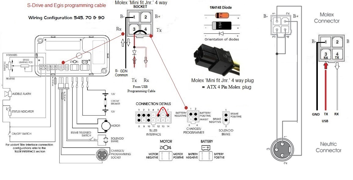

Wow and thank you for such a clear diagram. Since viewing this thread I have just ordered all the bits to make my own cable to re-program the S drive and maybe the solo drive if all goes to plan.
I see vik is having problems with a 200 amp controller hope I will not have the same issue. I will repost if I have successfully programmed mine
I just need the relative software if anyone can advise me. does the same software do both controllers?
Big thanks to woody and ntl99 for all the information provided

Vik wrote:Hi All,
Finally managed to get the 14.6.0 software talking to my S-drive 200Amp controller! using the Serial converter module I posted in a link above and mods as per above posts.
I did this by removing the 33k(47k) resistor altogether.
The process I used is as follows:
1 - Without anything connected to the 4-pin Molex plug on the controller, I turned on the controller, and checked the DC voltages available on pins 3 and 4 with a multimeter
2 - confirmed with a TTL logic probe that there were data pulses on those pins.
My reasoning was that because there is 5 volts supplied by the controller on pin 4 of the molex, when the controller is 'On' then there is no need for further voltage to be supplied via the resistor from the USB of the PC.
NOTE: I have only tried this on the S-drive 200Amp controller.
A huge thanks to Woody and Burgerman for providing this forum and those who share their knowledge and experiences here.

Postby Sherlock_holmes » 23 Mar 2020, 19:29
Well I have just been able to program my S drive 200amp unit. Thanks to Vik for his input.
Following Viks earlier post I was still unable to get the program to talk to the unit, until i changed the voltage
From 5 volts to 3.5 the comms became active imediatly
Thanks again to everyone :dance

Postby Gambera » 28 Apr 2020, 11:36
I'm Peter and I new in the forum.
I have a Kymko mobile with S-drive D51445.06. would you help me make the cable ? and what software do i need for programming? I have cable USB-RS232-WE-1800-BT_0.0
Thank you

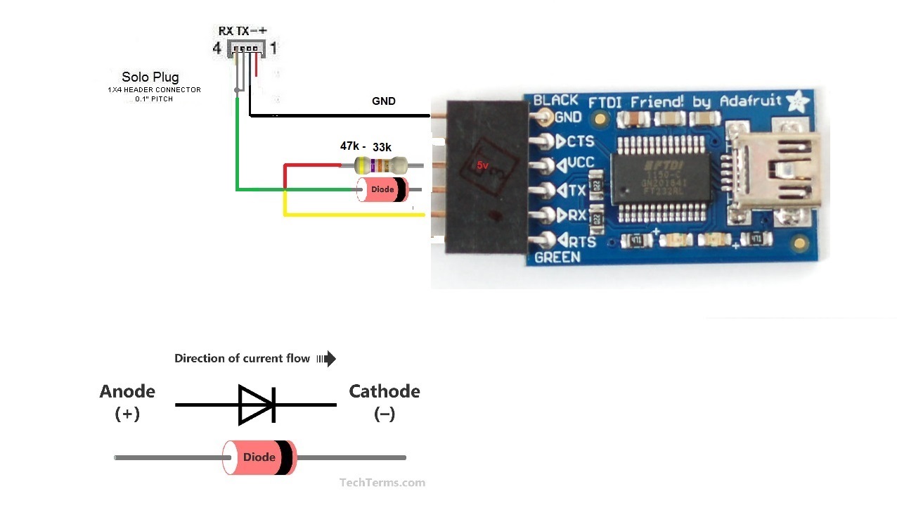

Try wiring up your lead as shown on the far right of this pic....we can try other methods if it doesn't work.
Remembering that the connection convention is RX < TX & TX > RX ...
NOTE:- THE CONTROLLER MUST BE SWITCHED ON FOR PROGRAMMING & YOU MUST TELL THE SOFTWARE THE COM PORT NUMBER ASSIGNED TO YOUR USB LEAD.
Re: Programming cable specifically for S-Drive controllers
Postby Gambera » 28 Apr 2020, 18:23
Thank You, Woodygb for your help
I have made the cable as in the first posting, with resistor and diode. the cabel is ftdi with 6 stipes.
now I connect to the Sdrive, Port Com2,115200 / 8 /1 but the programm says in the right corner, comms inactiv

FTDI Pic.
Note that I recommend a specific type from the F.T.D.I range.
Why not try direct connection as I suggested in my previous post?
You do not need to faff around with baud rates etc .
HAVE YOU TURNED THE CONTROLLER ON ?

woodygb wrote:Try wiring up your lead as shown on the far right of this pic....we can try other methods if it doesn't work.
With or without diode?
Direct cable?
Gambera
Posts: 6
Joined: 27 Apr 2020, 21:38
Postby woodygb » 29 Apr 2020, 12:12
Try direct with no diodes.

Hello everyone just wanted to ask you a quick question, i have a solo pg drives controller i made my own cable like the picture you guys posted , so i just wanted to know after connecting the programming socket to the controller i know i have to get the scooter turned on but do i need to add a positive 24 v wire to the number 1 pin on the programming socket or no, its a solo plug , really not sure dont wanna damage anything ,thanks for your help and time!
Khalid
Posts: 10
Joined: 14 May 2020, 01:00
Postby woodygb » 19 May 2020, 09:03
Leave the positive pin 1 of the programming socket alone.
To turn on the controller connect 24V+ to pin 5 of the 14 pin socket.
You will need the INDUSTRIAL Software to program the Solo.

Khalid wrote:Hey woody so i did everything as told but cant get the controller to connect to the laptop, i used this board i will attach a pic, and i have the oem program, i have the solo d50529/1 ,tried changing the com ports didnt work just this time i didnt get the cant open serial port message but still said comms inactive, used a 47 k resistor and a 1n4148 zener, what can be the problem?
Postby woodygb » 21 May 2020, 13:45
Check your messages for the SOLO programmer.
NOT the same board ...but you should be able to see the connections.

Postby Khalid » 21 May 2020, 20:10
I wired it just like in the photo, tried different usb cable, tried shortning the data cables, i have the oem programmer, tried different coms, i have the key on also, not really sure what i am missing here , is it a driver issue? But i dont think because in the device manager everything looks good , should i try a different resistor or something hope you can help me source this out.
Khalid
Posts: 10
Postby woodygb » 21 May 2020, 23:56
Use the industrial software.
Try by connecting direct from TX of the SOLO to RX of the board and from RX of the SOLO to TX of the board and GND TO GND......... No diode or resistor.
You might possibly have a fake FTDI Chip on the board.
