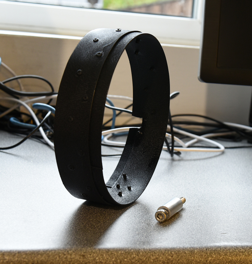

Burgerman wrote:Then order a strip of 1mm alloy sheet. Same width as the gap+ the indented smaller diameter part of the wheel cut to size, that is the same diameter as the indented part of the black drum, x pie, and bend in a circle. Use alloy brazing rods to join up, and then to attach to the spacers. To make a ring with spacers attached. You are done! Bolt on stock wider outer rim.
John
Any luck alloy brazing the rings you made for wheel centres on Brushless wheel mod.
If yes which make of rods did you use.
Re: New chair!
Postby Burgerman » 11 Mar 2017, 21:23
I riveted them...
Posts: 70441
Re: New chair!
Postby hank » 11 Mar 2017, 21:27
:lol: :lol: :lol:
If it works good enough.
Did you duck tape over joint.
Re: New chair!
Postby Burgerman » 11 Mar 2017, 21:41
Nope, sprayed 2 coats of black wrinkle paint, and fitted them. They are a perfect fit, don't look pretty but they are unseen.

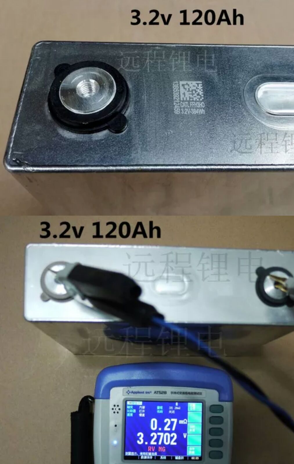

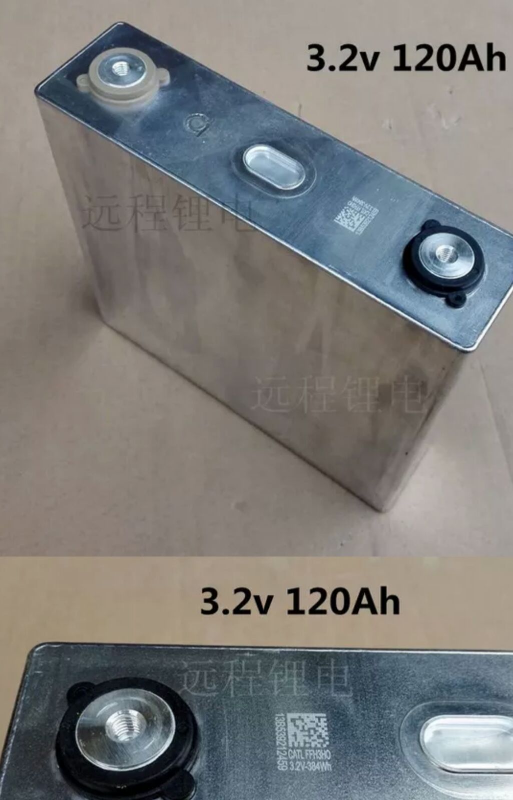

Burgerman wrote:http://www.sinopolybattery.com/main/prodetails.aspx?CID=10&ID=367
How can I get 8 of these?
Found this close clone .
Internal Resistance seems low , doesn't it ?
Price tag , @£45.00
Re: New chair!
Postby Burgerman » 10 May 2017, 09:49
Posts: 70441
Re: New chair!
Postby shirley_hkg » 10 May 2017, 11:56
Haven't you said that it had 346mm max ?
Then , it will take . 2 rows of 4 , whereas SINOPOLY is one row of 8 .
You did mention the space you have , but it's buried deeply out there .
