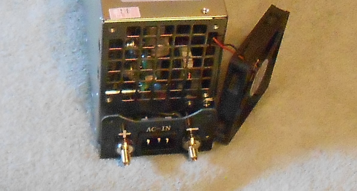

Postby Gnomatic » 29 May 2018, 16:53
Time for me to resume this project. I see how the new case fits together fairly easily. But I'm hesitant taking the one it came with off because I'm afraid I'll break something. I need to plow ahead anyway.
I know I won't be keeping all the bits on the back end anyway. But how do I remove them w/o busting them off. Or is that what I need to do?
Its the AC input bracket thingy that also has the DC output terminals. Whats the best way to remove?

Postby Burgerman » 29 May 2018, 19:24
Busting things off! :thumbdown: :oops:
No... EVERYTHING unscrews. Look under the case. 2 SQUARE HOLES. Two screws hold the main power wires. Undo those as well, and 110/240v wires from top and remove in a calm easy fashion! Seriously you wont break anything. The more you undo the better it gets. And the easier it becomes. Unplug and dissasemble everything.
Notes.
Before adding you new DC wires with ring terminals to the main output, fit them to the board. Leave over long. I used silicone, cables from ebay, in SWG 10. Because those two access holes are absent on the new case. I had to take apart again! :fencing I soldered the front connectors, only because, no ring terminals!
Add the new board mount standoffs just by looking inside the old case before you throw it away. Theres one unused, and one that needs two brass ones screwed together. The rest is meccanno!
You may need to fit 2 slim pot washers, when fitting the display or it will not line up properly. Other than that its a first time, 2 hour job. Inc fitting the anderson. The anderson has 4 wires. Supply from board, and the feed to the front 4mm connectors.

Postby Gnomatic » 29 May 2018, 19:48
Got the screws removed from the two square holes that led to the main power. Not sure where the AC input screws are. Front half of the case wants to come apart. Something still holding back of shell together.
Posts: 2123
Postby Burgerman » 29 May 2018, 19:54
On top of the top board... Unscrew everything. Cut the wires if you want, you throw all that away. But it does unscrew!
Posts: 70439
Postby Gnomatic » 29 May 2018, 20:04
Got the cover off! There was a screw I missed on the bavk end that was covered by a sticker! No busting things off! :thumbup:
Posts: 2123
Postby Burgerman » 29 May 2018, 20:16
Dont over analyse, take it all apart. Then assemble with loose screws everywhere while you rebuild 6 times as things click. Case sides short screws.Heatsinks longer screws. Oil the screws... And add power cables before adding board! Find 2 pot washers. Unplug LED board. Throw away the front fan screen... Dont rush, order terminals, cable, etc ebay and wait!
And stainless m4 countersunk screws, self tap into andersons perfectly. Ebay... About 12mm long?
Scroll viewtopic.php?f=2&t=7670&start=60
