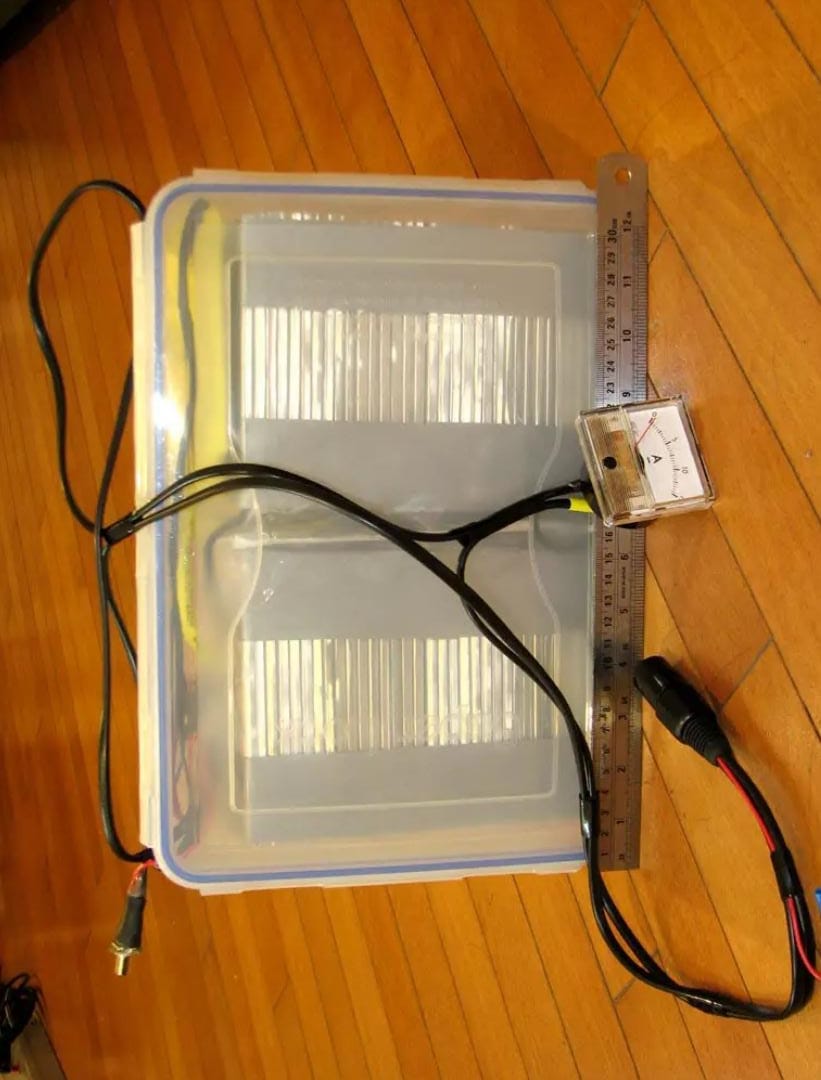

Wrapping it up - the Tape lenny suggested is the tape i used on top - i needed much less than i expected to use - and i decided not to over wrap the whole pack in this tape -
i feel its a bit overkill giving that it will sit in a plastic box with some foam padding on the sides etc, - i hope i never have to take this apart - it will be a nightmare trying to remove all the tape -
getting there - half assed but moving along --

i am getting near the end - wiring cable all done - box is done - i need to connect all my cabling and make the Charge Cable which is the most time consuming - i have to prep everything first maybe tomorrow and then try it on thursday - if all goes well - i should be testing it on the bench at least this weekend - if it passes -
then on the chair next week hopefully - to be honest - i am not crazy about the wiring connectors i made - the ring terminal and wiring thickness wasnt a good match - i made it work with some solder also - being an ADD ON and not going inside the chair - i let it go for now if it works - or else will redo better just the connectors
some more pics - you can see the size overall isnt that big -

Coming from a full pack 135ah chair to just an ADD ON Chair - i have to say - its very limited - i hope to gain a bit more with this 60ah instead of the 30ah thats on it now - if these Cells work out good - i would say if anyone is considering an ADD ON - make it 60ah at least - to make a difference -
Headways - the most i can fit in this space is 45ah - 3 Rows of 15ah Cells - - i only stopped at this 60ah cell because of the height - i wanted to be able to close it - or else i was even considering a 75ah cell i found which would have fitted perfect length wise - with no extending the box - but the height was higher - and of course a few more pounds also -
this was shipped to me at 28 pounds - so its about that weight when all done - not too bad - about 5 pounds over the headways - there were stated to be 5C constant - and 15C peak - IF those specs are true - who knows -
