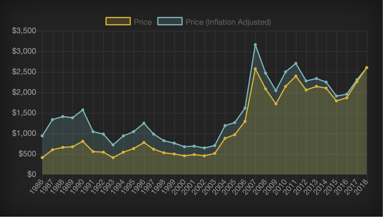

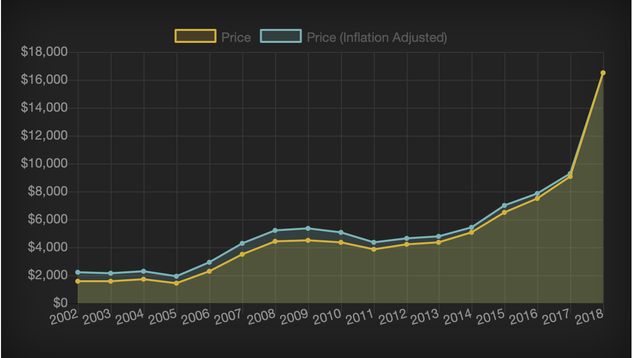

Postby Scooterman » 17 Nov 2018, 10:05
expresso wrote:thanks - well hard to know for sure what you get - i hope they are good now and for the long run - no way of knowing - all websites look great - and dealing with over seas - i dont see any other choice - nothing here in the States - even if they were - they would cost double - so we will still deal with China
I hope so too expresso :thumbup:
And I agree with you regarding buying from china being the only really viable option. There are no lifepo4 sellers, the nearest I've found is GWL in chezchovacia and they're almost twice the price for half the Ah as buying cells direct from china. And GWL cells are chinese anyway.
Also looking at the these two graphs I can't see the price of lithium coming down anytime soon.
lithium
lead
