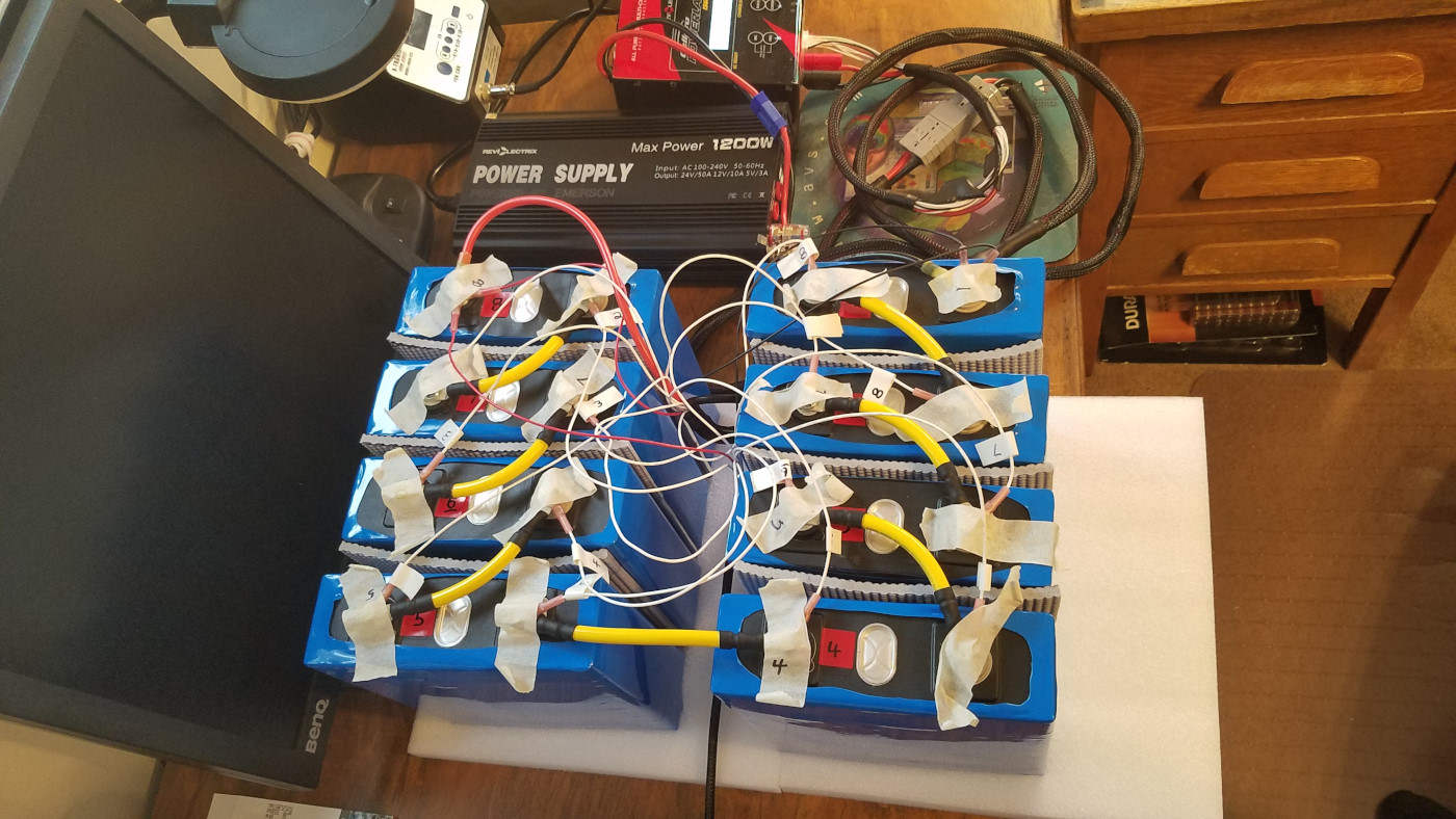

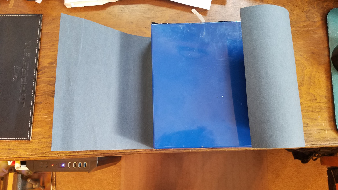

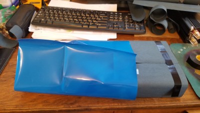

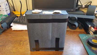

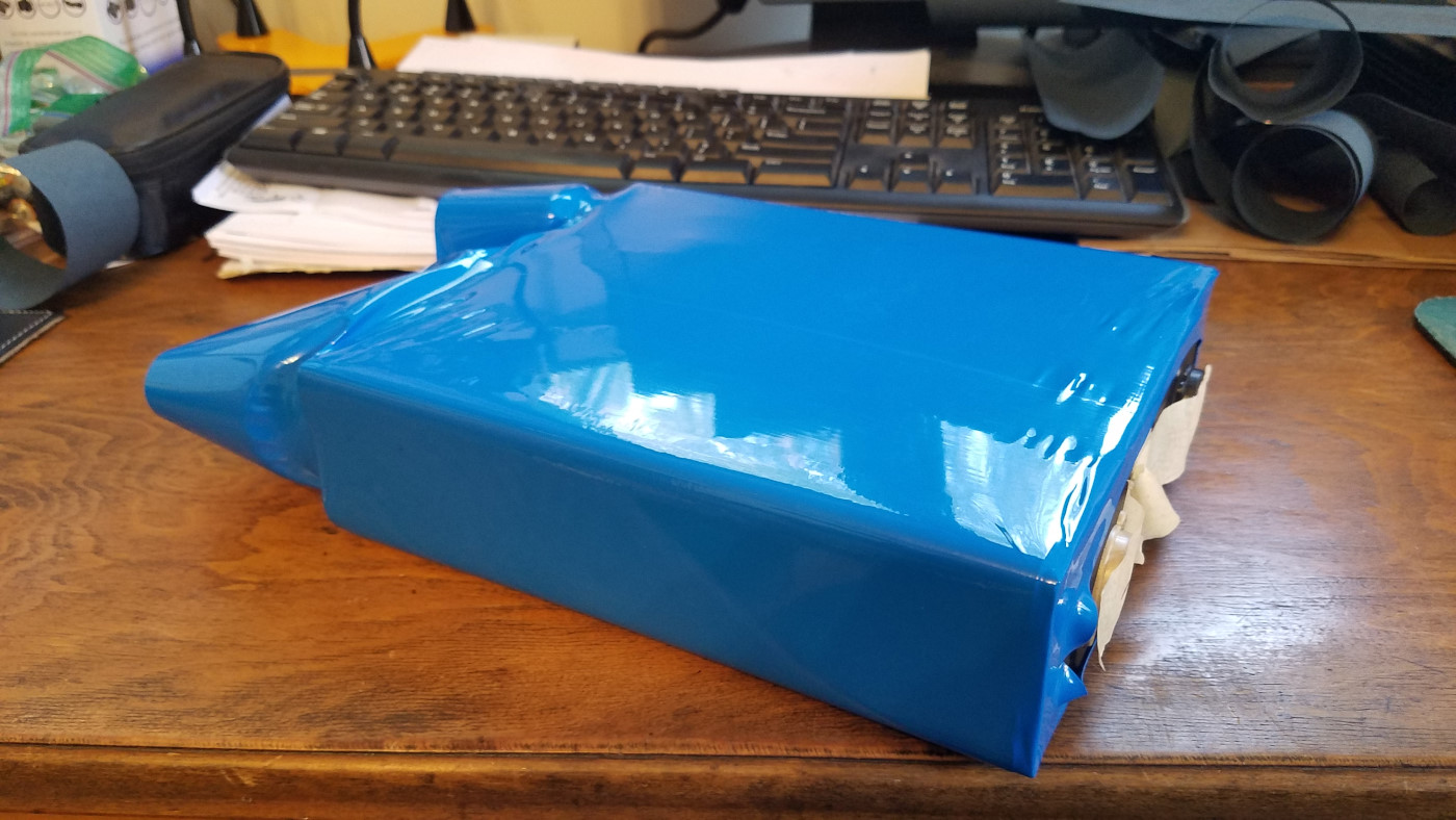

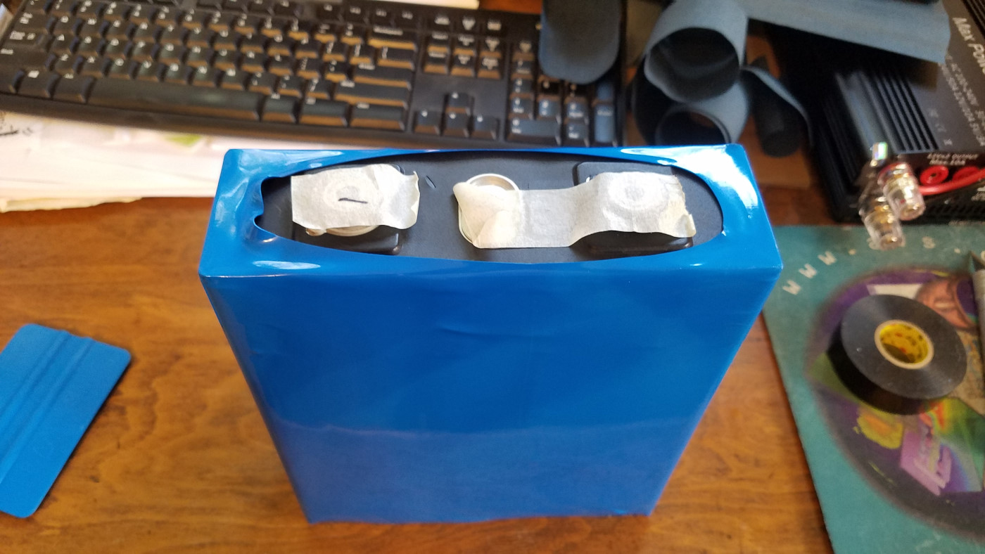

Now that the issue of the cells' condition has been resolved, it is time to get to work on building the battery pack.
I have charged each cell using the appropriate presets BM provided. I discharged each cell by 20 Ah for storage while the issue with the vendor was resolved. Once the resolution was in place, I charged each cell again and we started building up the battery pack.
We wrapped each cell in fish paper (electrically insulating paper) which was secured with electrical tape. We then encased each cell in PVC shrinkwrap.
After doing that, we built the wires needed to connect the cells together and assembled the cells in the the pack. There will be four cells on the right side and four cells on the left side of my wheelchair.
There is 5mm thick EVA foam between adjacent cells. This is non-conductive foam that is pretty compressible. It works great in accommodating the shape of the bulged cells.
I fully charged the battery pack (again, using the appropriate presets BM provided). I am now in the process of discharging the battery.
Here are some pictures to show what we have done so far.

that looks very nice - clean - they should ship them to us already wrapped this well to begin with
do you have a link to that fish paper ? does it have glue on it already - what size wiring did you use for those connections 6 awg ?
what size shrink wrap is that - ? came out perfect shrink wrapped
Re: Lithium Build for Magic Mobility X4
Postby swalker » 30 Mar 2019, 03:23
I bought the fish paper from digikey: https://www.digikey.com/product-detail/ ... -ND/257752
It was not self adhesive. I could not find a good source of self adhesive, so went with the regular stuff. I would have preferred self adhesive.
For the yellow connecting wire I used 6 AWG (13.3 mm2) tinned copper wire. I could not find any with silicone insulation, so used some with standard insulation.
I used Selterm tinned copper ring terminals for those connectors. Oddly enough, the 6 AWG Selterm ring terminal barrels were too large. Following their recommendation, I went down (up in number) a size to 8 AWG and those fit very well. I measured the diameter of the 6 AWG wire and it was the diameter it is supposed to be. Since the cells take 6mm bolts, I used 1/4 inch ring terminals. Life would be easier if we could just work in metric!
The shrink wrap is https://www.amazon.com/gp/product/B07FX ... UTF8&psc=1. It is 250mm wide (when flat) and 0.15mm thick. It is much thicker than the insulating material that was on the cells. We left the original insulation in place. That shrink wrap shrinks about 50% across the tube and around 15% along the length of the tube. It was easy to use with a heat gun. We used https://www.amazon.com/gp/product/B07FX ... UTF8&psc=1 for the heat gun.
I could not find a true AWG crimp tool for the connectors. I settled on https://www.amazon.com/gp/product/B00MV ... UTF8&psc=1, which did a great job of cutting and crimping the 6 AWG wire and 8 AWG terminals. We crimped first with the 16 (mm2) setting and then with the 10 (mm2) setting.

You've wired it up different to me. Maybe I will try your way if I can get my cells balancing together.
It's confusing me(not hard) the way you have wired the balance cables
Postby Gnomatic » 30 Mar 2019, 18:10
Looking good, swalker. That is some giant pvc heatshrink there! What size is that?
Posts: 2122
Postby swalker » 30 Mar 2019, 19:14
Terry2: I have two sets of 22 AWG wires, with 9 wires in each set.
The first set is for the balance cables. Those are connected to the positive terminal on all the "in between" cells (and the positive and negative of the entire battery pack at the end cells).
The second set is for the cell monitor. Those are connected to the negative terminal on all the "in between" cells (and the positive and negative of the entire battery pack at the end cells).
Gnomatic: The blue PVC shrink wrap is 250mm when unshrunk and flattened out. I got it here: https://www.amazon.com/gp/product/B07FX ... UTF8&psc=1. It is available in a variety of sizes, including larger sizes. It has a roughly 2:1 shrink ratio. It shrinks about 15% lengthwise, which took a bit of experimenting to figure out. The first cell we did got covered 3 times, the first two attempts being pretty laughable. Good thing that it came in a 10 ft roll.

How did you figure out/calculate that the flat 250mm heat shrink was the right size for your cells?
Posts: 2122
Postby Burgerman » 30 Mar 2019, 20:08
Presumably he measure right around, or added 2x width and 2x length.
E.G the cell is say 130 x 50 x height. So you just say 260 plus 100 x2? So you want one thats is bigger than 720mm circumference, or 360 wide. By as little as they have.
Posts: 69890
Postby swalker » 30 Mar 2019, 20:19
The PVC heat shrink tubing I bought is 250mm when flattened out (unshrunk). If formed into a cylinder, it would obviously have a circumference of 500mm.
The cells are 54mm thick x 173mm wide. So, I needed something that, when flattened out, was wider than 54+174 = 228mm. I figured that 250mm was large enough to easily go over the cells once the were wrapped in fish paper (the stuff I used is 0.010 inches thick). I thought 300mm would be too wide.
The shrink ratio across the tube is about 2:1 (48% to 50% shrink, per the specs). So, I could have used 300mm, for example, but I would have to do more shrinking. In my opinion, less shrinking is better.
2024 Permobil F5 Corpus 3G
2016 Permobil F5 Corpus 3G
2014 Permobil C500s VS
2013 Permobil C500 Corpus 3G
swalker
Posts: 575
Joined: 23 Jul 2018, 22:57
Location: Vail, Colorado, USA
Postby Gnomatic » 30 Mar 2019, 21:19
Well that's pretty straight forward and makes sense. Thanks. cheers
Posts: 2122
Postby Gnomatic » 30 Mar 2019, 21:35
swalker wrote:I bought the fish paper from digikey: https://www.digikey.com/product-detail/ ... -ND/257752
