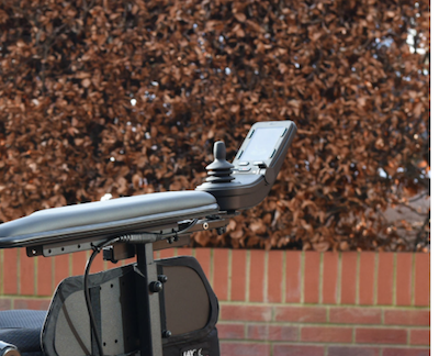

Lenny, wheelie junky, My joysticks allows that already - BT built in. And infra-red so I can control the TV in the pub! And my own, lights, etc. Built in. Elryko has many for sale. At a sensible price if you ask... I bought 2 for 125 each, although not from him as it happens...
BT and IR built in.
Screen Shot 2018-03-22 at 07.37.50.png (281.24 KiB) Viewed 12547 times

Wheras, the latest joystick with th BT built in can control all your devices. Just choose which from the memory on screen.
R-net Joystick Module CJSM2-BT
The next-generation R-net Joystick Modules set new standards in user-interfaces – not least from the inclusion of a large, high-resolution and modern LCD screen.
Integrated Bluetooth technology is an option, to enable control of computers, Android tablets, iPads, iPhones and other smart devices from a powerchair. Available Bluetooth devices are displayed in a menu on a large, high-resolution screen and joystick commands are used to select and operate the various devices. To switch between the devices, the user simply navigates the menu and selects the device they wish to control. The CJSM2 will seamlessly connect and reconnect between the available devices.

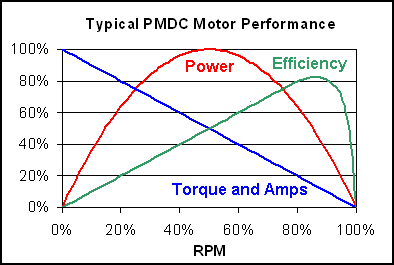

Postby Burgerman » 05 Jun 2019, 20:03
It doesent really. What actually matters is motor efficiency. And motor impedance.
A motor thats long and thin with the same design/etc with the same impedance will have the same POWER. But it may be higher RPM with less torque. Thats neither a good or a bad thing. It means that after the gearbox has translated this into the same roadspeed the torque or pushing force, at the road is the same.
Because torque x rpm = power (watts in this case - volts x amps).
So all else equal, a motor that takes 100A stalled at 24V, if geared for the same top speed (gear ratio, tyre diameter) will have the same torque AT THE WHEEL. Weather its 2 pole, 4 pole, thin, fat or indifferent.
Another way to think about this is this.
Take a 150BHP big heavy diesel engine that revs to just 3000 rpm in a truck. And replace it with a 150BHP bike engine, that needs to rev to 12,000 rpm but still makes 150HP. It makes 1/4 the torque at the motor BUT at 4x the RPM. Net result is the same power. Torque x rpm = power. And power is watts.
Now. You would THINK that the bike engine has less torque, and would not work in that truck. But you would be wrong. Because once you apply all the correct gearing, to make the trucks speed the same with both motors, the torque at the wheels is going to be identical. But the driver may go deaf. The truck would do the same hills. The same acceleration, the same top speed from the same power. And with 1/4 the engine torque.
The bike has 4x less torque. But spins 4x faster. So you need to reduce that to the same wheel speed by gearing it a lot, 4x lower. That increases torque by 4x. A gearbox is a torque multiplier.
Going back to electric motors. You only need to know the stall current (all else equal) to determine performance at any given roadspeed. It lets you draw a graph like this: Its the same for every DC motor.
