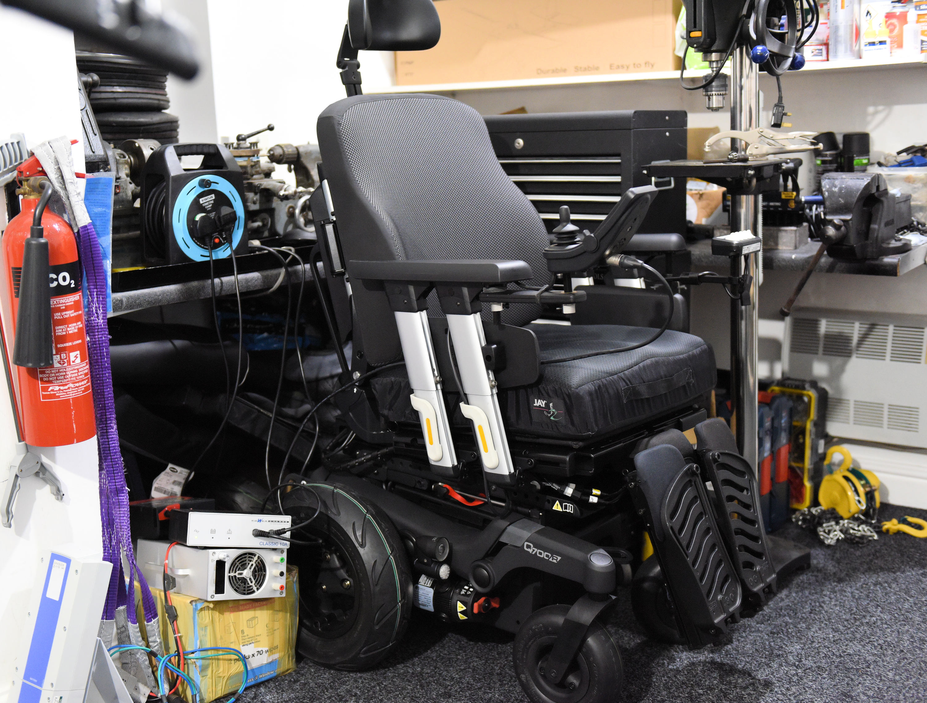

Maybe those 8 inch x 3 inch wide "smooth" tyres I used on that q700r will give him a couple of inches extra.

The smooth caster tyres are 8x 3.00 - 4 and thats what I meant. Those are 2 inches smaller diameter giving the ability to move the footplate back.
Thats 8 diameter, 3 wide, fits a 4 inch caster rim (or: 8x 3.00 - 4) https://www.terraintyres.co.uk/turf-law ... mooth.html
The 3.00 x 8 are the rear tyres. Although mine are 120/70-8.
My bad, I thought you meant the smooth castors then noticed you'd put 3.00-8.
Kenda 8x3.00 - 4 caster tyres. 2 inches more footrest clearance.

Its fine even without dropping the rear with a removed spacer. Its not a huge difference. The tyre may be 2 inches smaller but the front sits 1 inch lower. You can usually adjust the suspension to have a little less preload (height) at the rear if it really needs it. Those tyres - esp the carlisle branded ones are very tough. Probably a good candidate for not getting a puncture. But will give a harsher ride that the 10 inch ones you have.
Take a look at the pic of the q700r above. That has bigger rear tyres AND smaller front ones. Its not had any suspension changes or spacers moved or anything. Yes it leans forwards a fraction (maybe 2 degrees?) like a dragster! Its not critical at all. Works just fine.
