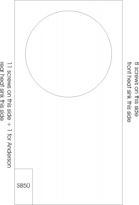

If you move the Anderson out by the thickness of the back panel the (slightly smaller) cutout will be hidden by the Anderson and only one screw is needed as the back panel locks the connector in place.

I had plenty of room for mounting the Anderson, but given my not so neat cutting ability I preferred to have the Anderson hide the cutout.

Fair enough. But what I am getting at is that there must be 2 ways that the case/board can be assembled as mine is like a mirror image of yours. The side with fewer screws is opposite to yours, also has the anderson, and that anderson is on the same side in both cases. (the left looking from the rear. And my board and stand offs are all on the opposite side to the anderson. The right looking from the rear. And that also means no stretched wires to the display/control board. As the internals have to be the other way up!
So you can build a lefty or a righty from the same bits! Not that it makes a difference when assembled.

I hadn't posted any pics of mine, but here's a sketch.
The side with the Anderson has the posts for mounting the circuit board.
Posts: 5771
