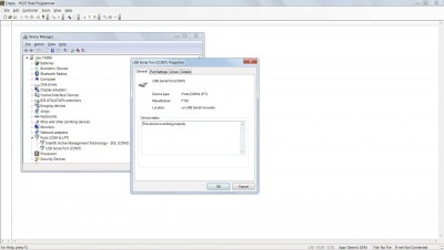

Your wiring seems correct ....
Postby woodygb » 14 Jun 2017, 00:36
Device manager says that the cable drivers installed correctly?
You have checked that the Com Port assigned by Windows to the USB Cable is between 1 and 8 inclusive? ...
The programming software lets you select the Com Port assigned to the cable.?
Postby ejf » 14 Jun 2017, 02:12
HOWEVER, I do not know how to set the COM port in the software!
(I assumed it just looked through the first 8 for a suitable target.)
What's the secret to setting the COM port in the software?

Postby Burgerman » 14 Jun 2017, 02:25
top menu, then options>comms opens a box...
Posts: 70469
Postby woodygb » 14 Jun 2017, 02:37
...Yup ...YOU have to select Comms port number.
If the software is complaining ... Unable to open Serial port ...then it's more than likely a port number mismatch.
Postby ejf » 14 Jun 2017, 02:45
Hmm. This (above) is the program I'm trying to use. Maybe it will not work with a VR2 controller...?

Postby rover220 » 14 Jun 2017, 07:23
That's for rnet not Vr2

Postby steves1977uk » 14 Jun 2017, 10:55
As rover said, that's the completely wrong software you're trying to use. You need the Mobility PC Programmer software for the VR2.
Postby ejf » 14 Jun 2017, 17:08
OK. I obviously had the wrong software.
Thanks for all of the super help.
I will probably start a new thread in the near future to gather up my results. (From a newbie point of view, the very valuable information that I used was a little bit too dispersed in such a a long discussion thread.) But let me know if I'm potentially violating protocol...

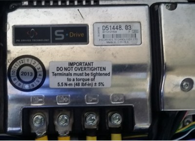

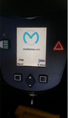

Hello everyone,
I've found my way here via the "Everything Powerchair" thread. My problem is the "Throttled to PPP" post. My medema minicrosser M2 has had it's programming altered to Medema "company policy" according to the dealer. The dealer is sticking to the its policy line and I've run out of patience and money This has lead to it being slow (max 6mph), sluggish generally an usable liability. I use my Salsa M chair but to enjoy outdoor family life I need the off-road ability.
It has a LCD tiller which used to have a inclinometer and thermometer, now replaced by a company details ad after the "service".
It can be programmed via the tiller LCD. (pic 1) but impossible to get the code.
The controller is a P&G S-drive 200. (pic 2) programmable via a lead and software?
I've read a few of the posts and there seems to be variety of leads and packages. Only problem is I'm not sure which way to go?
If you could advise me on which cable that would be great. I don't know if going in though the XLR socket will give me the access the controller settings and the setting for the display on the LCD (I would like the thermometer back) or if I could do it via the molex on the controller? Or is it all field software / engineer software. Maybe it's a controller, microprocessor combination. Oh man. Probably some medema only thing. I did not seem like a rom flash the mileage remained. As you can probably tell I could do with your idea's.
Your advice would be greatly appreciated ,

I've a feeling that the Crosser's scooter console is being used as an intermediary between the throttle and the controller and it is this that has been altered... thus reprogramming the controller may not initially help.
However ..It should be fairly easy to reroute the throttle and bypass the intermediate board IF this is indeed the case.

Your both spot on. The tiller LCD computer regulates speed increments, lights, reverse and used to display useful info angle / temp etc. I can't see any signs of opening of the tiller body, I think they went into the tiller micro via the XLR socket. Is is possible to make a Molex & XLR, double headed cable?
This is may be relevant. I had an engineer out to the house about a year ago (yep £250). After much wrangling (company policy, you wont tell anyone, bribe) he let me set the pin to my own value. Which worked fine until this sorry state where it when back to the shop. They must have connected to the LCD tiller micro via the XLR and used some Medema software to wipe out the settings (I never told them the code) and remove features (angle / temp) and place their shop advert on the lcd and cripple it. I am hopeful that if I can connect to the XLR with the right software I can gain access to the LCD micro and reset the pin. With a controller Molex connection that would be covering all bases.
Thank you gentlemen for your help, The group is the only thing stopping me working my way though 1 code at a time but that's madness would take months.
