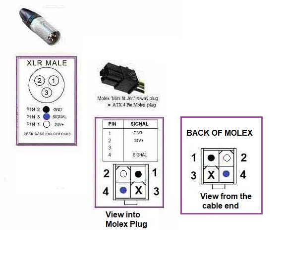

Postby woodygb » 01 Sep 2021, 19:33
You will need the modified software and an interface as described in this thread
https://www.wheelchairdriver.com/board/ ... &start=330
...pic attached below....pic shows a 4 pin molex but it should be substituted by a 3 pin Neutrik/XLR plug
