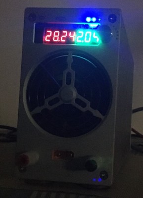

Thanks. That was it. Changing the amps changed the jump current to the 30% value. Setting it to 0.3 amps makes it work as expected.
I might have to adjust this because my ventilator battery pack constantly draws around .2 amps even when the vent is fully charged and not running. So maybe I should set it to 0.4 amps. Or maybe have to unplug that with each charge, but that's one more thing to forget.
Charging 28.2v and 2a
