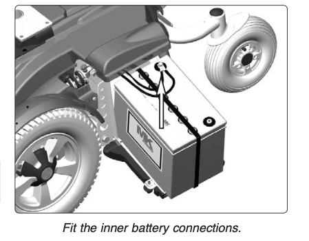

I have been thinking about putting a lithium pack in my chair for a few years. I haven't had the time or help to do it but I think I might go for it soon. Would anyone have recommendations for cells to buy to fit in a Permobil F5?
It has Permobil's new branded battery now but I think it can use MK gels as well, which I think are both standard Group 24 size. Last time I measured the MK gels from the C500 I got 259 x 173 x 209 mm.

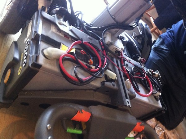

Ideally I would like to get a configuration which I could use in my old Permobil C500 as well, but the battery placement is different, so it might not work easily. The F5 has them right next to each other, long side touching, with the terminals facing towards the back, both sliding out the back.
The C500 has them with terminals facing back, short side next to each other, with a metal divider between, but each sliding out to the side.
F5 battery arrangement, slid out the back

C500 batteries in place with shroud removed

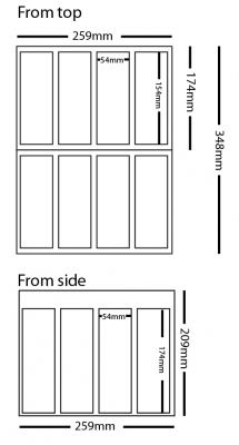

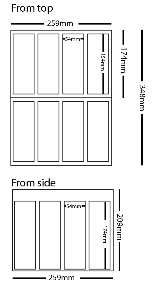

Postby shirley_hkg » 31 Mar 2024, 04:20
https://www.wheelchairdriver.com/board/ ... =2&t=12134
You may not get 209 height.
Last month, I put 160Ah in a Quickie QM-710 , which is in lack of space similarly.
However, one 350mm side is needed still.

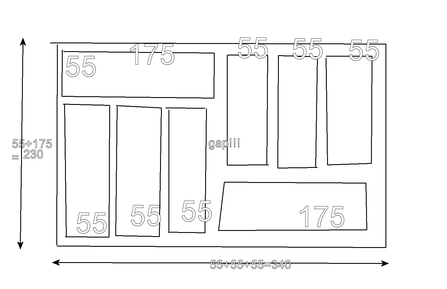

Postby Burgerman » 31 Mar 2024, 11:17
Do careful measuring. Not all cells need to be the same way around. In many cases where there is a group24 setup originally its possible to fit 8 230Ah cells. Such as these.
There many suppliers. These for e.g will or should fit.
USA https://www.docanpower.com/index.php?ro ... ption=true
EU/UK https://www.docanpower.com/index.php?ro ... ption=true

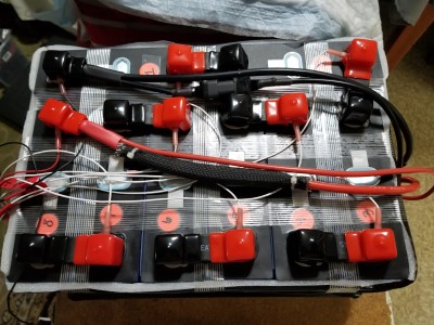

Heres a pic, layout, in a typical chair. Not yours though.
230Ah all nice and neat.
Remember that while 230Ah will give you a huge 500% or so range increase minimum and because of ultra light use and infrequent charging/low DoD daily a HUGE lifespan that will outlive the chair and maybe you, even the 160Ah cells will still give you around 3x the stock range. And last pretty well too.
Why? You will get 45Ah maximum from a set of 74Ah gel batteries because of peukert. Lithium doesent suffer from that.
230Ah div by 45 = 5.1 times as much range.
160Ah div by 45 = 3.5 times as much range.
But with the smaller pack you need a bigger percentage as reserve so say 3x as much. But even this is way better than lead. I wouldnt go less that 120Ah though as things start to get worse, with most of the lithium gains that were the very reason to do this, lost.
230Ah layout. 6 cells one way, 2 the other.

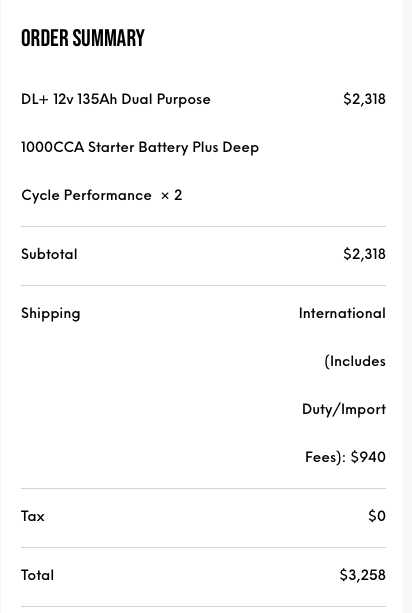

https://dakotalithium.com/product/dl-pl ... rformance/
They look interesting. I don't see anyone selling them in the UK. Looks like it would be $2,318 for 2 plus $940 shipping, total $3,258.

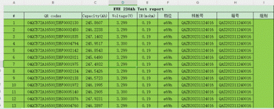

I think someone posted about these, or similar, before. They claim to be 240Ah and are shorter than the typical 230Ah (185mm vs 200mm), but the listed weight is 2.8kg
Seems implausible when the weight of 230Ah cells is around 4kg.
https://www.aliexpress.com/item/1005006515947627.html
Does it seem like a scam?

Postby Burgerman » 01 Apr 2024, 16:49
This is the problem. The chinese can CLAIM anything! As long as you pay with paypal, then you should be safe. When they arrive they need the following:
Careful examination for previous use/recovering etc.
All flat sides are FLAT and not bulged in any way.
Connect to the PL8 or simiar and charge fully, and then do a discharge test. You should get between 3.6V fully charged and 2.7V fully discharged almost exactly the claimed Ah capacity from each seperate cell.
Using a chinese impedance tester measure internal resistance, all should be low and approx the same. Measure at around half charged for lowest figure. But it should still be the same across all 8 even when fully charged.
If all this rigns true, then they are good cells!
Its unlikely though at this price!
£467.93 for 8 delivered.

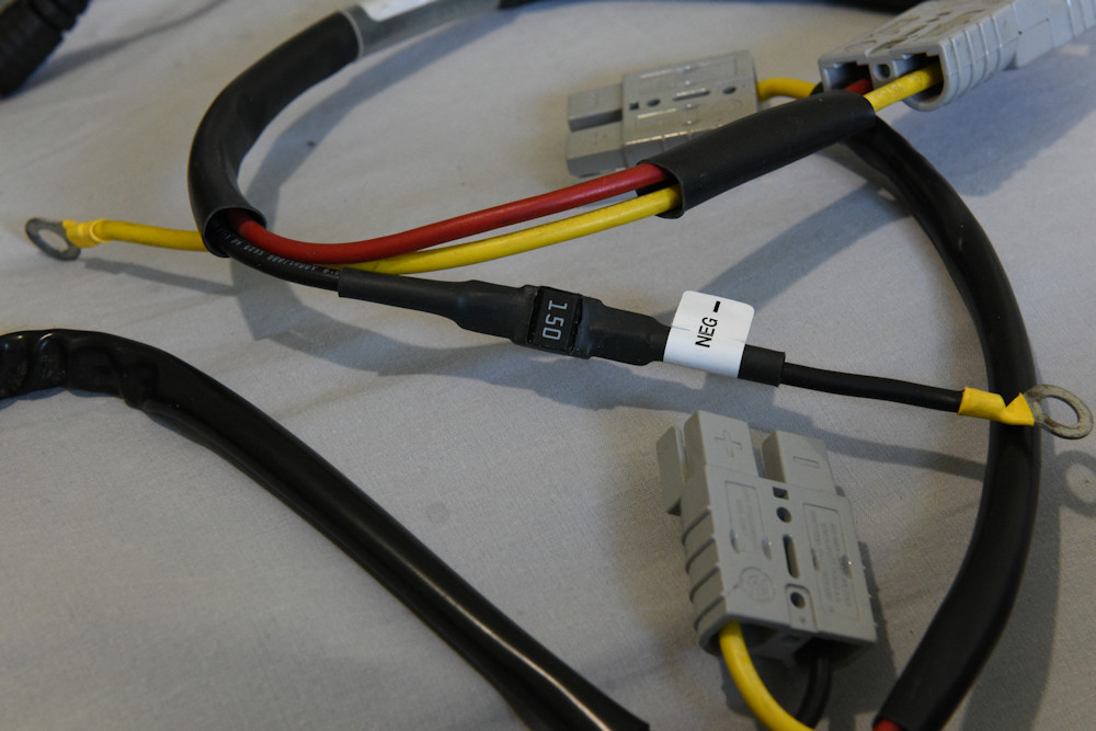

Yes it IS possible. With the Salsa, which had a 100A fuse It can take 200 plus amps quite easily if you gun it up a ramp or something from a standstill. And yes I blew a 100A fuse. And with my programming I can repeat that quite easily. And that takes much more than 100A.
And yes at 24V. If it was at 45V then the battery current would be halved.
Remember that my acceleration is set to 100 and so the chair goes when I tell it!
And also the fact that most chairs have 100 or 125 amp fuse with a 120A controller doesent tell you what the peak current it. Because an 100A fuse can do 3x this 100A current for a short spikes, and 200A for quite long enough as to accelerate through the 100% pulsewidth period. (maybe 1 second) Without blowing. It will only fail if you significantly exceed 100A for a significant time.
Breakers perform the same way.
I now have 150A fuses in all my chairs. And can blow 100A fuses at will. And even sunrise have started doing this. I have a loom bought for a sunrise chair with a 150A fuse already in it that I didnt fit!
Theres a reason that sunrise are fitting these 150A (double that rating intermittently) now. Rnet 120, heavy chairs, and ramps/steep hills mean that it can spike to 240A intermittently if programmed to go...

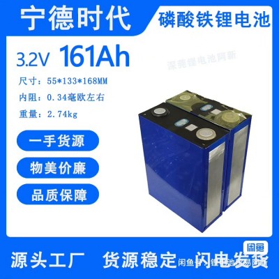

I'm leaning towards these:
China Stock EVE 106Ah LiFePO4 3.2V Prismatic Cell with Laser-Welded M6 Studs
Width: 174mm, Height: 154mm, Thickness: 54mm
There should be room for these cells in the space of 2 Group 24 batteries. Does this diagram make sense for placement? That would mean they are on their sides, so it might not have enough room for the terminals?
They might need to be squeezed into the space upright, but then there might not be room for insulation between them if the space available is really only 348mm total.

Postby jefferso » 07 Apr 2024, 00:32
Burgerman wrote:Why would they be on their sides?
I'm not sure if they'll fit upright with the 174mm width into the space if they need some insulation between them. The last time I measured MK Gels I got a width of 173mm and they seem pretty tight in the F5 configuration. If they're on their sides, that's 154mm which leaves 20mm or so for the posts and wiring in between.
Permobil claims their new batteries are 259x170x200mm, and I haven't tried MK Gel in the F5 yet, but I've heard at least they will fit.

Postby Burgerman » 07 Apr 2024, 02:13
Permobil are a law unto themselves. But if they made the chair to actually fit BCI GRP24 then thats actually an "inch" size and the mm part is a conversion.
They should be capable of fitting:
https://www.thebatterygenie.com/latest- ... ize-chart/
Group 24
Metric mm 260 x 173 x 225
inch 10 1/4 x 6 13/16 x 8 7/8
So if they built the chair properly then any battery that is GRP24 or 260, 173, 225 tall should fit...
The 230A lithium are 206 tall. And with them aranged as a row of 6 and 2 turned, should fit with space to spare at both width and length as well as being around the same height with terminals connected.
https://www.docanpower.com/index.php?ro ... uct_id=523
Laid out like:
6 together and 2 turned
I I I --
-- I I I
It ends up leaving lots of room for cell spacers, and a 1mm plastic/nylon/pvc/polythene base for safety.

Postby Burgerman » 07 Apr 2024, 03:02
I know you are not getting it so I did an unbelievably bad drawing in about 2 mins... After beer!
I appologise.
But the cells are not 55 wide. And are not 175 long. They are less. But even if they were it all still fits!
With ONE possible exception. Height. Now a group 24 is usually around 200 to 220mm tall. I have some here that I just measured from the salsa. Those are 225 tall. So these 230Ah cells will fit in the space that 2 grp 24s came out.

Here is my reply/quote after our discussion. All cells tested and gave 246 to 249Ah (from a 230Ah rated cell. And all are 0.19mOhm.

EVE 230Ah we supply is HSEV grade A cells, welcome to test the capacity and performance, and we also support original EVE manufacture test report for your reference:

Dorcan say that their 230Ah cells all test at 246 to 248Ah too. And invite me to test their claim. Maybe they really are A or rather EV quality as they claim. Even at their cheap price. What do you think?
