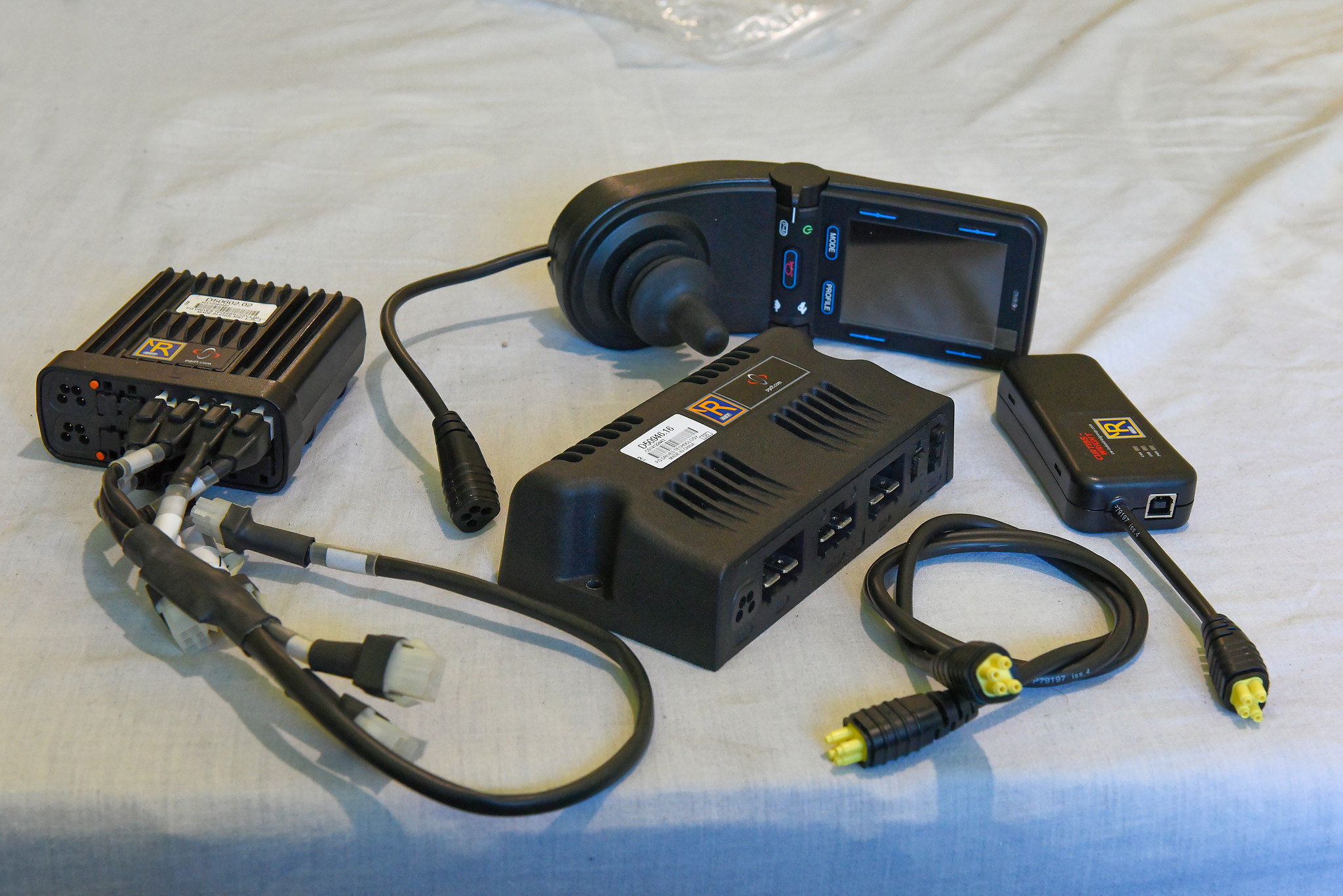

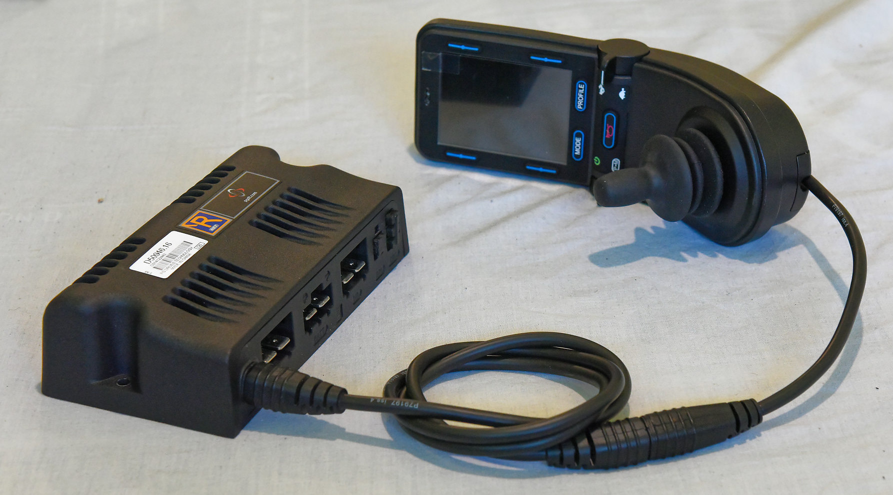

So that those that are scared of all the wiring and complexity on a powerchair understand how simple it really is!
Provided you have a basic chair built, with some batteries and motors with zero modules, zero cables etc. Just the chair!
Below is EVERYTHING else you need on a powerchair to make it drive!
Yes its that smple.
You need a battery cable. To join the battery to the power module.
You need to plug your motors into the power module.
You need to program it...
Battery goes into the centre connector.
Motors M1 and M2 plug into the outer two connectors. All really that simple!
Below is everything else.
1. JOYSTICK - any R-net one.
2. POWER MODULE - any R-net one.
3. BUS CABLE - to join these two things together!!!
ALL YOU NEED!!! 3 items.
Posts: 70775
Re: R-Net for dummies
Postby Burgerman » 07 Nov 2024, 19:26
So now it drives (once correcty programmed).
Woohoo! Doeset get any easier right?
If your chair ever wont work, just go back to this 2 component parts above and test carefully.
But this doesent add any lights or any seating options.
You may want these too! Or on a basic chair you may not.
To add these things you need to fit the very things you need to operate first, say a tilt actuator. Or a lift module. Or lights.
And now you need another item. The SEATING and LIGHTING module. This is usually a ISM6-L on most rehab type chairs which allows you to connect up to 6 seating actuators, and lights and indicators.
This needs another bus cable to connect it and that also gives it power!
So we now add this extra module. In my picture below I already added a actuator loom to it, so that its just plug and play to suit my sunrise chairs seating actuators.
Dont let that worry you. Its easy to DIY it.
EACH channel, is marked as channel 1, or channel 2 etc. Up to 6.
Each channel has just 2 spade terminals.
So you would connect your seating actuators (tilt?) 2 wires (from its motor) to say channel one. Then configure channel one to work your tilt actuator and test it!
Once thats working, you can move to channel 2 and say your lift actuators 2 wires.
Its really that simple.
So this picture shows the joystick, and power module that we already understand. And on the left it now shows a SEATING/LIGHTING ISM6-L module. This simply connects via another bus cable. And is self powered.

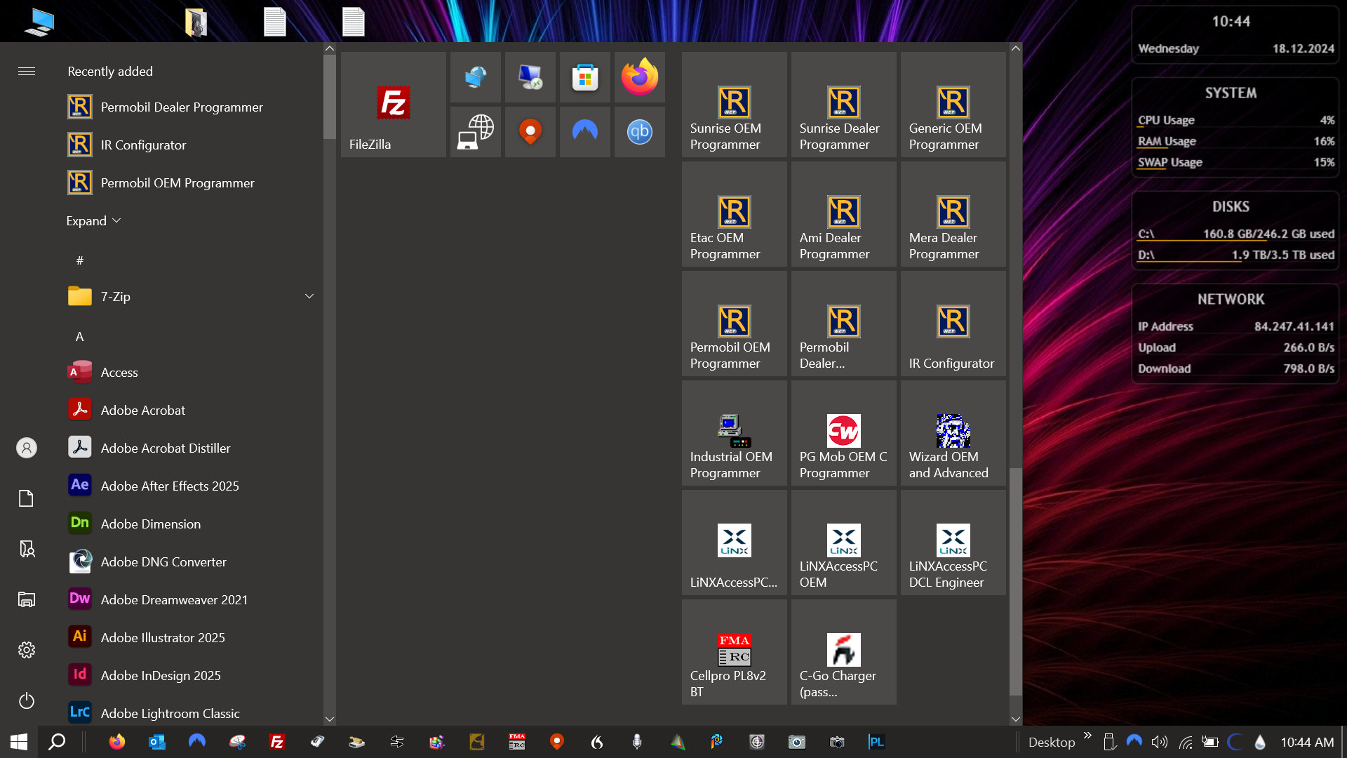

Also now shown is a programming dongle. On the right. This connects only when you want to program the system. It has a USB cable to your PC, and it fits in the bus cable somewhere. Usually between joystick and the long bus cable while you program the chair. When done, simply unplug it.
EVERYTHING needed for a full rehab chair with 6 seating actuators, lights, and a 120A power module. Inc the programming dongle.

OBP is built in and you need an OEM programmer to enable it. Not recomended on a permobil as it does the wrong thing... and its a bit limited in what it can do anyway.
A Dongle is needed for full OEM level programming, and that allows you to change everything on a PC. The thing on the right in the picture above.

I was given an a Permobil C 300 chair to convert into a beach powerchair and a Dongle to do the programming.
The Dongle allows me to get into the programming and switch each function to "none" which I assumed would allow me to

For thse wondering. I know you werent...
I have a lot of programmers installed...
R-net Sunrise OEM
R-net Sunrise DEALER
R-net PGDT Generic OEM
R-net Permobil OEM
R-net Permobil DEALER
R-net ETAC OEM
R-net AMI DEALER
R-net Myra DEALER
PGDT Mobility Programmer Manuf, OEM (C and D versions)
PGDT Industrial Programmer OEM
Dynamic Wizard (all 4 levels)
Dynamic LinX all levels (but no updated ones) and run away. Its horrible.
