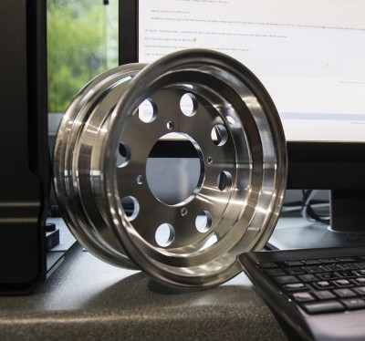

8 inch diameter x 3.5J rim
Duro tubeless 120/70-8 tyre. (kitaco)
adapter made with just a drill, and ordering a few laser cut metal parts.

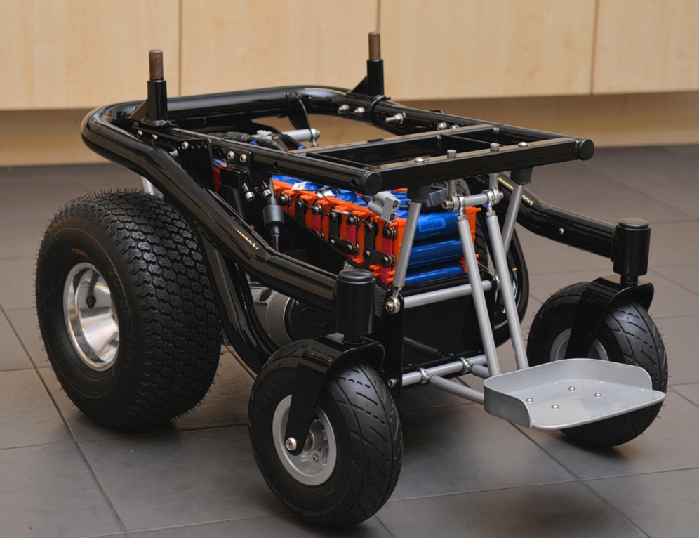

Adapters...
I made all sorts of those!
Depending on what was required by each chair/wheel combination.
Heres 1
Hubs stock. Threaded rings to be welded on.
Welded...
Rattlecan black.
fitted hegar rim, which has a k-shield reinfirced puncture proof tyre and a huge cross section.
Its 14.5 diameter, 6 inches wide, on a 6 inch rim, that is 5 inches wide.
Chair...
Posts: 71113

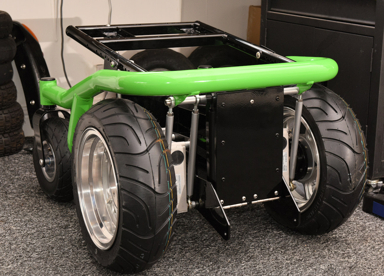

Others... Tubeless
12 inch x 4 wide rim. With 130/50 12 tyre.
Same as above
Another adaptor

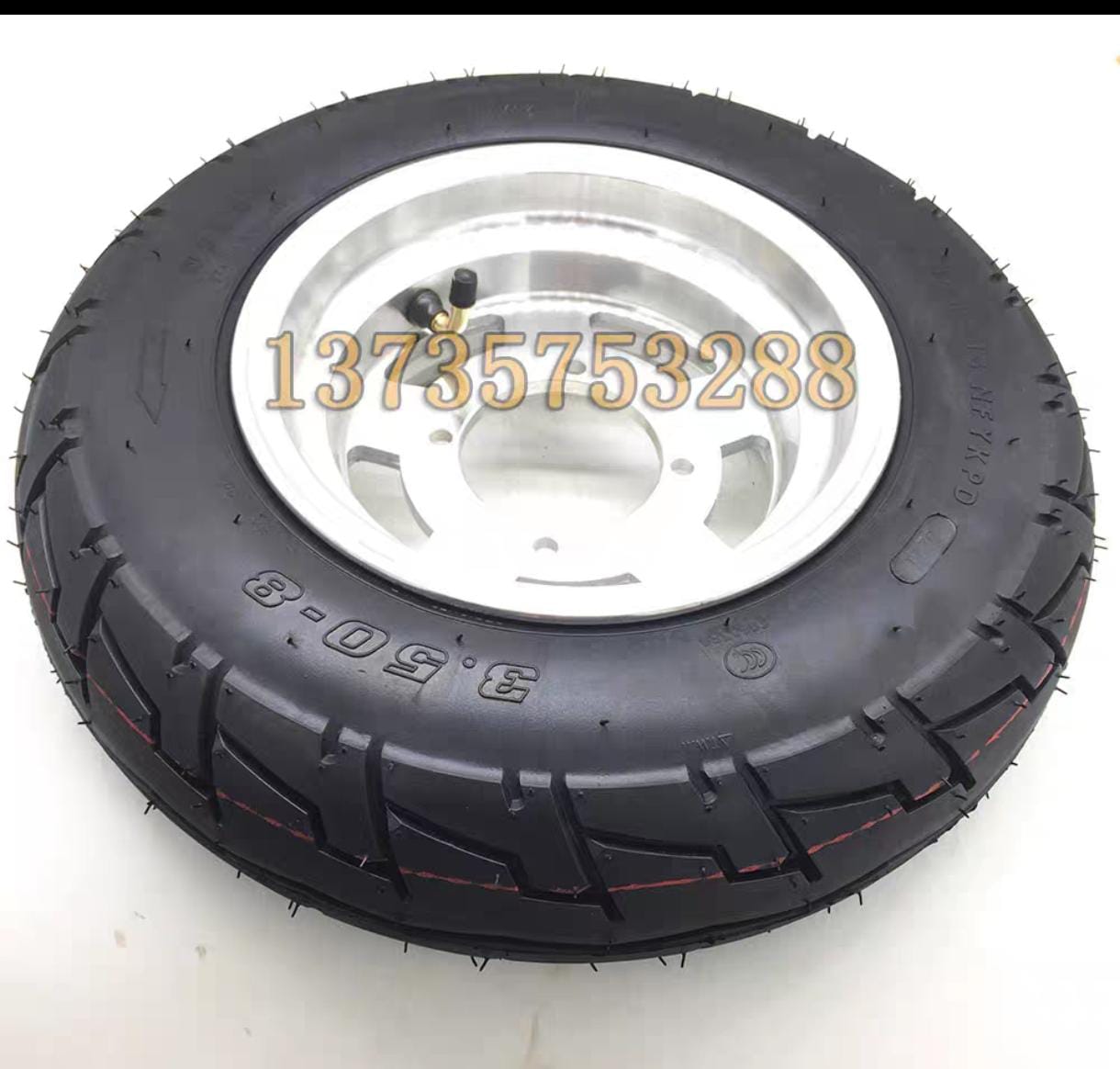

Dont have to be fat!
3.50 X 8 TYRE ON tubeless rims, cheap steel ones.
Again much stronger than stock tyres.

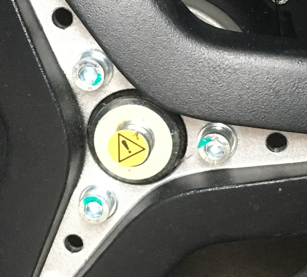

The F5 has 3 bolts holding the wheel on. The C500 has 4 bolts.
So for the F5, I'd need to find a wheel, a 14" tubeless tyre for the wheel and get an adapter made?
Permobil's Service manual says not to re-use wheel bolts:
NOTICE
Replace used wheel bolt
If a wheel bolt is removed for tire service, replace it with a new, unused bolt
from Permobil and tighten it to the recommended torque. Also, inspect the
drive axle and wheel rim for any damage. Damage to either part can cause
the wheel bolt to loosen or fracture. Because the TUF-LOK thread lock fluid
wearsoff, Permobil recommends that wheelbolts only be used once.

Duro kitaco tubeless 120/70 - 8 tyre, 3.5J x 8 rim, DIY adapter, Salsa chair.
https://www.wheelchairdriver.com/board/ ... 50#p206303
120(mm) wide, 70% profile, 8inch tyre.
14.6 inch diameter
4.70 inch wide
3.3 inch tall (sidewall)
ideal rim needed 8inch X 3.5J as used and (3.25 to 4.25 can work)

Postby Raro » 08 Dec 2024, 20:42
Will tubeless tires in size 3.00-8 be suitable for that sheet metal rim? I don't see many in that size

Postby Burgerman » 08 Dec 2024, 20:56
Not sure I saw a tubeless 3.00 x 8 tyre.
If they exist they will work on any tubeless rim that is 8 inch, x 1.75 wide like a stock mobility rim, up to a 2.5 inch wide rim.
Which rim were you talking about?
The one above is a cast alloy rim, electroplated.
Heres the thing. If going to the trouble of making an adapter or new hub in order to fit a tubeless rim, why fit the stock small cross section 3.00 tyre?
Posts: 71113

Postby Raro » 09 Dec 2024, 11:50
Burgerman wrote:Dont have to be fat!
I was referring to the ones mentioned in that message, I only looked for that size when I saw this post, the reason for using one in that size would be to get the most compact size that would offer the lowest seat height even if the difference is small. I'm not looking to do it, it's just a thought.
