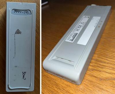

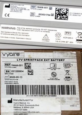

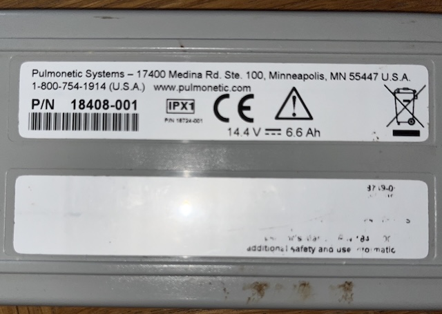

My ventilator has a battery pack which takes two long thin Li-ion batteries. It's made by a company which seems to have gone through a number of name changes. Pulmonetic, CareFusion, Vyaire, Aquilant, Healthcare21.
Each LTV Sprintpack Ext Battery is about 9 x 3 x 1in (23 x 7.5 x 2.5cm) with 6.6Ah each at 14.4 volts. I think they weight under 1kg each.
The batteries cost around £230 each ($350 in US) new. When new each will drive the ventilator for about 3.5 hours. I have them on the back of the ventilator on the back of my chair so if the chair battery ever ran out, I'd have another few hours of breathing support (since they stay charged all the time when the chair powers the vent).
Does anyone have a guess what kind of cells might be inside them?
The label says Cells made in Korea, assembled in Mexico

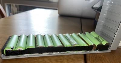

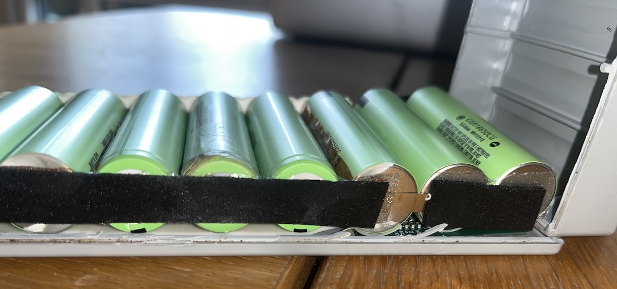

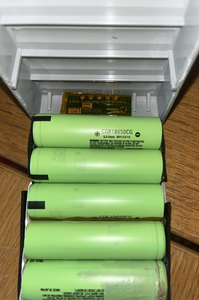

I finally got one of these cracked open. It seems like it's glued shut, not just snapped together, so the plastic had to be broken to get inside.
It has 12 CGR18650CG Li-ion MH12210 cells.
It seems like at least one in this set is split open.
It might be a gamble to even replace the cells to see if the attached electronics still work. £60 or so for the 12 cells to try. I can't tell yet if they're soldered or if the connector strip is just stuck on with adhesive.

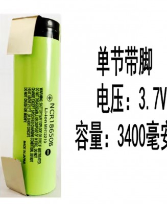

Those are when new 2250mAh.
You can relace with various 3000mAh ones, and even soe 3300, 3400 ones.
So could gain a 50% increase in run time over a new pack. I use a few different 3000mAh 16650 cells here for hobby stuff.
They will be spot welded with a nickel strip.
Toy can but the nickel strip in rolls on ebay/amazon. Also you can spot weld them but you need a cell welder... So I ust do what they say you cant and solder the nickel strip. Its fast and easy. Never had a problem doing that.

Buy from hobby shops or vape shops, molicell, sony, panasonic, samsung, ignore the rest!
Beware many fake capacities on ebay, amazon etc.
https://www.hobbyrc.co.uk/sony-vtc6-300 ... 18650-cell
For e.g.
