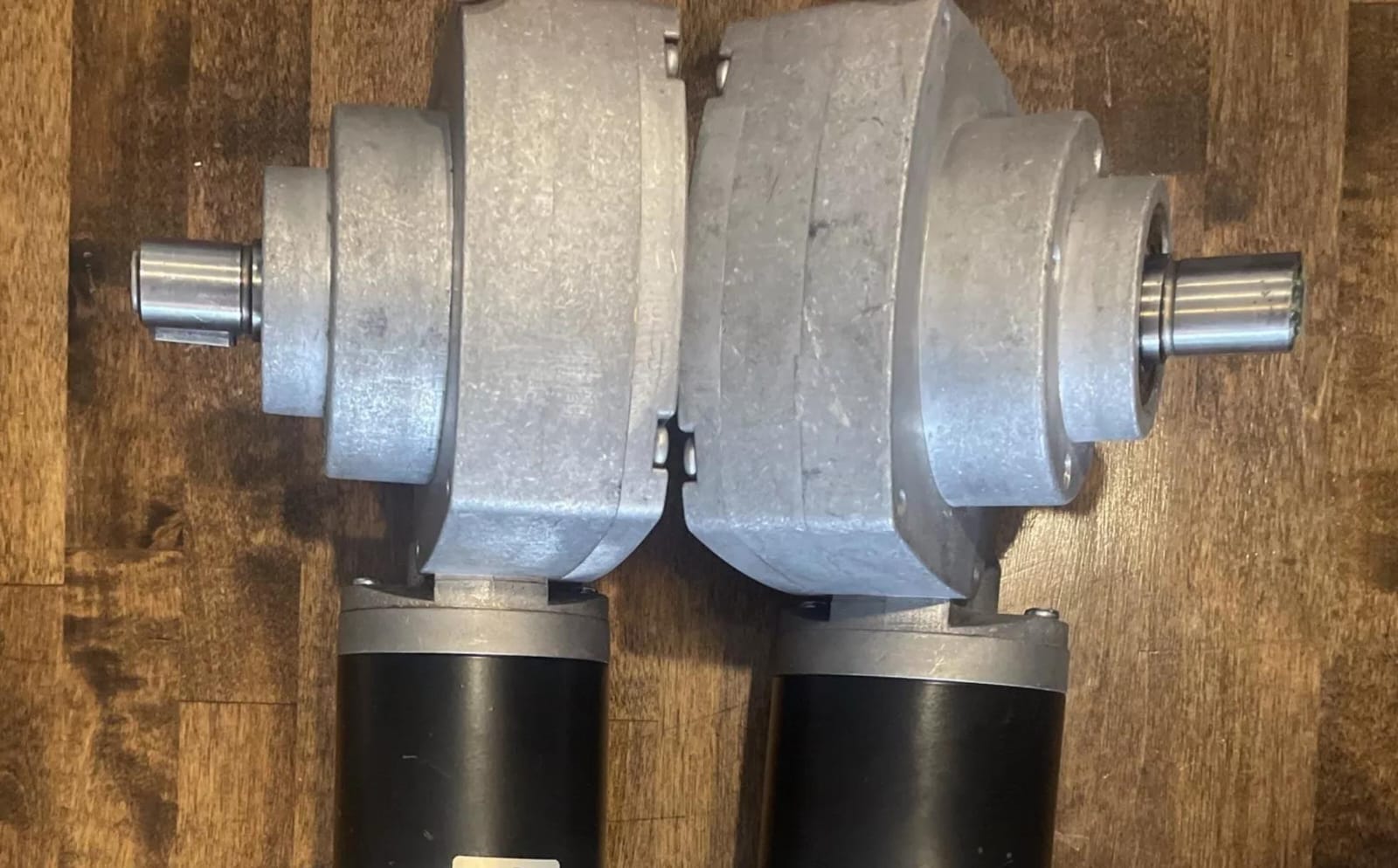

Maybe you can ask someone who has an engine for sale if they can do you the favor of measuring it like in this ad...
https://www.ebay.com/itm/135009251931?i ... AOSwM45lrY cK&itmprp=enc%3AAQAJAAAAwCodCO1vSDjg2xNOt8By6oCc%2BB5fotidNTv5iCC8YlfZDRgnGQPmkAxJtnyx3AkoPqnPvQeIybBN2VSgAzz kP85PD3FIzh2M1W5X8XKwSccBng1fJ1D%2BMbV4a0l7G29wCXdfThYb7aork1Ws%2Fa4enD2vHgH2ZWsvzrVKQToSew4qaW10xSd81doUhpuC zHr6aw9O%2BXg%2BxoebrWkm1I7sXOMonY5FH2w83ngD6CMsUxOU6yByQYlAQKu%2FQE1%2B%2BTm6RA%3D%3D%7Ctkp%3ABk9SR5rDif6dZQ

Actually, I'm asking for a hub on ebay.

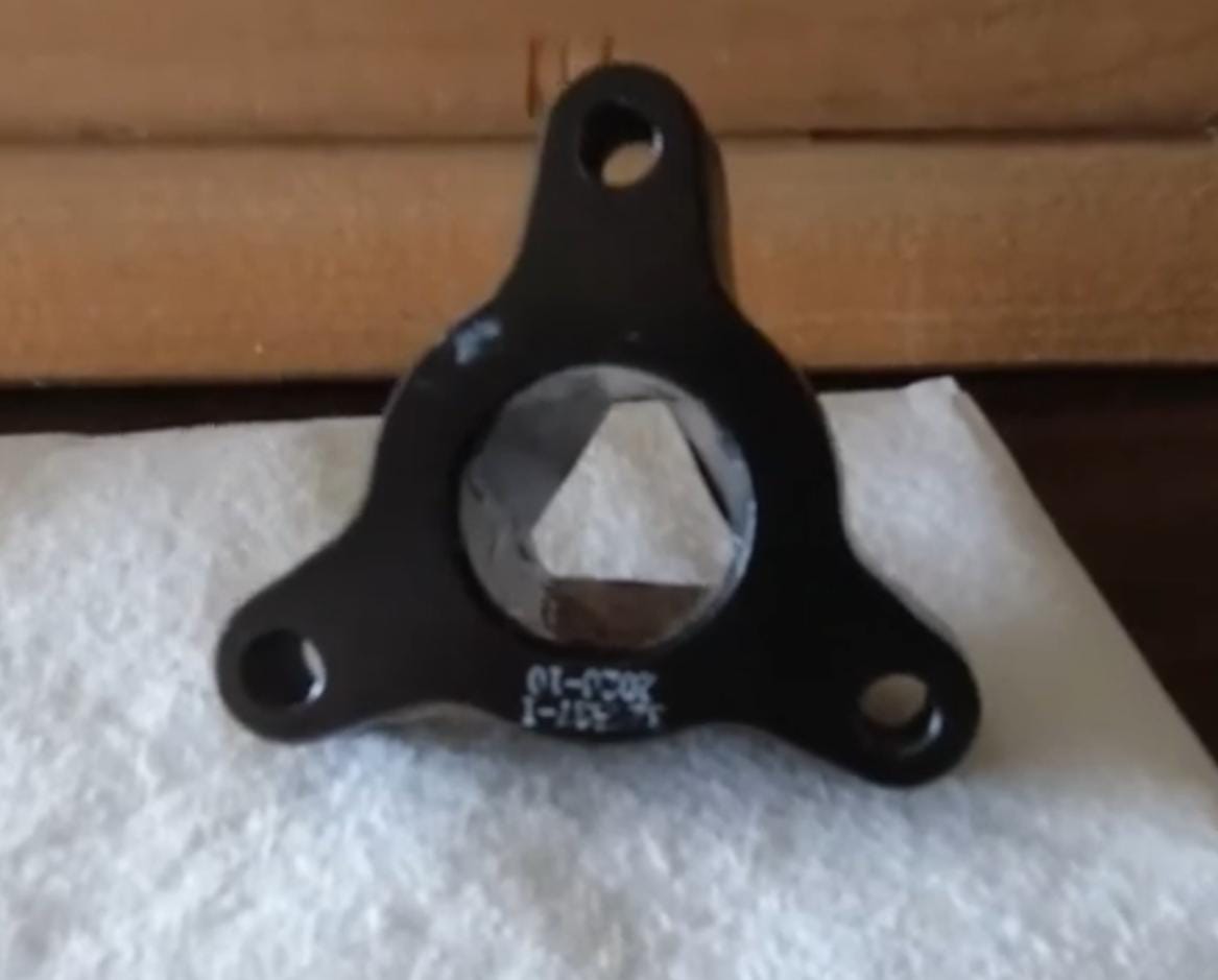

Postby slomobile » 14 Feb 2025, 03:34
The shaft is a weird 3 faceted taper. I wouldn't even know how to describe it other than that. Not easy to machine a hub for.
https://youtu.be/64QZITH3sjk?si=9xuGXZy3AMRgJukk
If you really need a measured drawing after seeing that video, ask me again and I'll pull a wheel off and try to get you enough measurements. But I think it would be lots easier to just use the stock hub.

slomobile wrote:The shaft is a weird 3 faceted taper.
Thank you , Slomobile
That's really not easy to replicate, but I do appreciate Permobil super strong design.
It's only feasible to use original hub , and modify it to take tubeless rims. So I need two hubs.
Don't bother to take measurement, pal.

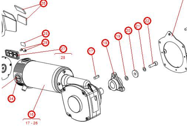

Postby jefferso » 19 Feb 2025, 19:17
So that hub is part 18 in this exploded view, correct?
https://explodedviews.permobil.com/catp ... ditid1=364
It says:
Code: Select all
New Part Number  Old Part Number  Description
NULL             323404           HUB O22x28,5
I haven't seen one on ebay yet.
I wonder how much Permobil charges for them.
