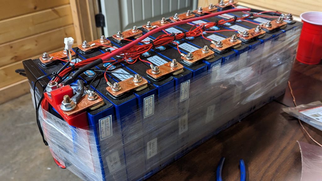

The 16s 2amp version I use measures 6.4 inches tall, 4 inches wide, and .8 inches thick at the thickest point. Considerably thinner along most of it. The 8s version looks to be smaller. I can't confirm that though. Never seen one in person. I wrap mine in with the tape on the front when I final assemble the cells. Overheating has not been an issue and I routinely pull 130 amps through mine for a few seconds at a time.
The red thing is something I 3d print. It functions as the pack's main + and - connection points.

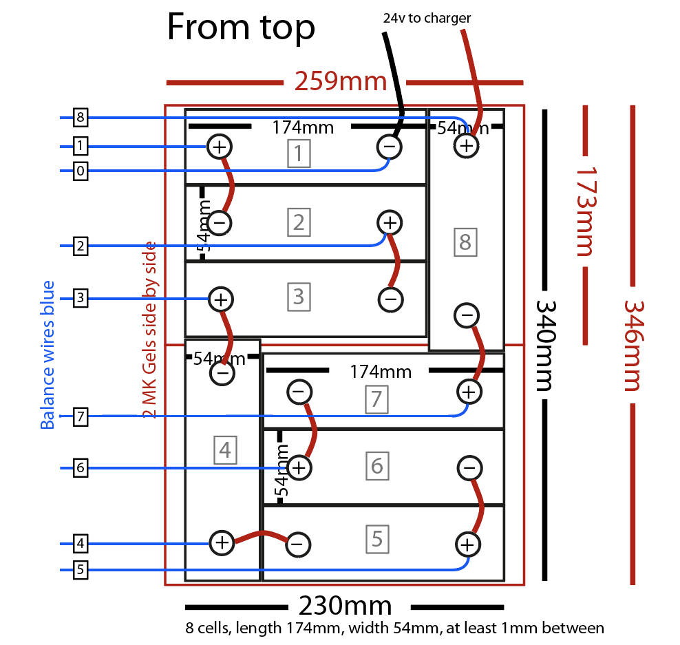

When you make a pack, in order to get it to fit the space available with the least wasted volume, and the biggest capacity it may be needed to use many smaller cells, with some in parallel and then the parallel groups connected in series to get the voltage you require.
We need 8 cells to get an "equivelent" voltage to the 24V standard wheelchair voltage.
We can either use 8 cells. in series.
Or 16 cells and have 2P (2 parallel) and then 8S or 8 groups in series.
Or 24 cells, 3P and 8S...
Or 32 cells, 4P and 8S.
A 48v pack and chair needs the following for e.g?
So that would need a nominal 48V or 16S. 16 cells in series.
So 32 cells with 2P and 16S.
If you counted 28 cells then its likely that it is either 7S and almosts 24V (too low voltage for LiFePO4) and 4 in parallel. So unlikely!
Or 14S and 2P with gives us a nominal 14x 3.2V battery pack. Or 44.2V. With roboteq thats fine! So probably.

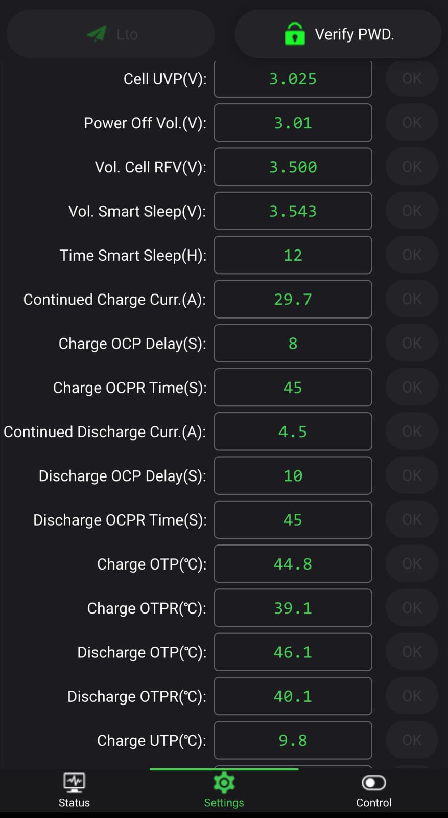

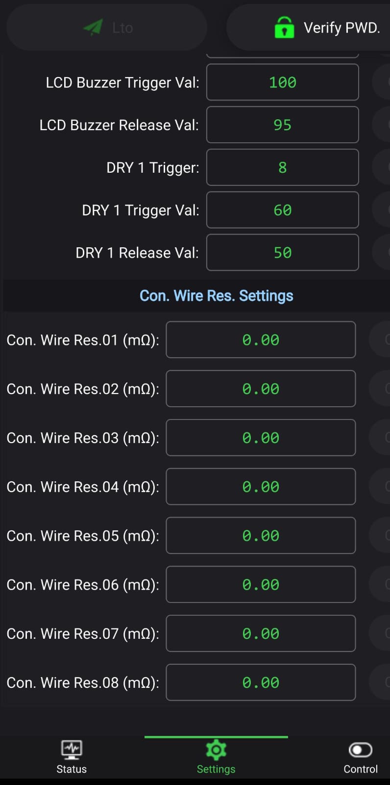

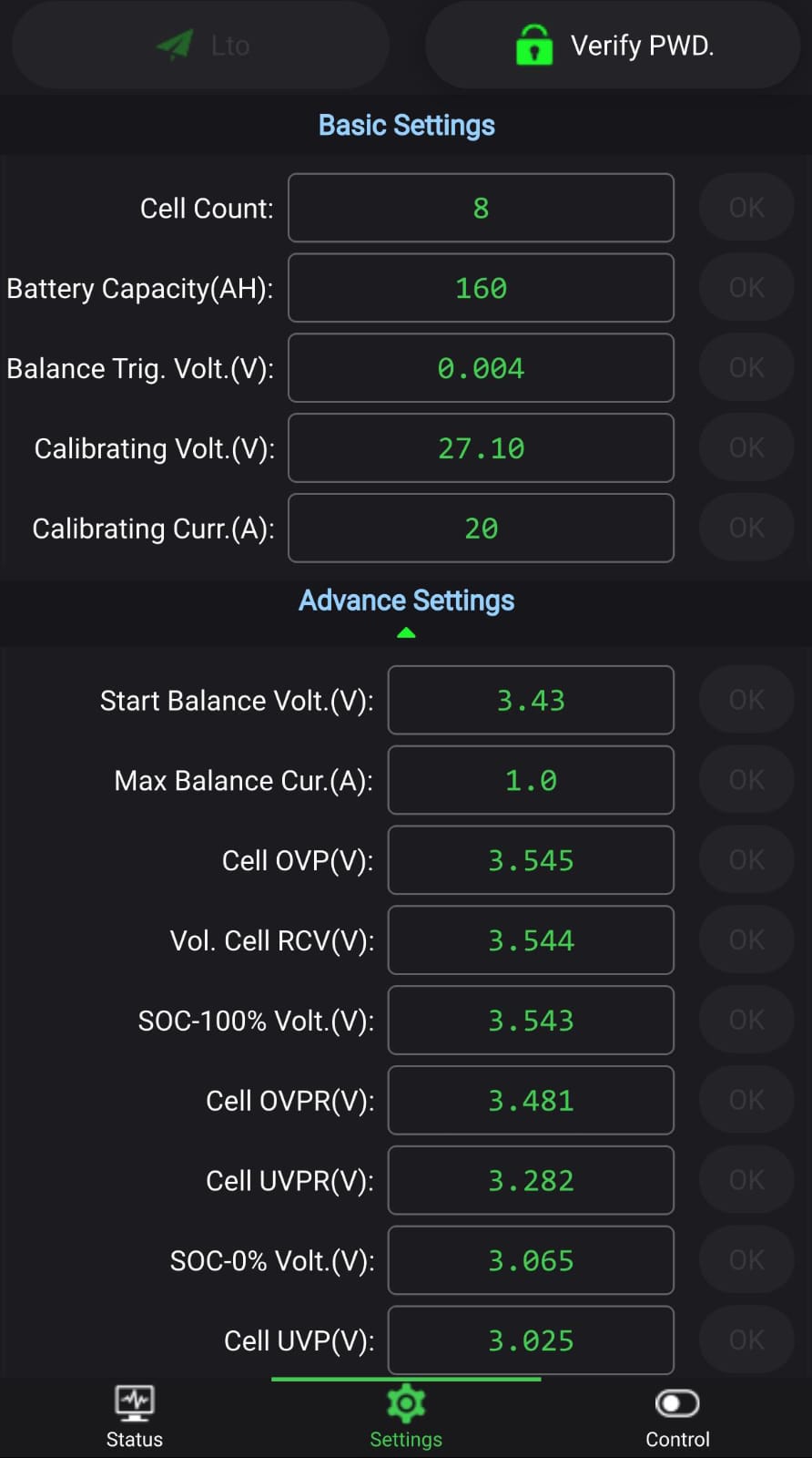

Postby shirley_hkg » 14 Nov 2025, 11:17
JK bms settings
Posts: 4643
Re: "Simple" solution for Lithium charging

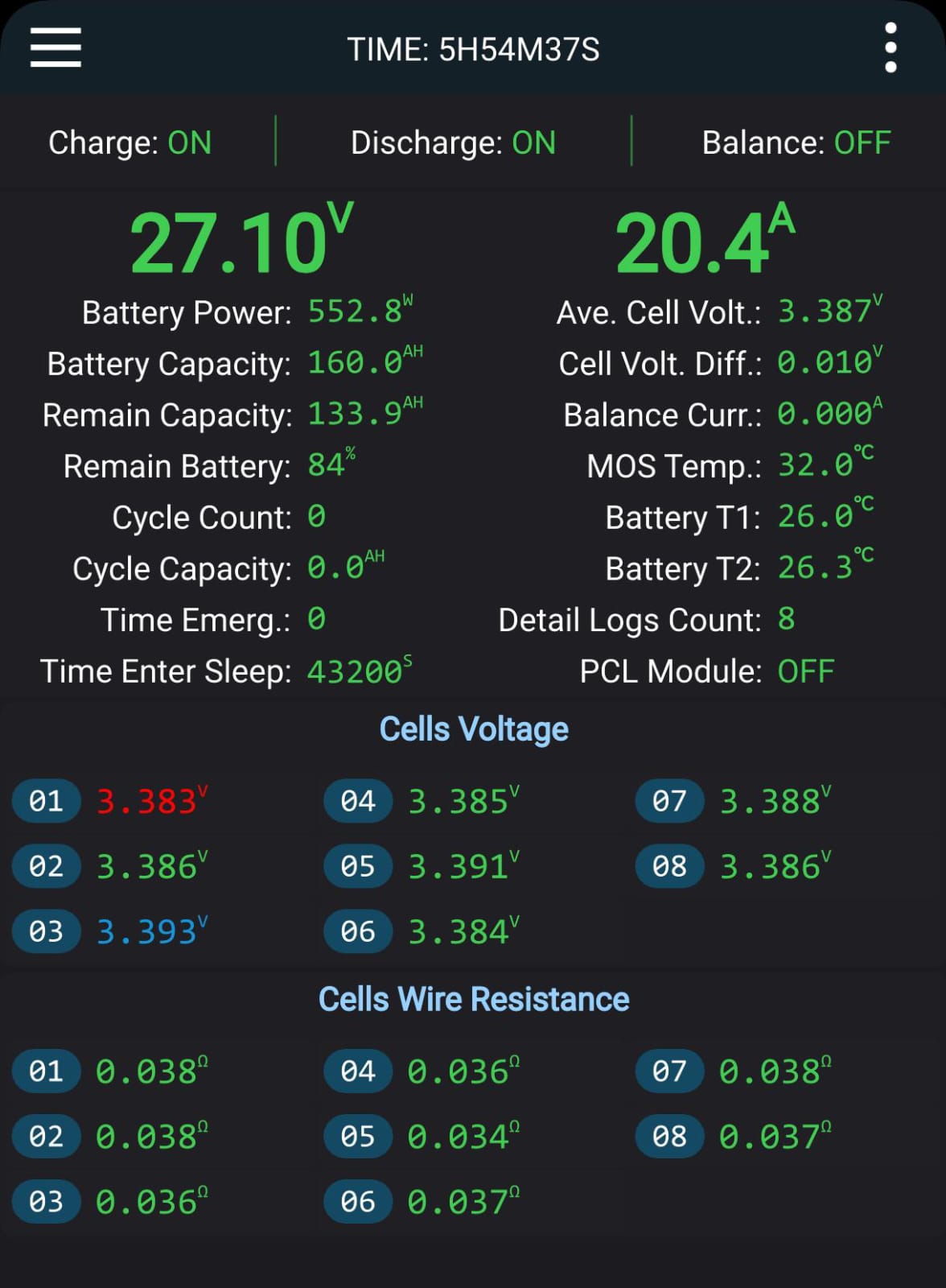

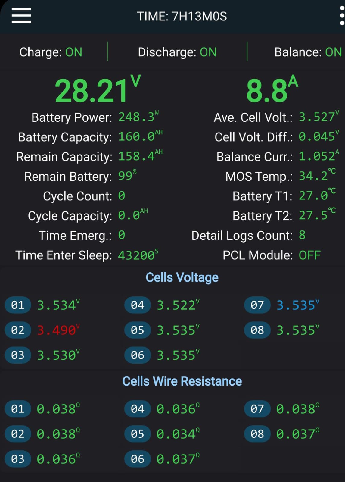

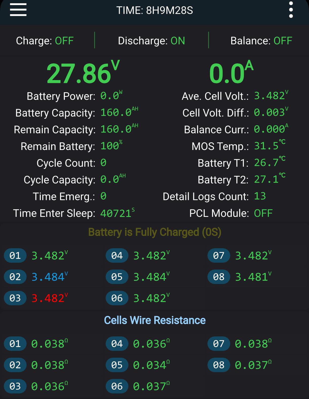

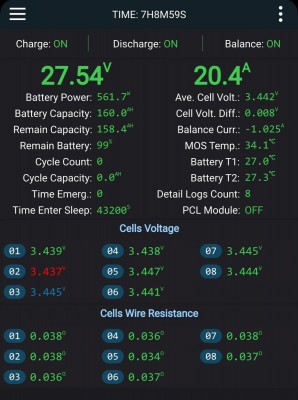

Postby shirley_hkg » 14 Nov 2025, 11:24
Just setting up a pack, and now charging @ 20A.
Connection at cell 3 might need fine tuning. (Δv 10mv while charging.)
Posts: 4643

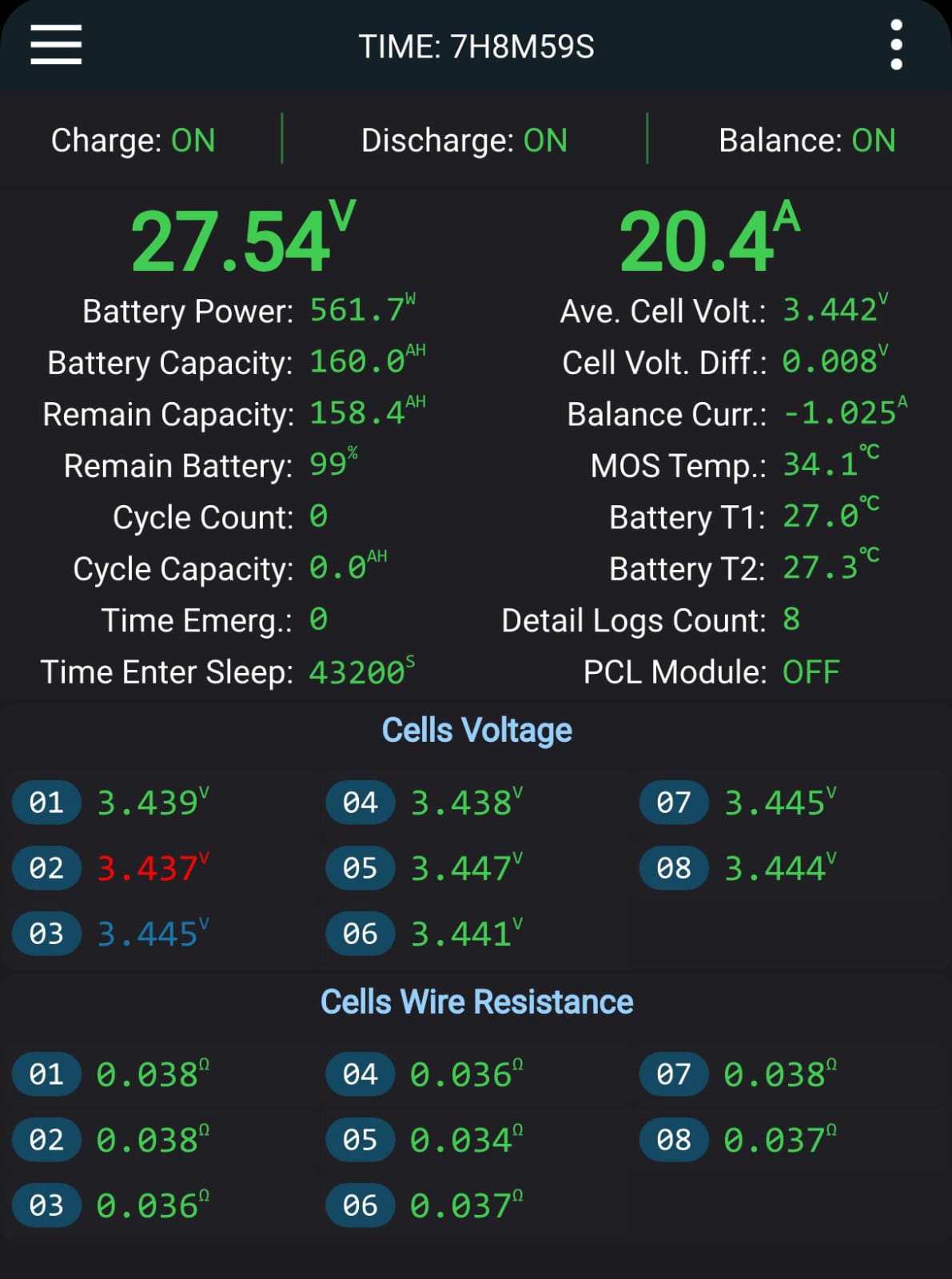

Postby shirley_hkg » 14 Nov 2025, 13:31
It started balance at 7H8M59S
While I was replying your post, it finished the job already 8H9M28S。 I guess it's 30 minutes ago.
