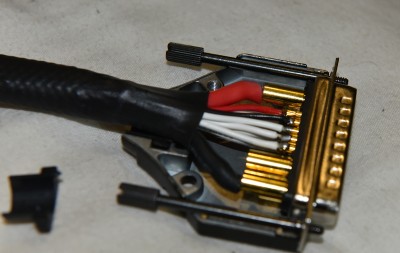

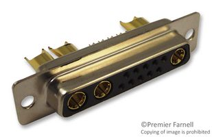

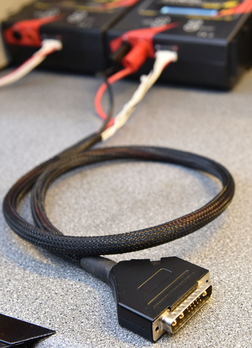

Hi, what is the connection cable between the charger and battery pack Sub D lead (9 balance and 2 power) lead.
I have the battery to Sub D (9 balance and 2 power) lead
I need a cable Sub D lead (9 balance and 2 power) to charger port?
James
‘If you are NOT in control, leave the STRESS to them”
saker98
Posts: 77
Joined: 10 Nov 2011, 18:23
Location: Norwich, Norfolk. UK
Re: No PL8 No Charging?

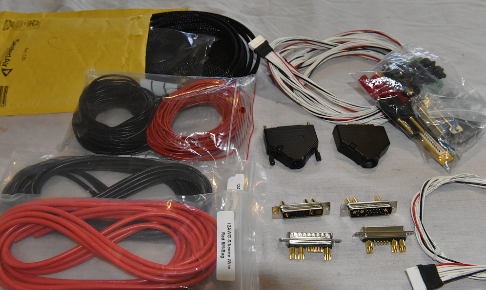

Postby Burgerman » 20 Oct 2025, 10:54
Yes. Use 12awg silicone for the charge wires.
cable stuff...
one on chair, one on charger
male or female
Male or female
Soldered

Postby saker98 » 20 Oct 2025, 19:13
Burgerman wrote:Yes. Use 12awg silicone for the charge wires.
I am going to go the ICharger x8 route with Shirley's ZXD2400 3.2" TFT and the above cables.(John's Photos)
This way it will hopefully alleviate any further pit falls or mistakes.
Thank you John, and everyone else for their advice and wisdom :worship :thumbup:

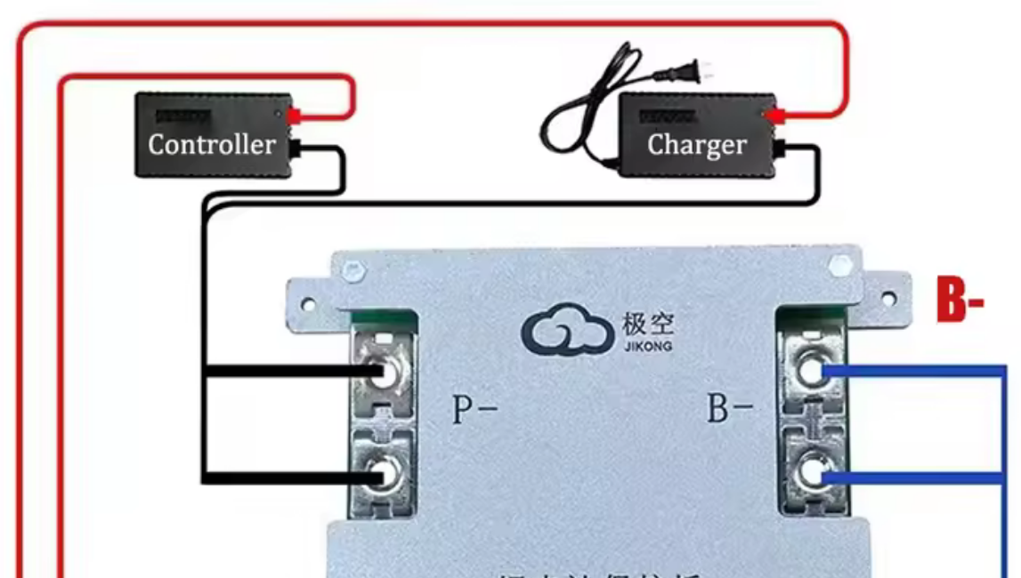

Postby Dan » 21 Oct 2025, 09:43
Burgerman wrote:Something like this, 2A balance, BT 8S etc.
https://www.aliexpress.com/item/1005007 ... in_prod%3A
In the wiring diagram for that BMS the charger is the power supply but what is the controller?
Postby Burgerman » 21 Oct 2025, 09:48
Beats me!
Posts: 70129
Postby shirley_hkg » 21 Oct 2025, 10:02
It means the LOAD.

Postby snaker » 21 Oct 2025, 10:04
The "controller" means "consumer" or load.
