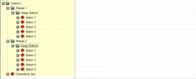

Can you do this part of the Switch-it?
MagicJin
Posts: 15
Joined: 10 Nov 2025, 07:23
Re: There are no points assign buttons cjsm2
Postby Burgerman » Yesterday, 09:26
I can! So presumably. Until you see the price of that switchbox.
Posts: 70175
Postby MagicJin » Yesterday, 09:30
If it's not difficult, please do
MagicJin
Posts: 15
Postby Burgerman » Yesterday, 09:38
You mean you want me to post this?
Not sure what you are asking?
Not sure how that will help you unless you have a switch box?
Or if it will work.
Switch-it.Rnss
(4.37 KiB) Downloaded 1 time
Posts: 70175
Postby MagicJin » Yesterday, 09:43
This is for the future. If I buy this box. Thank you!

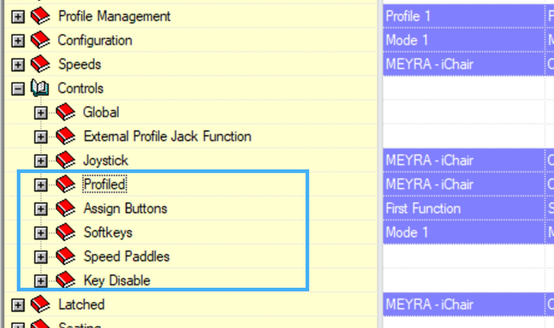

I have one more request for you. Do as highlighted in the screenshot. Starting from Profiled
MagicJin
Posts: 15
Postby Burgerman » Yesterday, 12:06
This?
as-requested.Rnss
(4.47 KiB) Downloaded 2 times
Posts: 70175
Postby MagicJin » Yesterday, 12:10
Yes, thank you! :thumbup:
