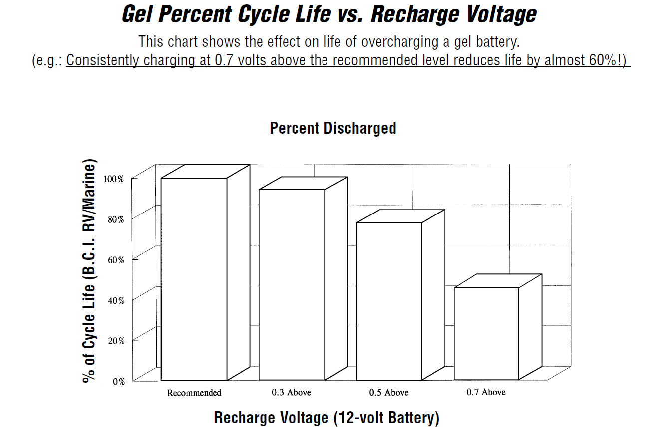

B.M.. ..I found this in one of the MK pdf's ..you may have seen it...but I thought it was worth a post.
Re: After reading more ill informed stuff elsewhere I did a page
PostPosted: 26 Dec 2012, 20:42
by woodygb
Here's MK's recommendations.
agm-gel volts.gif (131.49 KiB) Viewed 4890 times

He has little reason to be riled ..I've only used his data source... MK ... and not mentioned B.M.!
Perhaps it's his ego or Pride :lol: that's being pricked?
The CTE charger Pride seems to supply puts out 28.8v Charging Voltage(DC) and 27.6v Floating Voltage(DC) ... that's 14.4v per battery ...the recommended optimal on a gel is 13.85v @ 60-69F ...It would appear to be supplying .55v over the optimal...the block graph suggests that this will reduce life by 30%.

ABSOLUTELY correct according to MKs own freely available data.
Whats more is its actually worse than it appears, because in order to return all the Lead Sulphate that coats the plates back into the acid before it becomes hard and permenant, charging at CV stage must end after a much longer period on a gel battery than we have available on an overniight charge. So most cheapy mobility chargers tell you the battery is "ready" long before it actually is...
So Lead Sulphate builds up faster on the plates over time and never gets removed by a regular full charge... So we have OVER VOLTAGE as well as an INCOMPLETE charge leading to a) water loss over time and voids in the gel, and b) long term sulphation rapidly decreasing capacity/increasing impedance...
Meaning your expensive new gel batteries will never see their potential full service life. Expect around 300 cycles at 80 percent DOD instead of the 500 you should get
