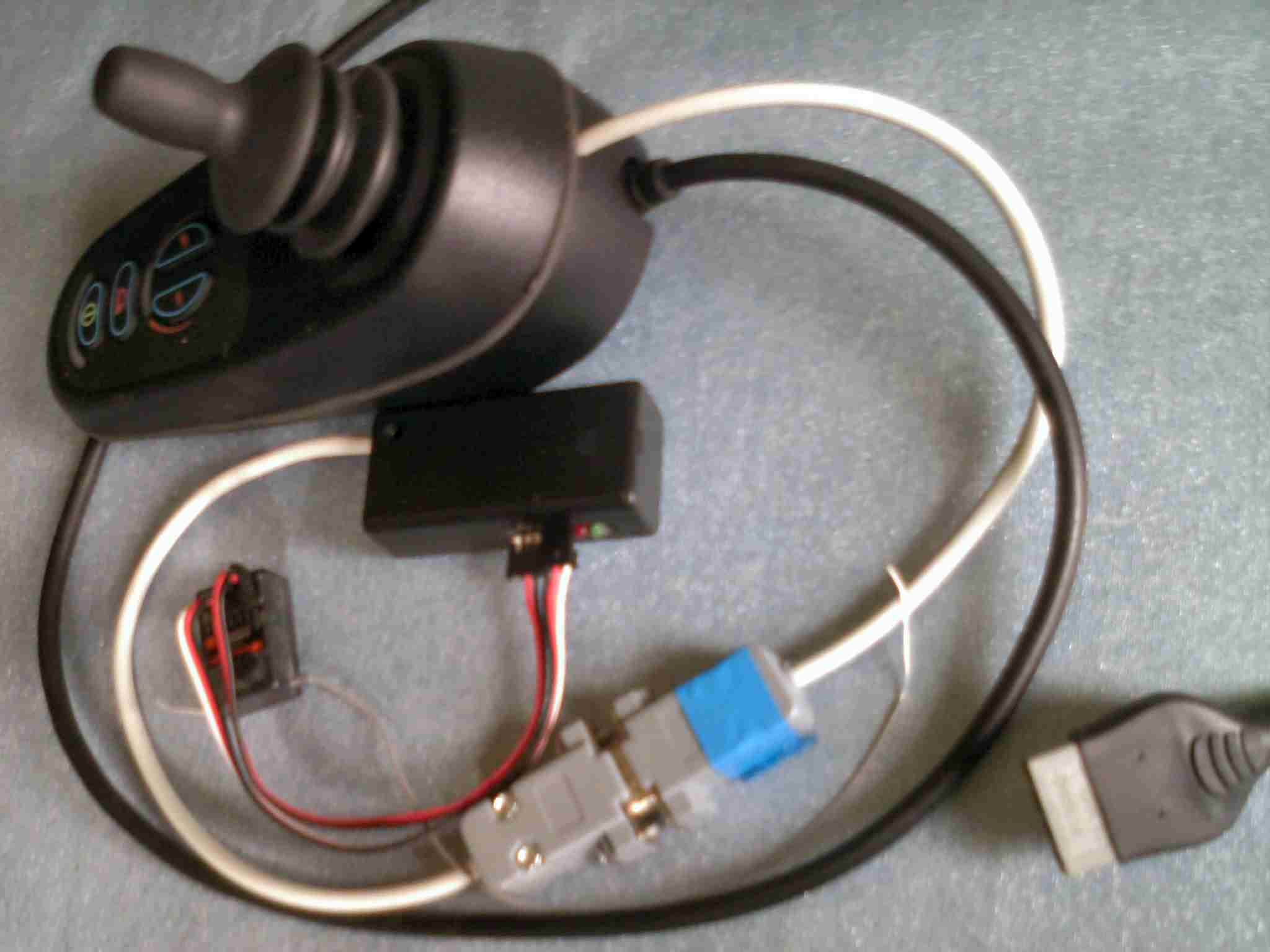

Mous3 kindly sent me a complete VR2 system from her old chair "Davros" to see if I could make a simple..ish R/C interface to plug into the joystick pod.
I now have a working prototype for her to try out and will be posting everything back after this weekend.
Here's the setup inside the joystick pod.

Re: R/C - VR2 Joystick interface
PostPosted: 22 Apr 2014, 07:53
by ex-Gooserider
Hmm.... Probably OK electrically, but my aesthetic sense is going "Seriously Ugly...." (sorry...)
As a suggestion, I think the ribbon cable and the IDC connectors that go on it are commodity items that should be available from your favorite supply houses for reasonably short money, even in small quantities...
I would be inclined to make a custom cable with three plugs on it, and a connector with the wiring to the interface that plugged into the 3rd connector - seems like it would be neater...
PostPosted: 22 Apr 2014, 09:14
by woodygb
I could however put a female socket where the messy multiple connections are.... and solder a male plug to the interface lead.
PostPosted: 29 Apr 2014, 09:30
by ex-Gooserider
Yes, looks MUCH neater / professional...

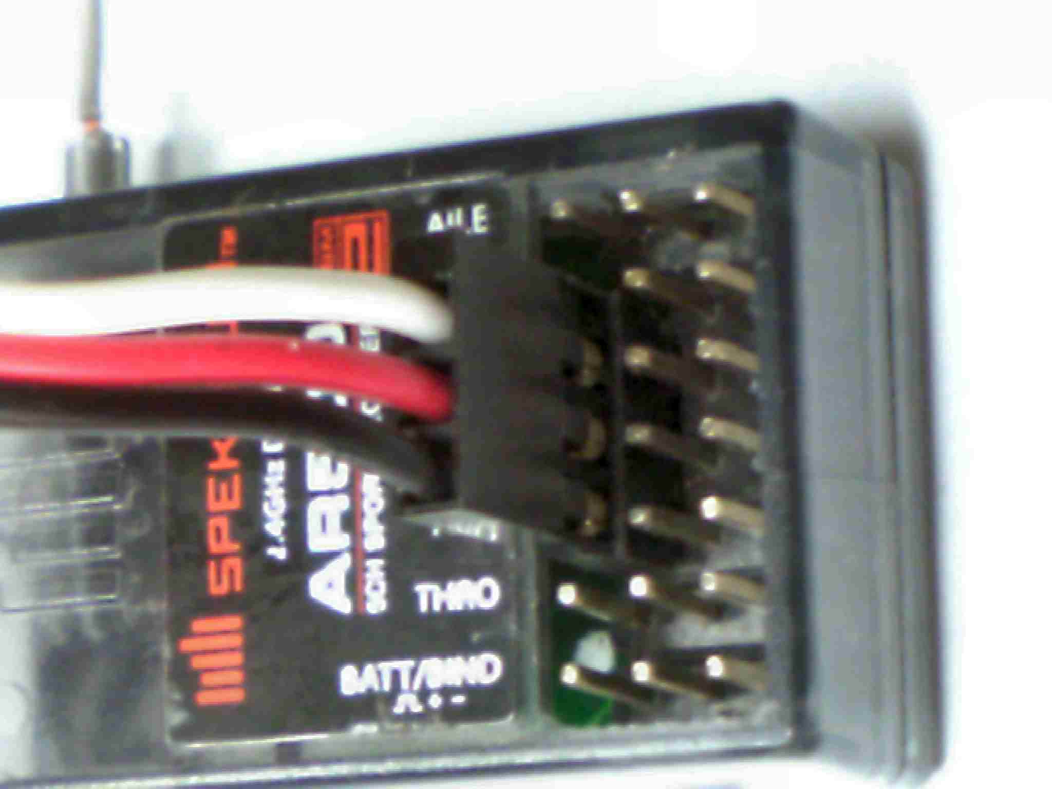

Just to try and make the Receiver connections clear.
You have one STD servo lead BUT that is being used for 3 separate signal wires .
PLUS one servo lead with Red and Black that equals POWER /Bat .
The colours used in the pic for the RUDD, ELE , AILE signal wires are purely for clarity and not the same as the servo wires ...
So ..on the servo lead with 3 wires you have WHITE = RUDDER ... RED = ELE and BLACK = AILE ... ONLY ONE wire for each signal channel is required.
PostPosted: 02 May 2014, 16:57
by mous3
Thanks I have the signal inputs plugged in and correctly linked up. I just had to take the plastic plug off and connect the individual wires to the signal pins on the Rx I am recharging a 6v pack but it will be an over night job.
So onward with a cheap 6ch no fail safe 4-6v Rx. The board is happy did everything it should and the chair drives so for multiplex EVO systems bind Rx and Tx set to mode 2, assign model name no flight phases and servos to1, Al 2, El 3, Ru without any mix option and reverse the Al input only! make sure you are using a 4.8v receiver set every thing ells as pdf then re-assign 3 to L.gear on a controls witch, change mode to1, 3 or 4 if you want to drive on outher sticks if you a nuts.
