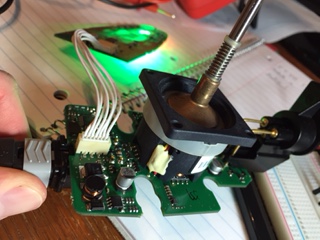

Thanks for the reply. That is certainly what I want to do, my issue is how exactly to do it. Specifically, where should I interface the Arduino with the joystick? The joystick controller uses CAN to communicate to the wheelchair, will that be a problem?
I've attached a picture of the joystick taken apart.

The joystick is a simple analogue device that produces a voltage swing.... the board converts that voltage into a CAN signal.
Measure the voltages of the white wires.

I'm ASSUMING that the white wires come from the Joystick ...your picture isn't clear enough for me to see.

Thanks woody! I did what you said and measured the voltages. They are all roughly 5V (4.69-4.98V) besides pin 4, which is labeled "SCK" which is approximately 0.2 V. What's odd though, is that none of the voltages change when I engage the joystick in any direction. Any clue on what my next step should be?

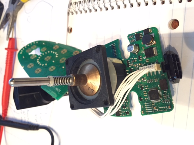

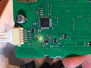

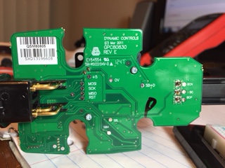

Postby jcka22 » 17 Feb 2015, 00:45
Here are some more pictures to try and help

From the last photo it's clear that the white wires are NOT coming from the joystick. You need to find the wires that go from the joystick pot to the board. I've never touched a Shark, and that pot is certainly different from the ones used in the DX Attendant Control Unit or larger DX remotes - it looks like a newer design. If, however, they followed the same basic scheme as in other Dynamic products each axis will have two outputs. BUT, they are not simply two wires connected together at either end. There are actually two independent outputs that track each other - if they ever fail to have close to identical outputs, the processor knows that something has failed in the joystick. If that's the case, your Arduino will have to also provide two outputs per axis (i.e. two digipot outputs per axis, or some way to split a single output into two isolated lines of the right impedance). In any case, the first thing you need to do is find those wires and measure the voltages on them.

They are usually mirrored on the old joysticks I have here. So when one goes plus, the other goes minus on each channel. And there is often a centre reference comparison voltage too. So it will be at 2.5v or close to it.

No, the DX joysticks have the tracking outputs in parallel rather than mirrored. In any case, the OP has to measure what his does.

But those white wires are nothing to do with joystick output directly - at least I wouldn't expect so.
It appears to be soldered directly to the board. Much messing about with a multimeters will be needed while powered up to figure out which ones do what. Not so easy to mess about with as a PG Drives system.

The DX-ACU has a plug & socket for the joystick connections, but the one on the Shark looks like it's soldered to the board. On top of that I suspect that it's not an analog output joystick at all. There are two wires on the side of the joystick that look like they are the + and gnd (and one seems to be labelled 5V on the board bottom), but the other connections seem to be under the edge of the pot and on the bottom are labelled MOSI, SCK, MISO, and RST which implies SPI rather than analog communications. To mimic this you'd need to use an oscilloscope to know the SCK frequency and what data packets are going across MOSI and MISO. The Arduino does have SPI built in, but there's a fair amount of reverse engineering (not as bad as for the CAN messages though) needed to figure out what's what. Actually, once you know the clock frequency, you could probably program an Arduino to print out the raw data then use that to program an Arduino to mimic the joystick output. Might also be necessary to unsolder the joystick and disconnect it to not have interfering signals from the emulator and the "real" stick.
