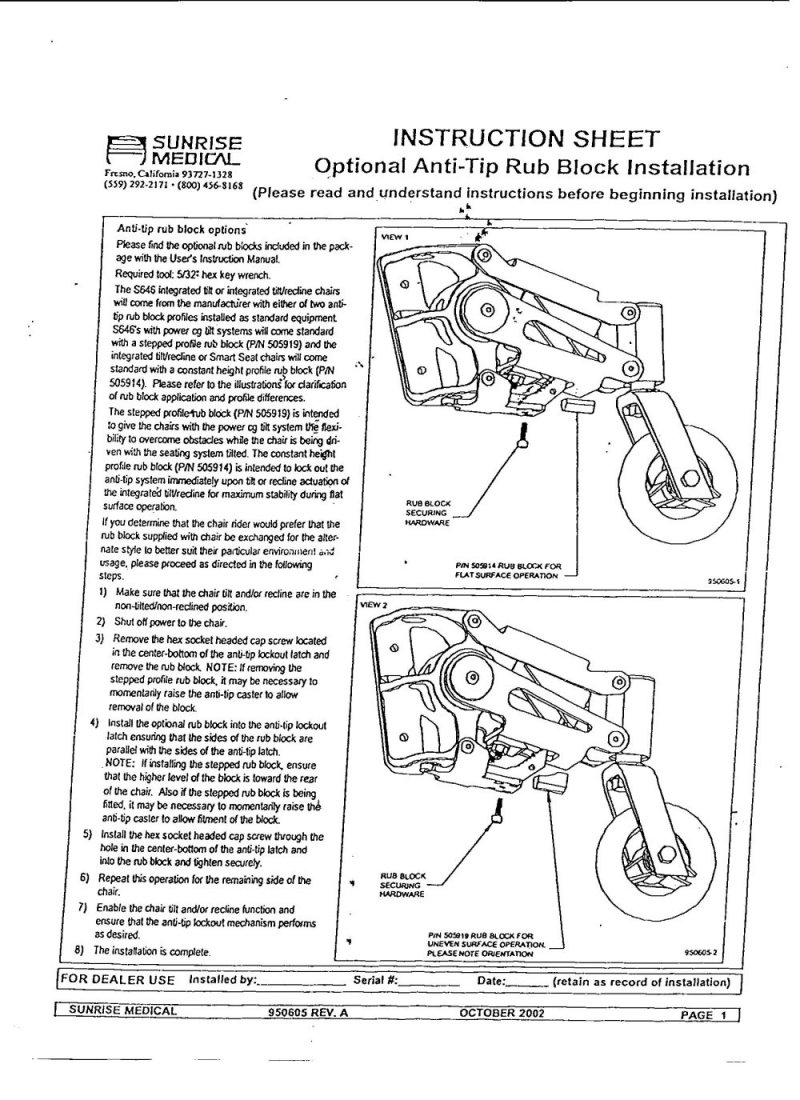

A follow-up on my original post in this thread. Among my papers that came with the wheelchair we found the attached document that explains the little blocks that go into the anti-tip mechanism. My chair had the flat blocks installed and we were provided with the wedge shaped blocks.
One strange behavior… When I first got the chair, the anti-tip wheels appeared to be locked in a downward position perhaps a half inch off the ground. They remained locked there regardless of tilt or recline angle of the seat. This was making it impossible to go up even a modest curb or ramp. We experimented with a rounded curb in front of my house and it would get stuck with the drive wheels coming off the ground and the chair resting on the front and rear casters.
For some strange reason and we don't know why… a few days later the anti-tip wheels unlocked. While they were spring-loaded you could easily reach down and pull one up with your hand. The chair could then easily go up or down a small curb perhaps with attendant assistance.
Anyway for the time being we're leaving everything alone. I don't know why the wheels were locked when they shouldn't have been. I don't know what spontaneously unlocked them. I don't know what the wedge-shaped blocks are supposed to do. At this point I've got bigger problems as you might see from other messages I posted here.
