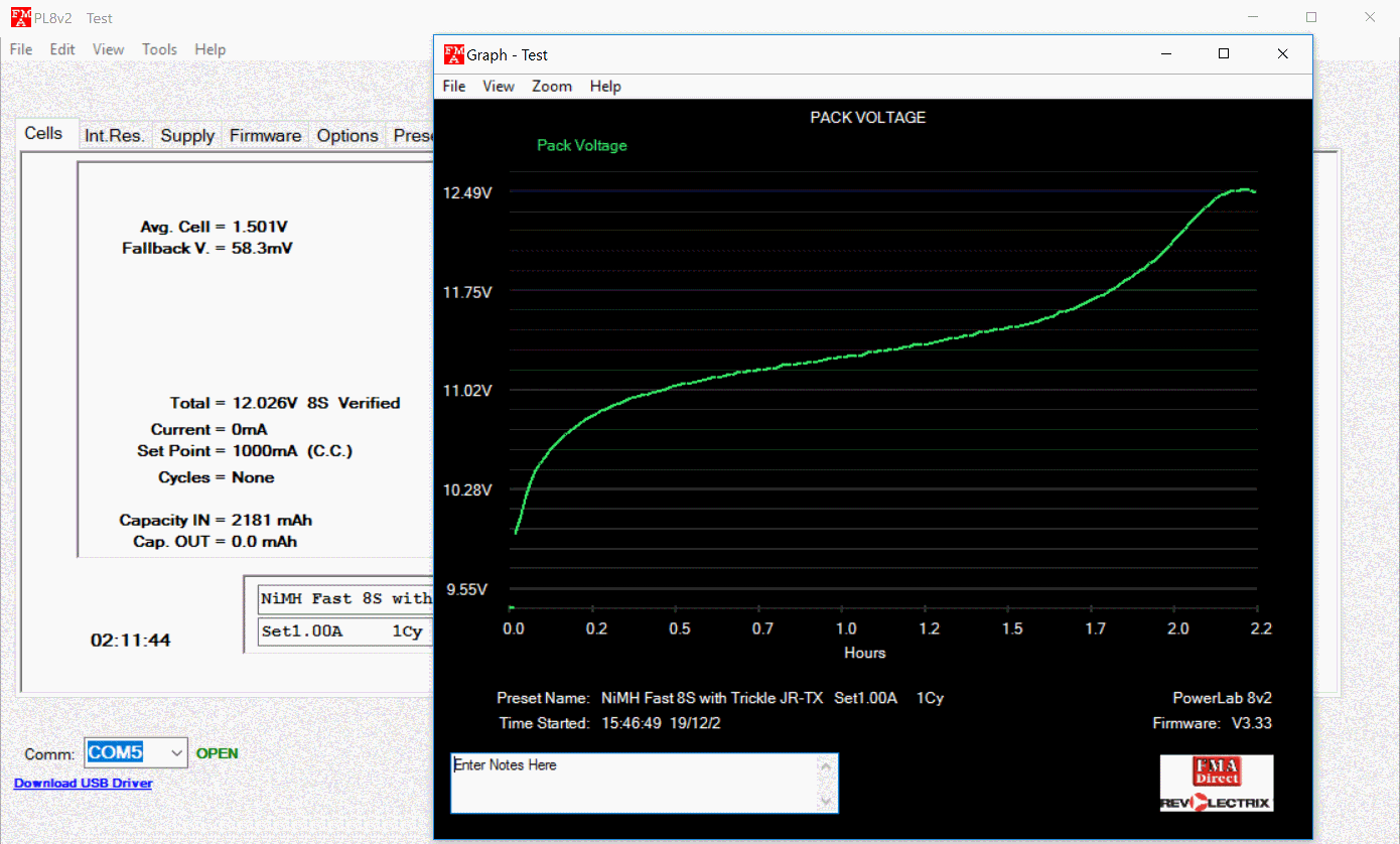

Postby Burgerman » 19 Dec 2016, 19:13
While I am in teaching mode!!!
Ni-Cad and Nickel Metal Hydride batteries, like the Eneloop AA and AAA cells, or the ones in older power tools, cameras, etc are different to lead and lithium in that when you charge them they have no correct voltages. So they are charged at Constant fixed Current only. So you feed them say 1000mA as here, below and watch what the volts do... These batteries are strange in that the voltage climbs as they charge, and while still charging at the same rate, it begins to fall again. The point where they are FULL is the top of the mountain... The highest point. So when voltage starts to fall you should stop the charge. The PL8 does this automatically.
You set what called the DELTA PEAK voltage drop. So I set it to 6mV per cell. Then as soon as voltage falls by 6mV X cell count, past the highest point (the peak) it cuts off the charge.
So dont even try to charge in parallel. And only in series, at about 1/3rd to 1/2 C or under 1A for a 2Ah battery.
Heres what that looks like on an 8S AA battery, in my RC transmitter.
