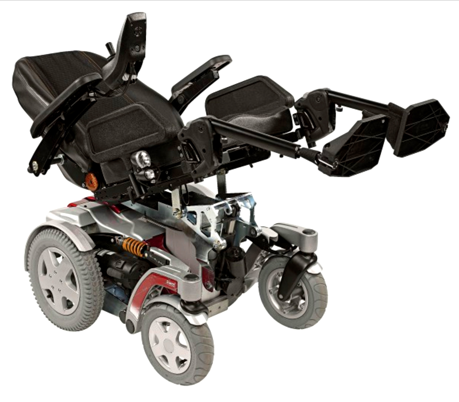

OK chair arrived.
First quick test as I am supposed to be on bed.
1. Arms and swing away, are unusable. Not rigid enough. Once programmed properly it would be undrivable like that. Can they be serious? So modification one is to seriously sort out the arm mountings, and the swing away.
2. Programming. As expected, can only be described as pissed. Cant hit a doorway, cant aim for a gap at speed because you would be praying and guessing. Bloody dangerous. I forgot how bad stock powerchair programming was!!!
3. Joystick too far to the right. Needs some re-configuring and imaginative spacing etc, to make it sit about 2 inches to the inside of the arm. As it is its uncomfortable.
4. They set the seat wide enough for 20 inches and the arms are about 2 feet apart! What are they thinking? Again should be easily fixed.
5. I ordered with shortened (cut off) push handles. They didnt do that. So hacksaw or wait for parts... So hacksaw!
6. Seat is about 5 inches too far forwards. Making it feel like an oil tanker. Its not technically adjustable. But nothing ever is. Have hacksaw and drill so it will be soon!
7. Single footplate mounts too high, too far forwards. Again. I can figure a way to sort that out. And the separate footplates are ugly. Will spray black... And mount them 10mm apart instead of 25mm as now.
8. Lights are positioned where they hit every door frame. Are they retarded? Will be moved to a sensible place.
All actuators are very very quiet and pretty fast. Esp seat lift as its about 12 to 13 seconds. Much faster than the supposedly super fast i-level or whatever prides new marketing thing claims as fast! And 8years older... Stupid tiny grey tyres look silly. And it moves silently. Even the brake makes very little noise. They must have changed something.
So once those things are dealt with it will be at least usable.
Then, lithium, wider wheels, tyres etc. And 114 miles range!

The swing away is unusable. Its elasticated. Thats going straight in the bin if I cant figure a way to fix it. Or ebay... Will fit a sunrise one or make a better one. How the hell do other people manage? They managed to make it complicated and ugly, stupidly expensive and completely useless all at once! Must have too ages to design all that in! Useless.
And its likely going to get 10 inch rims and 130 tyres. Those 3.00 x 8 look ridiculously small! And give inadequate ground clearance for my tie down.
And I don't like the footplates. Too big, should be black. And will be smaller and black soon!
In fact the whole seating and mounting seems too flexi to me. I see some serious fixing and rose joints in its future. And the backrest too... Its got backlash. Rose joints will fix that too. Now long term, it needs seat moving back about 4 inches, centre footrest mounting further back under seat. And smaller front caters and matching forks.

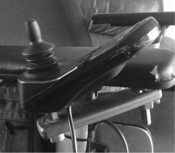

Postby greybeard » 07 Feb 2017, 15:53
The swing away that comes with the Puma 40 is the best designed one I've seen. Don't know if other brands use this design. Have never seen one advertised on eBay though - which might indicate they're as good as I think they are :D
I'll post a pic if I can find a way to reduce it to fit.

Postby greybeard » 07 Feb 2017, 16:12
Puma swing away. Attaches with a 2 hole plate to the underside of the armrest. Swing arc is from armrest to armrest with detentes at 160 180 & 200 degrees approx.
Re: New chair!
Postby Burgerman » 07 Feb 2017, 16:19
Not pretty but very functional.
I may make one its easy enough and 200 pounds cheaper!

Re: New chair!
Postby expresso » 07 Feb 2017, 17:06
http://www.1800wheelchair.com/product/s ... t-qtronix/
http://www.ebay.com/itm/Quickie-Swing-A ... SwjDZYisD8
ebay dosnt look so good - but all my chairs have those swingaways and i love them compared any other chairs - its simple and works - i believe the newer chairs - with new Rnet joysticks have a different swing away arm - if i am correct -
i dont like how it looks - they went from the best one in my opinion to one thats just like the rest and uglier -
Re: New chair!
Postby Burgerman » 07 Feb 2017, 19:13
THOSE are what I use on my BM1/2/3 chairs.
Rock solid if adjusted properly.
And likely whats going on this chair.
It cannot be that only sunrise medical got this right? If I was a huge organization like invacare I would get it right on day 2, about 15 years back. WHY are they not embarrassed? Can it be that no invacare chairs can be programmed and drive properly, yet nobody knows? :?
Gonna do a page on this chair. You can see it bouncing about here without the weight of a hand or uneven ground... https://www.youtube.com/watch?v=B-noeiMHMNw
Posts: 69918
