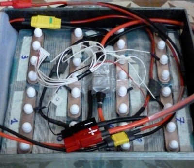

You don't need two 4S charge cables. A single 8S one just like you have now will work. Since both 4S packs will be connected in series. Having two single battery compartments doesn't change this.
My 24v 90ah pack is two 12v 90ah packs connected together by a wire with a breaker in between. Forget your top row for a second (and disregard the circled part in pic) - look at your pack here.
The only thing I did different than you, is on #4, I used two rows of two hole bus bars instead of a single row of 4 hole bus bars. I connect the two rows of two hole bus bars by a wire that connects the two - with a breaker in between. So imagine your pack is split into two 4S packs connected together in series by wire. Its the same thing.

Postby expresso » 03 Apr 2018, 00:12
the problem is getting them in the chair - the wiring would get in the way - since they will be two packs - one goin straigth and the one behind is sideways
theres a brace there also - it would be hard to hold them while fitting one and then the other - and then if i had to remove - same thing - they would be wired together making it harder to remove
having them in two parts - with the balance wires split also - means i can just unplug the wires - all of them - and then just lift one pack out with no worries
then the other pack slide back past the brace bar and out - its just to make it easier to handle install and removing etc,
i will have to use a Cable to connect the two also - instead of one of the buss connectors - i will use a Cable with SB50 connector to make sure they snap in good and tight - if i do this - i want to make sure its done right and no wires connectors coming loose -- this chair is like yours - have to take off the top half to get to the base - i want to do it once and thats it if i can
this chair already has a breaker - which i will leave since its wired into the chair wiring already - not on the batteries - i believe its 70A -
i would think its fine to leave it alone -

Re: Sinopoly Cells - Info -
Postby shirley_hkg » 03 Apr 2018, 03:21
AND has created a GUINNESS RECORD shortly after his battery installed .
viewtopic.php?f=2&t=1813&start=3160
snaker wrote:My maddest range: 83km/89.5 returned Ah. :clap
I think you've created a GUINNESS WORLD RECORD already .
Truely , 83km in less than 6 hours for a wheelchair is hard to break . hanged
Posts: 4657
Postby Burgerman » 03 Apr 2018, 03:55
would you use the same preset that was used for charging ONE headway 15ah cell ? and just up the charge rate ? since these are 100ah each -
can use 15 or 20A charge rate ? that would take about 4 hours easy if not fully drained - 24 hours for 8 Cells - then build it - test it - discharge - recharge and install - you would get it done in a few days -
Make a copy of your 90Ah chair profile. Rename to LiFePO4 1S 100Ah. Then just change the 8S to 1S in the first tab... And save.
Or use the single cell one and increase charge Amps, and set termination current to the same as your 90Ah pack.
Posts: 71101
