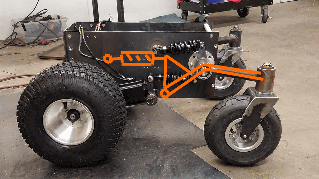

Postby Burgerman » 06 May 2019, 00:31
I still think that you would get a much better ride, and more predictable and controlled suspention if thosefront arms pivoted from the bottom of that box, inline with the rear suspension mounting point. As it is if it fits a bump its forces go straight into the pivot rather than in lifting the wheel against the spring load.
Rear, not symetrical, would reduce arc swing angles by 2. But wont look as pretty. Work better.
In orange...

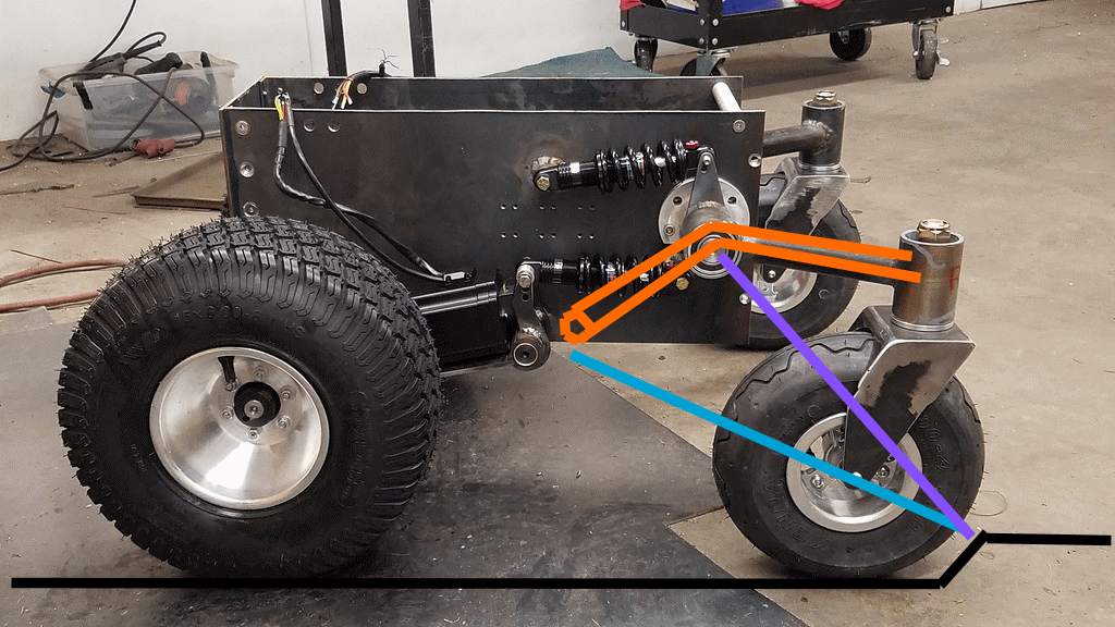

Side...
As it stands, when the wheel hits a bump, BLACK line = ground, the forces are transmited almost directly to the pivot point. So initially the shock loads the chairs chassis. And you will feel that. instead of letting the spring take the load. If a bump was large enough it it could actually cause the suspension to extend, and want to lift the chair UP.
Moving the pivot to the bottom, and making it longer (further from the wheel) means the load is mostly on the spring and the caster wants to move up instead of back. My rubbish drawing attempts to show forces. And where shock would go if it was me building.

Postby Burgerman » 06 May 2019, 00:59
Please dont shoot me!

In a perfect world they'd pivot from in front of the tire! If I hit something big enough to matter the rearward impact direction will not be my biggest problem :D
I'm out of real estate for much different. Two actuators still have to be fitted. One is big. The bolt holes between the shocks are for it. The bottom of the chair is above the caster axle centerline anyway. No way to completely eliminate it without affecting ground clearance.
Oh, my W2 chair weighed 264 American pounds. This one should be around 20 pounds lighter.

Postby Burgerman » 06 May 2019, 01:14
Just sayin. It would have a much smoother ride. Theres nothing wrong with leading link suspension. As long as it pivots from a low position. So that the bumps load the spring. But if you dont have the room, no choice anyway.

Burgerman wrote:Please dont shoot me!
Nope. Not at all. I completely agree and VERY much appreciate your input. I've designed enough to know, mostly three and four link drag car chassis. Bring on the criticism. If it can be changed, now is the time.
The rear - completely aesthetics. I drew it with longer links and just didn't like it. If it feels like it will need improvements when i test it I'll make a new back plate and links to try. Not very difficult. I originally designed it with a slide that attached near the gearbox that would take the place of the links. I figured it would pack with mud and stick.
